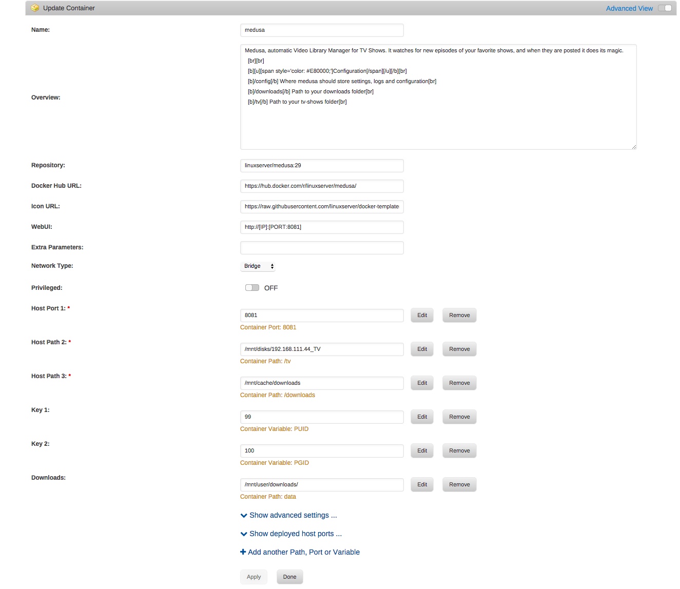

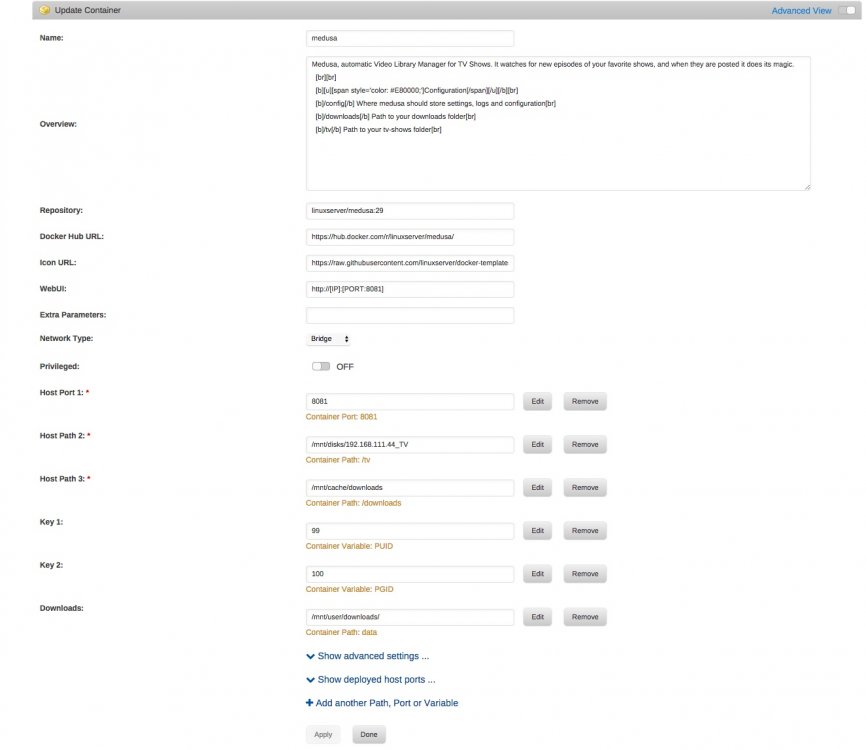

I tried updating Medusa tonight as it said there was an update, it failed and now my Medusa docker image is orphaned. I've tried downloading it and reinstalling it, but I keep getting an error:
root@localhost:# /usr/local/emhttp/plugins/dynamix.docker.manager/scripts/docker run -d --name="medusa" --net="bridge" -e TZ="America/New_York" -e HOST_OS="unRAID" -e "PUID"="99" -e "PGID"="100" -p 8081:8081/tcp -v "/mnt/disks/192.168.111.44_TV":"/tv":rw -v "/mnt/cache/downloads":"/downloads":rw -v "/mnt/user/downloads/":"data":rw -v "/mnt/user/appdata/medusa":"/config":rw linuxserver/medusa
/usr/bin/docker: Error response from daemon: Invalid bind mount spec "/mnt/user/downloads/:data:rw": Invalid volume destination path: 'data' mount path must be absolute..
See '/usr/bin/docker run --help'.
Attached is screenshot of my settings before I did an update back in June, I am using these same settings when I try to reinstall Medusa tonight however I am getting the error above.
The actual path to the folder where tv shows end up is :  /mnt/cache/downloads/completed
I have tried entering this instead of /mnt/user/downloads/ but I get the above error.
Why is Medusa broken and how can I fix it?
Medusa isn't broken, like the error says data isn't an absolute path. It should be /data
Thank you.
2 hours ago, ashman70 said:
Thank you.
Also you've got the image tagged at 29.  So it won't update
That was old, I don't have it set that way anymore.
