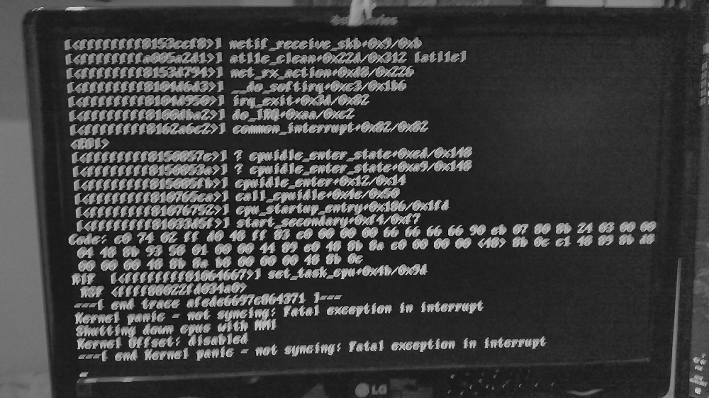

Ok so the logs dont say anything usefull but I managed to see a freeze in real time.
The server with a couple mins uptime, it booted normally (Plex Docker and Windows VM) and was doing a Parity check.
Out of no where my Ram usaged went to 100% for no reason and after 5 mins I got a Kernel Panic
I have part of the StackTrace in a photo if its usefull, any way to troubleshoot what is causing my server ram going from 30% to 100% in a second?
The end of the Kernel Panic is:
Kernel Panic - not syncing: Fatal Exception in interrupt
Thanks,
Ralms.
P.S.: I have 8GB ram and the memTest 1 pass without erros.
Thanks,
Ralms.
If it were I, I would post up that picture if the quality is such that it can be read.  Any clue is always a help in these cases...
Ok when I took the photo it seems fine, but actually is a bit shaky  :(
That is always the problem when you are looking at it on the camera/photo preview.  That camera shake is caused by the low light situation.  Next time, take a lot of pictures.  Try flash (but watch the flash reflection).  Take illuminating the monitor with room lighting.  Pick the best one and resize it down to approximately 1000x650 as you should be able to upload that size of picture directly to the forum.  (The difference between an amateur and a profession photographer is that the amateur takes one picture and hopes he has a masterpiece and the profession takes a thousand to get a masterpiece!)
And the professional will be using something other than a phone camera, with enough aperture to handle low-light, and possibly even a tripod and shutter remote. ;D
I tried to 'deshake' the photo with limited success.  Perhaps, someone can now look at it and see if they can figure out what was happening.
In the mean time, I would suggest that OP run a 24 hour memtst and see if that is clean.
