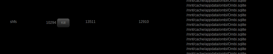

OMBI is keeping thousands of files open, which is leading to the system becoming unstable (running out of allowed open files limit). Is this expected behaviour, or can this be fixed somehow in the future?
I can provide logs if it is necessary.
Edited by MrChunky
I think I'm having the same issue. Causing Ombi to crash after a while.

Just took some screenshots of the openfiles plugin. 12000 files open :/ Gonna shut that down until its fixed.
Where are the ombi files located? In the appdata\ombi there are just the sqlite file, logs folder and backupSystem folder.
