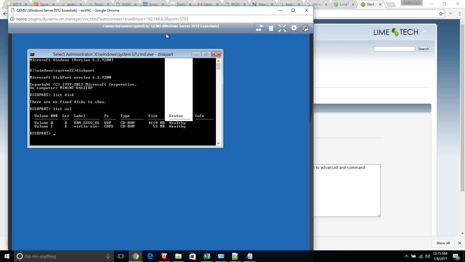

When I try to boot up the machine it boots off what appears to be the install image. It says I can refresh or reset the machine. I go to advanced and command prompt. Run disk partitioner, run list volume. The 2 volumes that show up are the virtio and the install disc. The 2 volumes are still defined in the VM template. Can anyone help me get these remounted to boot this thing up?

I apologize. I wasn't clear. This is an existing VM that I have lost access to. The v disks are still there. They just don't mount.

Post a screenshot of the VM template and also execute the below command on command line on the unraid server.
ls -al  /path/to/vdisk/folder
