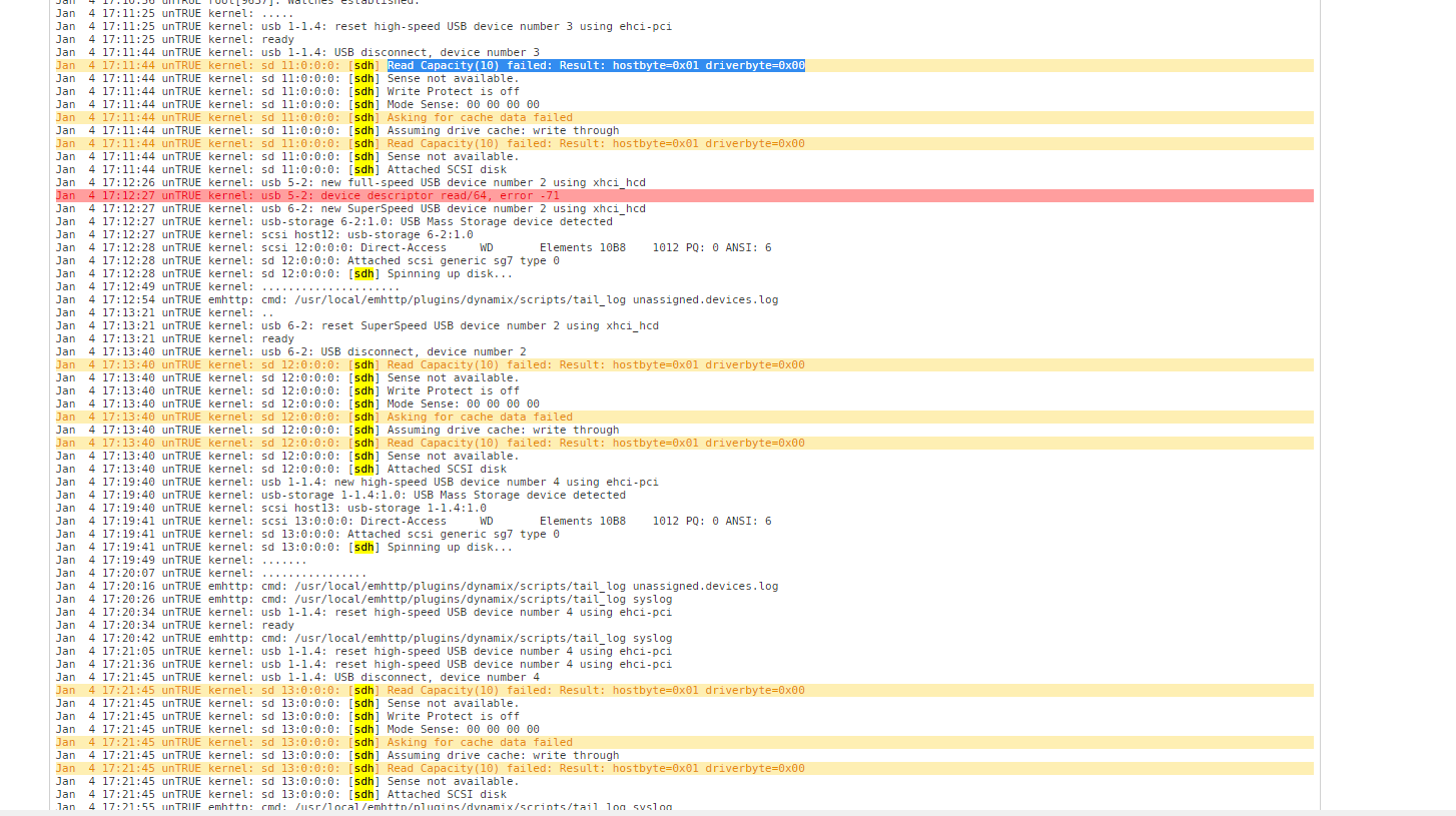

I get this error in the log when I plug it in
Read Capacity(10) failed: Result: hostbyte=0x01 driverbyte=0x00
Here's a guy fixing it by delaying the spin up?
https://bbs.archlinux.org/viewtopic.php?id=125831
Photo of log
Can I do the same thing in Unassigned Devices?
