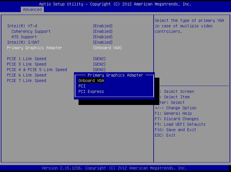

I have the same board. First thing I needed to do was set the built-in vga graphics as primary in the bios. If I didn't, I had similar issues...
I just checked, and the OnBoard VGA was already set to primary in the BIOS.
Do other settings in the mobo bios make much of a difference (aside from having all the VT-d features enabled)?

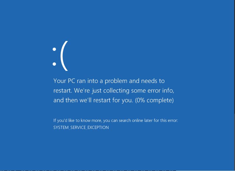

Played with VNC as the primary display and the GPU as the secondary.
On a fresh install of Win10, I see 2 display devices.
Once all the VirtIO drivers are installed, I install the nVidia drivers and restart the VM.
After the restart, I keep getting "Your PC ran into a problem" BSOD.
It doesn't work to use VNC and GPU pass through at the same time. It's one or the other.

Where does your unraid console show? On the onboard vga or your GPU?
vnc and gpu "works" with os x (I know, we're talking about win 10.) It will show the bios boot and the loader, then transfers over to gpu to load the operating system.
