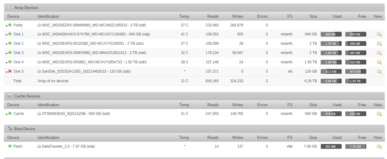

Added a new drive and now it has errors. Process or hardware problem?
I was using unraid 6.2.4 Pro with 4 data drives, 1 cache and 1 parity drive.
I was able to configure GPU passthrough for a Windows 10 VM with Steam games installed. Since this worked ok, I decided to get a dedicated SSD for that VM.
So I stopped my array and powered down the server.
My mobo (gigabyte ud3p 970) only has 6 Sata slots so I installed this PCIE Sata card I had laying around (http://www.nix.ru/autocatalog/controllers_Orient/Orient-S3132RAID-RTL-PCI-Ex1-SATA-II-300-2port-ext-2port-int-RAID_72173.html).
I installed the SSD (sandisk 120 GB ssd) and powered everything up.
I was pleasantly surprised to see that everything was recognized right away by Unraid.
I assigned the drive to the array and unraid did it's thing.
At this point there were no errors so, using SSH, told unraid to copy the VM vdisk to the new data disk. Everything went peachy.
Once this was done, I modified the VM XML to reflect the new location of the Vdisk and started the VM.
The VM started and ran for an unknown amount of time. When I checked the server before going to bed, there was a red arrow next to the new SSD and unraid had unmounted it.
Is there a problem with the way I installed the new drive? Is the raid card the issue?

Need the whole syslog (always!), the important part is before that.  The key thing I see is that the drive associated with ata2.00 has been dropped, and you need to know why, and what happened to it.  Could be a bad drive, but more likely an interface issue with it.  Please see Need help? Read me first!, and attach the diagnostics zip.
Sorry, I was gone for much of the day.  A few comments:
* I had hoped you would include the Diagnostics.  As of v6, we always want the diagnostics instead of the syslog alone, as it includes the syslog plus all SMART reports and a LOT of other useful diagnostic info.  I'll do what I can from the syslog.
* You have added a SATA controller card with SI3132 chipset, 2 SATA ports, which is fine for older drives, but because the SI3132 is now older technology, it's not a good fit for SSD's.  For one thing, it limits I/O speed to 100Mb/s, plus it knows nothing about SSD's or trimming.  I'd move the SSD to a motherboard port.  I can't say that this is the cause of the SSD being suddenly dropped, because there's no direct clue evident in the syslog, but it's possible.  I'd move only the very oldest drives to this card.
* You have added the SSD to the array.  I can't quickly point to the discussions about this, but as far as I know, it's not advisable currently, because a trim operation may possibly ruin parity.  Hopefully, someone else will point to the posts about this, or you can try searching.  On that SI3132 card, as far as I can tell, it did not recognize it as an SSD, which in itself is troubling.
* The SSD appeared to be OK initially, and you were able to issue spin downs and spin ups to it, but when you added it the array and started the array, it wrote an MBR fine, but then reported a 'Buffer I/O error' on the SSD, not a good sign, but there doesn't appear to be further harm from that.  It successfully cleared the drive, quite fast(!), then formatted it with XFS, then mounted it as Disk 5, with no apparent issues.  Later it was spun down (spinning down an SSD just means putting it in standby, a lower power condition).
* But here's the fatal part - about an hour and 10 minutes after spinning down, the kernel announces the drive is disabled!  As an ATA device, there should have been exceptions reported, and attempts to raise it, reset it, but there's nothing.  It's just a simple and sudden announcement that the drive is gone, with no explanation at all.  I've never seen that happen before!  You can ignore the subsequent read and write errors.  I have no explanation for the loss of the drive, but I do strongly recommend reconnecting it to a motherboard SATA port.
* You have IDE emulation turned on for 2 of your onboard SATA drives.  When you next boot, go into the BIOS settings and look for the SATA mode, and change it to a native SATA mode, preferably AHCI if available, anything but IDE emulation mode.  It should be slightly faster, and a little safer.  You have 2 drives (WD6400AAKS and WD15EARS) attached to the last 2 ports, but they are being treated as IDE drives.  Worse, as PATA drives, something is not being recognized correctly, so the kernel thinks they both are using old 40 wire IDE cables, and therefore slowed their top speed down to 33Mb/s!  You of course don't have 40 wire IDE cables, but because it's configured to think they are IDE drives, it's confused.  Make sure you change that BIOS setting!
Thanks for the detailed response Rob. I've attached the rest of the diagnostics.
So say I want to remove the disk from the array and also move it to one of the ports on my motherboard (and thus switching another drive to the S3132). What is the most appropriate way of doing this?
Close the array, unassign disk 5, powerdown, do the port switch, start the array again?
So you say SSD should not be part of the array, can I leave it unassigned and still access it normally?

There is definitely something wrong going on.
I have switched the SSD for another drive (Disk 3) on the Sata card but now it is throwing millions of errors while building parity.
Does that mean that the Sata card is toast?
If yes, any suggestions for a suitable replacement?
tower-diagnostics-20170107-1500.zip
Same thing happened again, now with that disk, it got disabled without an apparent reason.
I would replace that controller.

Jan 11 20:53:17 Tower kernel: XFS (sdh1): metadata I/O error: block 0x6fcc02c ("xlog_iodone") error 5 numblks 64
Jan 11 20:53:17 Tower kernel: XFS (sdh1): xfs_do_force_shutdown(0x2) called from line 1197 of file fs/xfs/xfs_log.c.  Return address = 0xffffffff8128bb59
Jan 11 20:53:17 Tower kernel: XFS (sdh1): Log I/O Error Detected.  Shutting down filesystem
Jan 11 20:53:17 Tower kernel: XFS (sdh1): Please umount the filesystem and rectify the problem(s)
Jan 11 20:53:17 Tower kernel: XFS (sdh1): xfs_log_force: error -5 returned.
You need to check file system on the Sandisk SSD which I'm guessing is an unassigned device, unmount it and on the console run:
xfs_repair -v /dev/sdh1
Hmmm... When I try the above, it say
/dev/sdh1: No such file or directory
fatal error -- couldn't initialize XFS library
Reboot, check that the disk is still sdh and try again.
It had changed name to SDI.
But now it says:
found candidate secondary superblock...
unable to verify superblock, continuing...
Sorry, could not find valid secondary superblock
Exiting now.
Can I just reformat it?
You can if there's no important data there, but make sure you didn't just forget the 1 at the end:
xfs_repair -v /dev/sdi1
Sorry, this is all black magic to me... Here is what it says with the missing digit:
Phase 1 - find and verify superblock...
        - block cache size set to 1529832 entries
Phase 2 - using internal log
        - zero log...
zero_log: head block 6724 tail block 6720
ERROR: The filesystem has valuable metadata changes in a log which needs to
be replayed.  Mount the filesystem to replay the log, and unmount it before
re-running xfs_repair.  If you are unable to mount the filesystem, then use
the -L option to destroy the log and attempt a repair.
Note that destroying the log may cause corruption -- please attempt a mount
of the filesystem before doing this.
