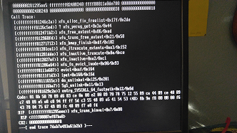

Some output on console:
__write_cache_pages+0x249/0x353  and so on
wb_workfn
kthread
generic_writepages and bunch more similar
then the flashing cursor
I've attached logs after I hard rebooted.

I have monitor and keyboard plugged in, and I can see the console output when it locks up, as per previous post the console output has this
wb_workfn
kthread
So, not sure how I'm going to get the logs, does unRAID have other terminals? tty1 tty2 etc? As I said earlier the console is unresponsive.

Things have got a little worse, I rebooted to do  another parity check, everything comes up fine, webgui and the such like, I then hit the 'Start array and do parity check' and the webgui seems to be in an endless refresh state, bottom left corner of gui says 'Mounting disks...'
I can still SSH in and the console is fine, just before the console login prompt comes up there is  bunch of stuff along the lines of XFS, which I don't think I've ssen before, I've attached some screenshots.
Do I need to let the parity check complete before running a file system repair? Assuming I can get the parity check to even work now, I'm sort of stuck.
When I hit Start array and check parity the console output shows a bunch of stuff but this one might be a clue
:sh line1: 8019 killed mount -t xfs -o noatime,nodiratime /dev/md2 /mnt/disk2 2>&1
8020 Done : logger
This is  the disk the torrent was writing too.
