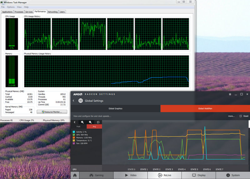

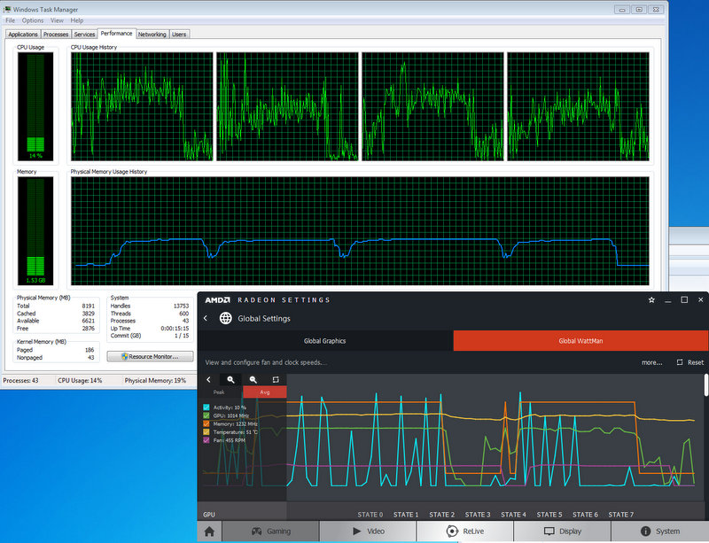

I decided to do a more direct performance comparison by running the same game with the same settings/map, and taking a screenshot of resource usage graphs after a short session.
The game was Killing Floor 2 on High graphics settings, with Vsync and variable framerate.
When in the VM, my framerate seemed to peak at 30 fps, with dips to around 20 fps when a lot of effects were rendered.
When native, my framerate stayed steady at 60 fps, and I was only able to get it to dip to 55 fps for a fraction of a second.
When I compared the resource usage graphs, I noticed that although I had thought my GPU usage was low on the VM, it was actually higher if anything. In addition, it looks like CPU usage was possibly higher on the VM, although more balanced between cores.
I will try to attach the pictures in a following post, although I am having trouble with that feature of the forum.
Attaching screenshot of performance graphs after my test in native Windows 7
Attaching screenshot of performance graphs after my test in a VM of Windows 7
