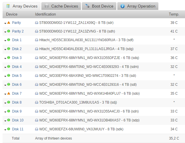

I am running with 13 drives in Supermicro 5in3 cases with silent noctua fans.
I have been running a parity sync AND a data drive rebuild at the same time for 12 hours now. Temps are below 35 degrees with a few drives at 37 degrees.. These are allmost all WD RED's.
The two parity drives are 39 and 40 degrees, but these are Seagate desktop drives with higher speed.
My ambient temperature is 21 degrees.
So it can be lower.. But I would not worry..
