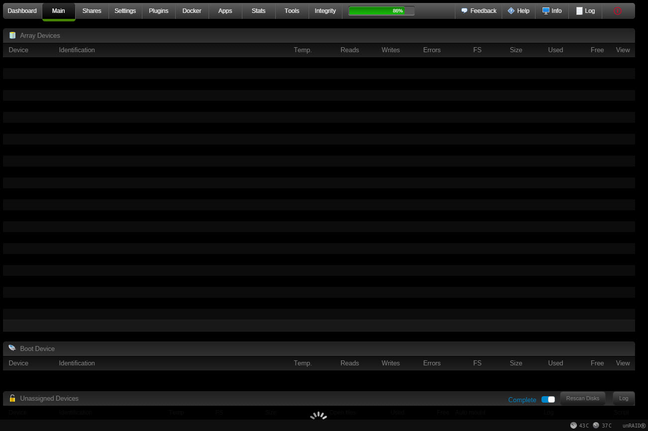

Hi all.
Suddenly, the following items have stopped working:
- drive statistics in dashboard
- system status in dashboard
- array devices in main page
- array operation in main page (in fact, all data that should populate in the main page)
- confirmations of any options that are changed.  They take, but I need to refresh the GUI.
- all disk and system stats blank
Shares are ok and all disks/shares are accessible.  Dockers working.
I can't pull a diagnostics either.  The save file requester never pops up.
I have at least copied a syslog pulled from the viewer.
It is almost like the subsystem is getting hung up on some kind of data fetch in the background and blocking any lists from populating.
I even went back to a backup of my entire flash config from yesterday and a few days ago...same thing.
Assuming even a drive is wonky somehow, why wouldn't the data at least show?
Thinking it was perhaps a plugin that is misbehaving, I uninstalled a few that updated in the last day or so...nothing either.
Kev.

Have you recently installed an adblocker on your browser?  White list the server if you have.
Clear the browser cache.
Try a different browser
Hi Squid...
You jogged something with your comment.  I tried all the browsers with adblocks on/off on my PC...same thing.
Tried from my cell phone and the data appeared.
A big of digging revealed a proxy that somehow turned on in my PC.  Must have come on as part of a spyware/malware scan thing that I have.  Disabled it and it is fine again...:-)
Thx!
