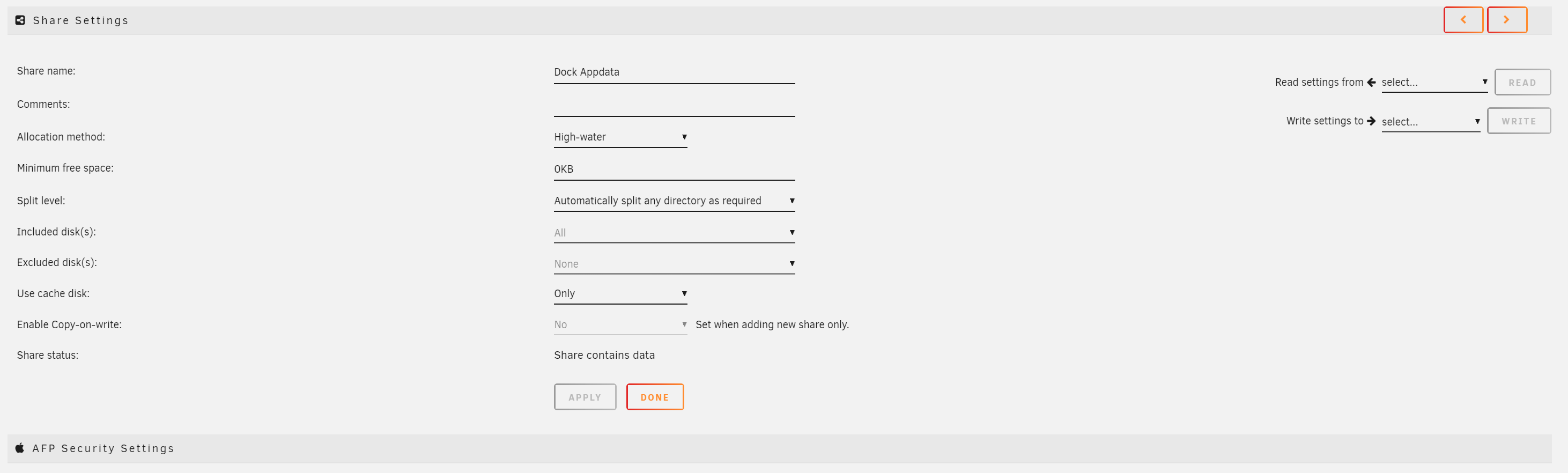

I have an issue where everytime Medusa docker upgrades I lose my entire config. I have backed it up now but its getting pretty annoying and takes away from the automated side of things.
Any ideas? I have tried re-installing docker from clean but still happens.
this certainly should not be happening, i run this container myself, ok lets see where /config is located:-
open unraid web ui, click on docker tab, left click medusa and select edit, scroll down and click on the link "show more settings" this should then display the path to /config, can you paste that path here, i suspect that you have this defined on a share that is not set to cache-only and thus the mover is moving your config files to the array resulting in complete loss of config, that would be my first guess at least.
it might be useful to also screenshot your "shares" as shown in the unraid ui.
Hi binhex,
Here is the path from /config = /mnt/user/Dock Appdata/binhex-medusa
Here is screenshot of that DockerAppData share
32 minutes ago, witalit said:
Hi binhex,
it could well be the space in the share name, im not too sure whether unraid web ui for docker supports shares with spaces, you could try wrapping the path with double quotes, or better still change the share name so its doesnt have a space e.g. 'Dock-Appdata', obviously if you do change the share name then you will need to reconfigure each docker container to point at the new share name.
Cool I have removed the space and renamed the share to DockAppdata and updated all docker containers. Lets see how that goes :-).. thanks mate.
