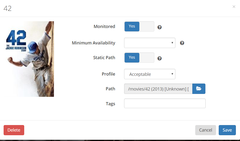

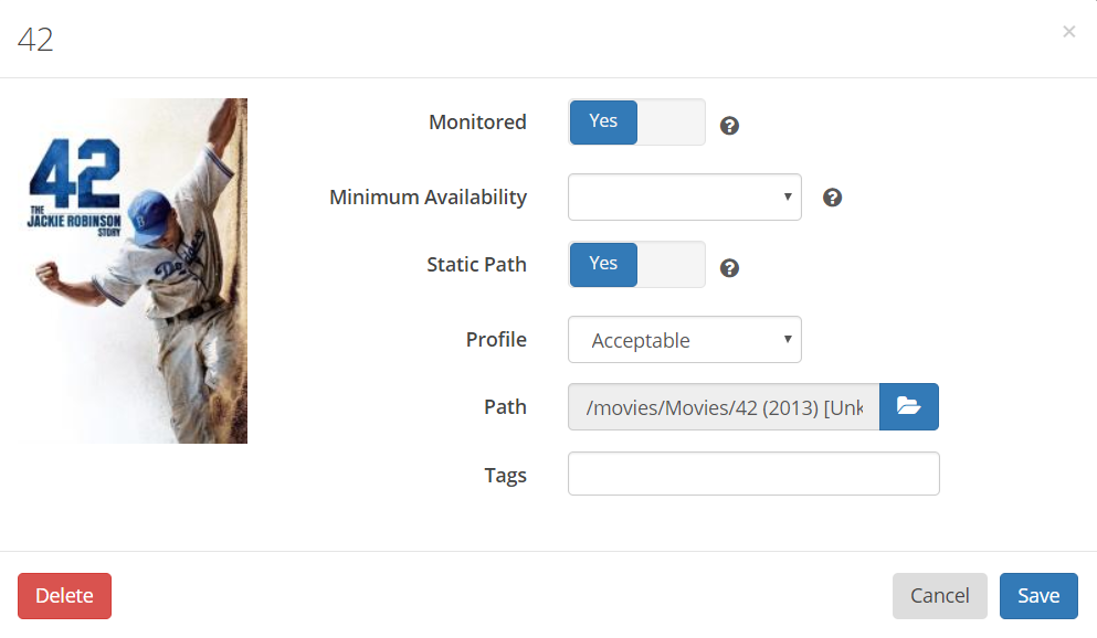

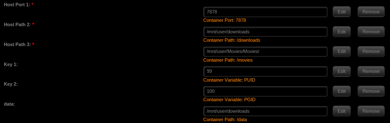

After struggling getting the mappings right for Radarr, Sab and Deluge I'm having an issue that I can't figure out.  When I add a new movie, radarr uses my old mappings.  I've changed the mapping in the radarr setup and then changed them back, but It's still going back to the old mappings.  Radarr is now seeing those as missing and downloading new movies.  Is there something I can do to change the mappings back without going through all 888 movies and remap them?  The logs show root folder doesn't exist.  I've disabled radarr until I can find a solution, thanks.
Movies' root folder (/movies/Movies) doesn't exist.

/movies/Movies and /Movies/Movies aren't the same thing

I understand that. I don't understand why radarr has the root folder as /movies/Movies, when I have the path set up in unraid as just /movies

that path is probably referenced in your config somewhere.  go into your appdata folder for radarr and grep -ir for that path.

The container path is /movies.  This is mapped to /mnt/user/Movies/Movies
You've told at some point radarr to put the movies into /movies/Movies.  Net result is that its trying to store files in /mnt/user/Movies/Movies/Movies
Your simple solution is to try changing your path mapping from /mnt/user/Movies/Movies to /mnt/user/Movies
