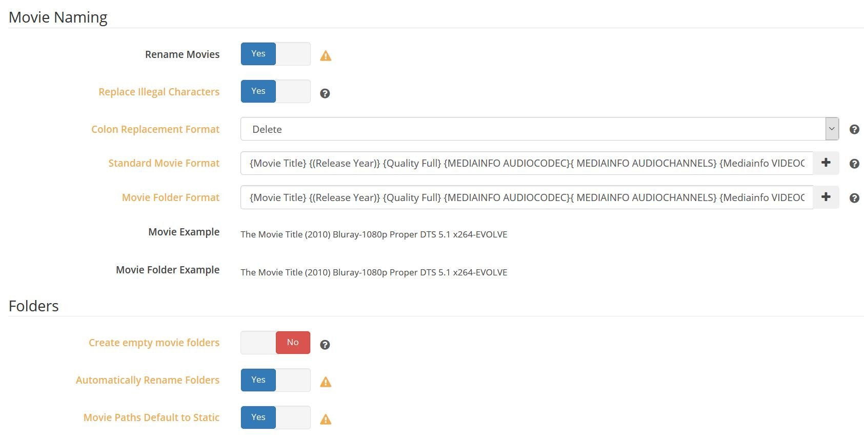

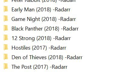

Hi all,
I can't get Radarr to rename my movie folders to the format I have specified in the settings. Not sure if it is a settings thing or maybe a permission problem with the docker?
I've attached pics of my Radarr settings and how the folders actually get renamed.
The video files themselves rename correctly.
Any ideas what I am doing wrong?

On 5/20/2018 at 6:14 PM, nas_nerd said:
Hi all,
Anyone?

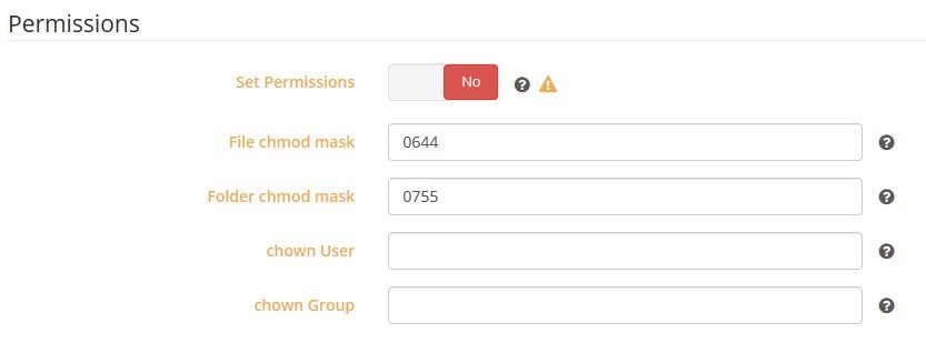

Do most people set permissions using this setting in Radarr?
22 hours ago, nas_nerd said:
Anyone?
I dont have permissions set on mine, post up a log for one of the other guys to look at. What is radarr doing if its not renaming them how you want ?

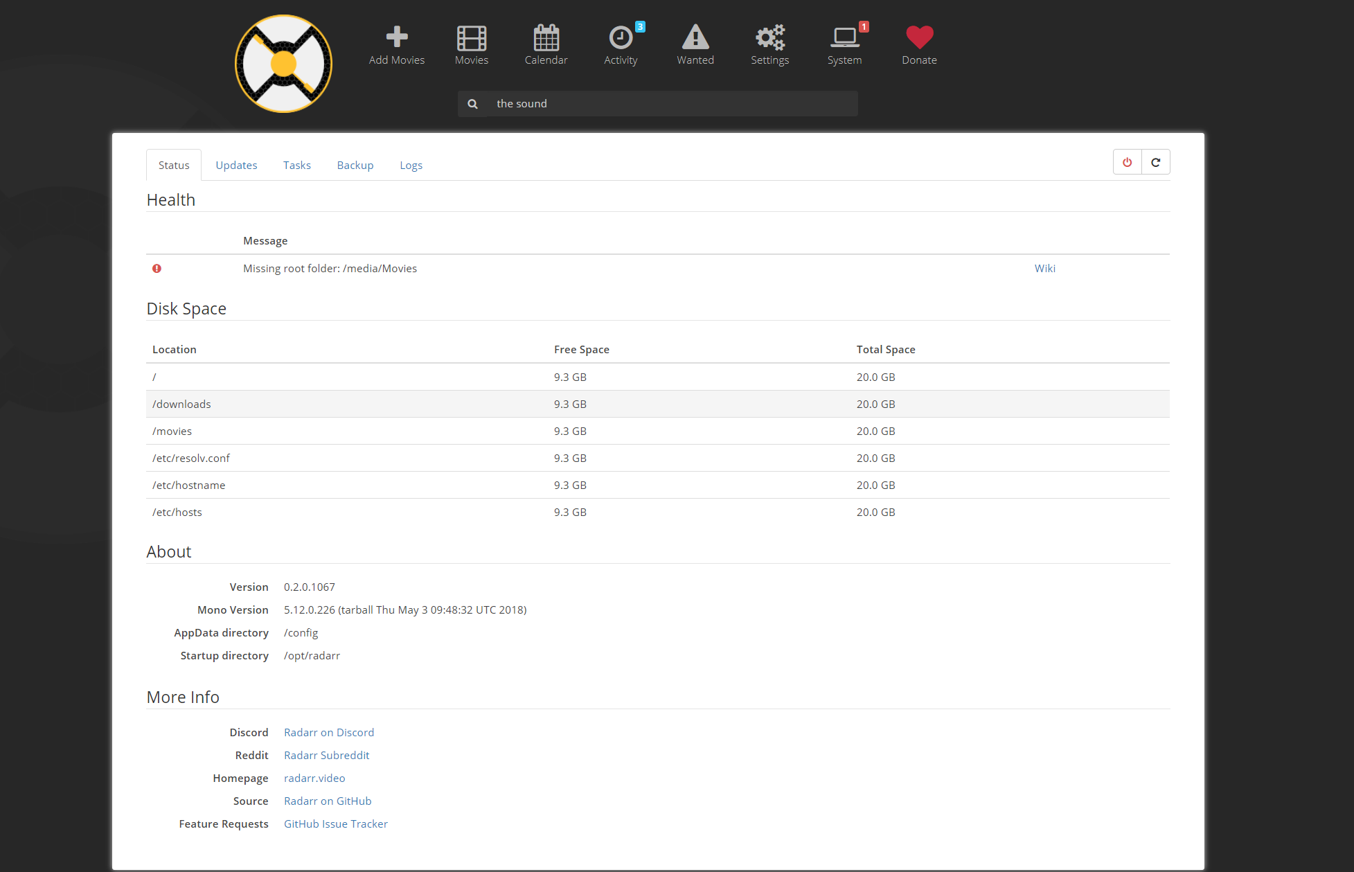

I have radarr working great, it renames and places movie "backups" into my movie folder. it renames and does what i want.
however, i have this error in the image attached, the only way to remove the error is change the path in the docker config and change the dir in the ADD MOVIE section, but then it wont rename and move the movie correctly.
is there still something wrong, or can i remove this error report?

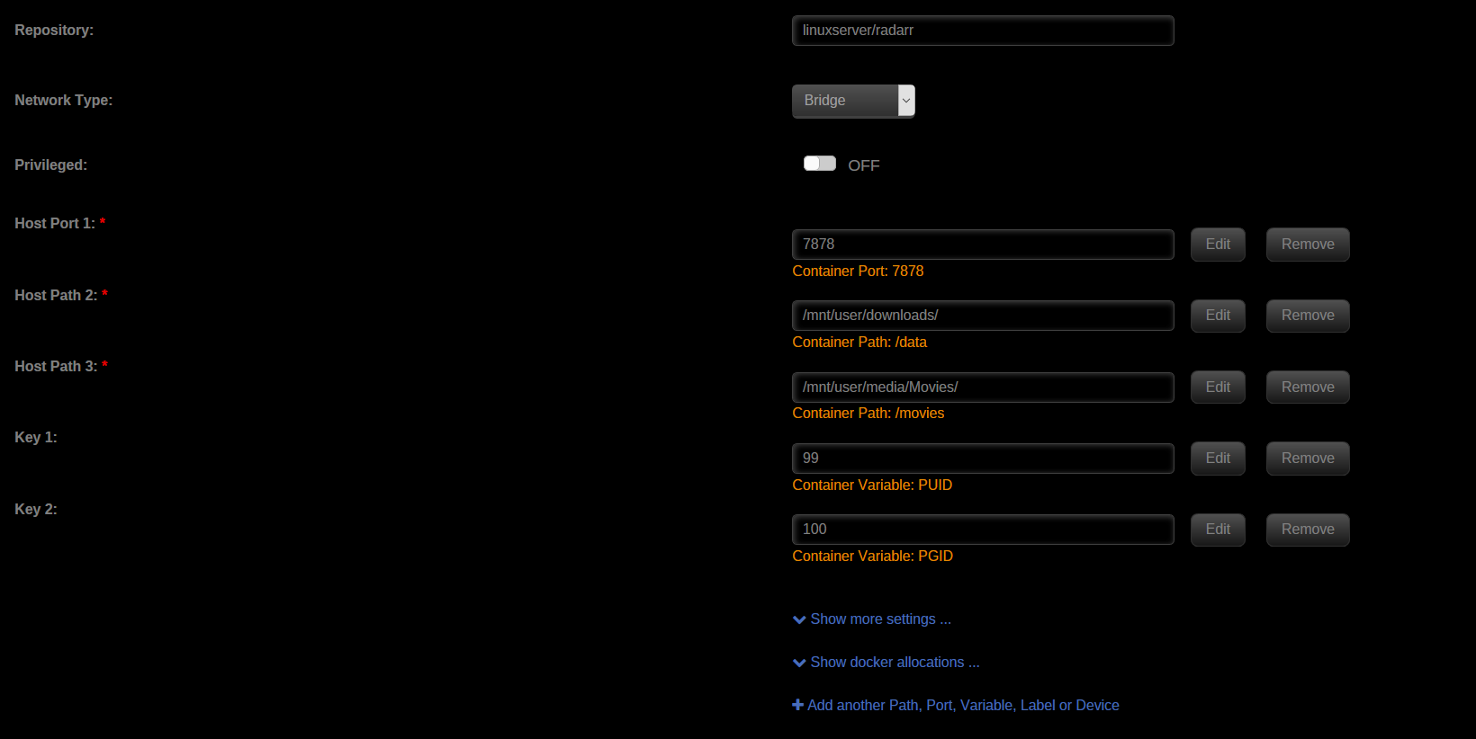

I'm really new to all this, but I've set up the docker, but appear to have a weird quirk.
/downloads is mapped to my /downloads share, which i have a deluge docker also moving things to. /movies is mapped to /media/movies share. Now, in my prior workflow, deluge moved completed downloads to /media/movies. However, I stopped that behavior assuming that Radarr would take care of that- instead, Radar tells me 'cannot find file to import.'.
If invoke the transfer in deluge, moving the completed file to /media/movies, then Radarr finds it- but also immediately copies out the movie file to a new folder and file in it's prefered naming structure. This is despite the fact i have turned off rename and copy, have it set to use hard links..
What am i missing here? is there a way to tell it to look for the completed file in /downloads instead of /movies which is where it's apparently looking? a way to disable the copying feature? I get the feeling i'm just missing something stupidly obvious but even with advanved settings being shown i don't see anything that appears to relate to 'search X folder', and i already have the copy/rename feature off yet it still does so..
Thanks, That felt.. really obvious in retrospect. Missed that within deluge the path is /data not /downloads.
