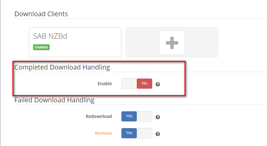

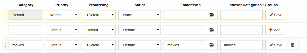

How does one stop all post processing in RADARR.  After SAB downloads files I don't want RADARR to do any post processing of files?
Don't give radar the correct category in the download client setting. It cant process if it doesn't know where the files are
ok I found it.  After I changed it from yes to no.  It works as wanted.

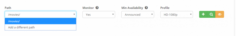

I've got a problem,
I recently changed my download paths, as my original setup was flawed ( It just kind of worked so I didn't bother to fix it)
So I was trying to have a proper folder structure, and here is my hosts paths:
Radarr:
/mnt/user/downloads/ - > /data
/mnt/user/Media/Movies/ -> /movies (old path was /data/download/complete, and movies ended up in /data/download/complete/movies)
sabnzbd
/mnt/user/downloads/ - >/data
Rootpath in Radarr was also set as /data/download/complete/movies. So I deleted my whole library, went to "bulk import movies" and deleted the old root path. I set the root path as /movies.
Then I have bulk imported all my movies back, and they do go to /movies as they should.
But when ever something is added, it goes to /movies/movies and I get this error message:
Missing root folder: /movies/Movies
I can't find anywhere in the settings that I am pointing to the directory /Movies/movies.
Add a movie, any movie.  In the file browser that appears, under the most recent stuff, you'll see /movies/Movies with an "x" next to it.  Hit the X.  That path that you used to use no longer exists, hence the error

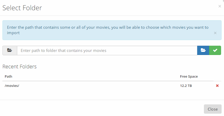

Thanks for a quick reply
I checked your advice, but not sure if it helps me, see below:
Here is when I try to add "any movie"
Here is when I go to "Bulk Import Movies":
Nowhere is /movies/movies to be found
Should I be looking in some other settings?

Here is my catagories in sabnzdb:
When downloaded, sabnzdb unrars the movie from /data/incomplete to /data/complete/movies
From there radarr moves the file to /media
Like I said earlier, when manually added, there is no problem

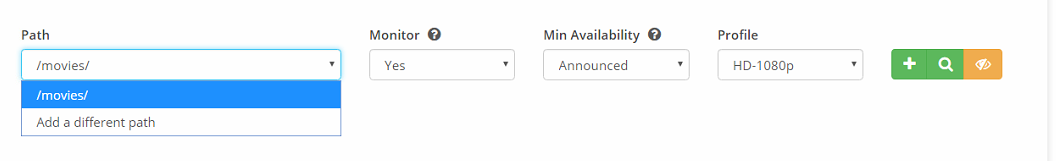

I fixed the problem regarding:
"Import failed, path does not exist or is not accessible by Radarr: /data/complete/movies/ xxxxxxxxxxxxxxx"
It was previous downloads via sabnzdb somehow telling radarr to check on them (or something)
What I did was delete/purge nzb files from SABnzdb and then this error log stopped
The /movie/movie error seems to be gone, hopefully it doesn't start over again
