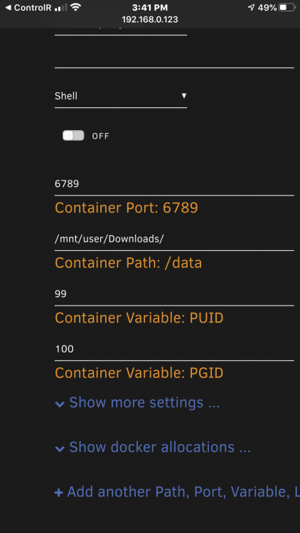

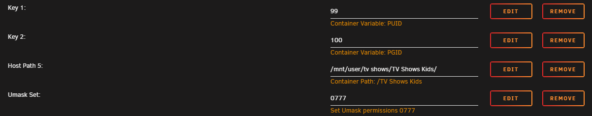

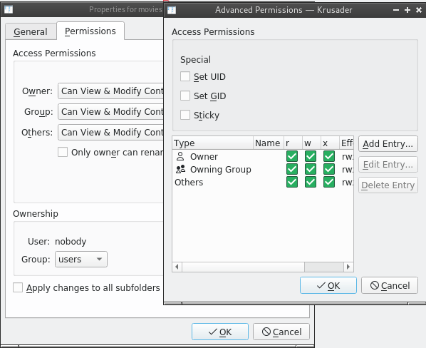

Hi All

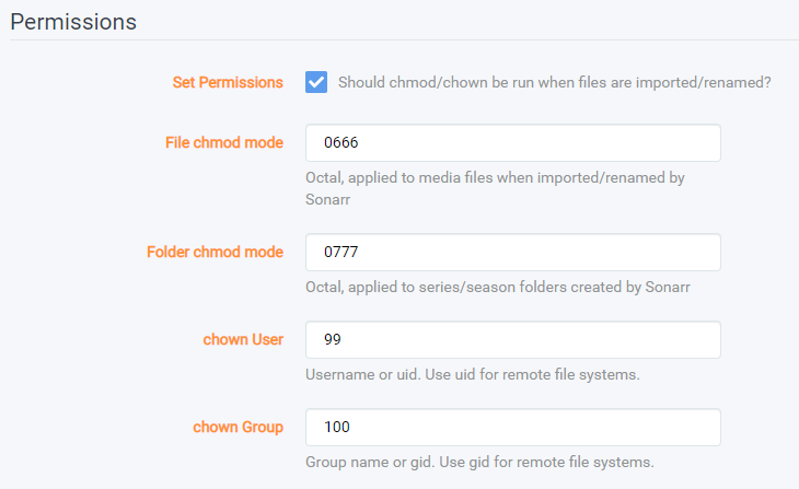

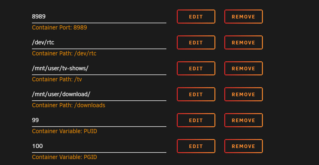

I keep having access problems caused by file permissions I have the following in Radarr
And in the docker settings:
My only option is to keep running "New permissions" under Tools
Strange thing is that its mostly .srt files that cant be read by the player before updating permissions?
Edited by casperse

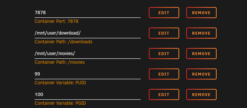

Hi All
Sofar everything works when I set it up externally server, but I am trying to move it to my local Unraid server
Also read many posts about the advantages of having a separate UAT drive so I also did this
Keeping the array from spinning up every time you download files and moving them later
Mapping is always what is causing everyone problems or its access rights! :-)
And this is probably also the case here I just can't put my finger on where I screwed up!
Deluge mappings: (Unassigned disk)
Radarr:
Same path!
Deluge moves them correctly from .incomplete to movies:
Radarr also shows the correct path in the UI:
But in the log files in Radarr it says:
Import failed, path does not exist or is not accessible by Radarr: /data/movies/George. Ensure the path exists and the user running Radarr has the correct permissions to access this file/folder
Then looking at the permissions I can't see anything wrong:
Summery:
Deluge /data --> /mnt/disks/SEED/downloads/
Radarr /downloads -> /mnt/disks/SEED/downloads/
Deluge moves files from .incomplete --> movies
/mnt/disks/SEED/downloads/.incomplete
/mnt/disks/SEED/downloads/movies
Radarr moving files to array.... not working
That should work - shouldn't it?
It's driving me nuts... I have tried so many options and using sublevel folders and not a root folder of a UA - drive nothing works
Last option is to use the Path mappings! but I am running everything local so shouldnt be needed should it?
(localhost doesn't work? I am using IP for the download clients)
As always new eyes on the problem and inputs are most welcome!
37 minutes ago, Squid said:
Deluge / Radarr has the container paths don't match.  Change Radarr's container path of /downloads -> /mnt/disks/SEED/downloads to be /data -> /mnt/disks/SEED/downloads
Deluge is telling Radarr the movie is in /data/movies/....  But Radarr doesn't have a /data hence the message
https://forums.unraid.net/topic/57181-docker-faq/?tab=comments#comment-566086
Argh I need to stop thinking that these "default" docker inputs are mandatory - everything is configurable!
Thanks!

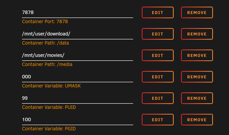

Hi, I cant seem to get the WebUI to load, ive tried reinstalling it in different paths multiple times, I even tried on another server and it does the same thing.

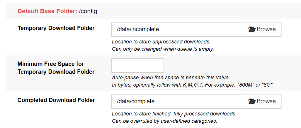

Hi guys -
    Was wondering if I could get some assistance.   I've installed the Binhex version of Radarr/Sonarr, however I would like to get get Linuxserver.io dockers going, but keep running into a pathing issue that is frustrating me beyond belief.
I've got the  following:
SABNZBD:
Linuxserver - RADARR V3
Linuxserver  - SONARR V3
Binhex - RADARR
I'm not 100% sure how to reconfigure the Linuxserver's dockers to access the download area that SABNZBD is dumping things into.
I would appreciate any guidance!
On 5/3/2020 at 12:17 PM, Pope Viper said:
So on Linuserver Radarr, change the container path to /data?
HI guys , thought I would follow up on this.
Thanks!
