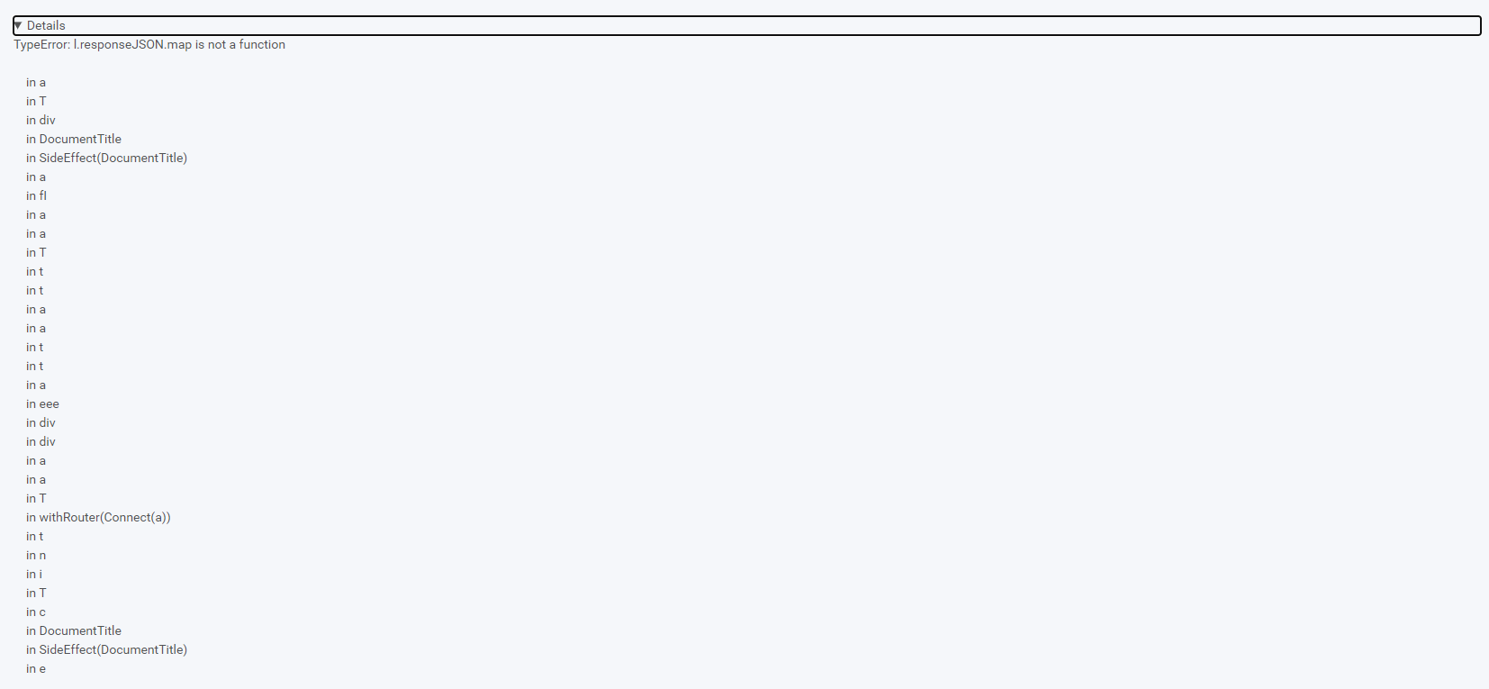

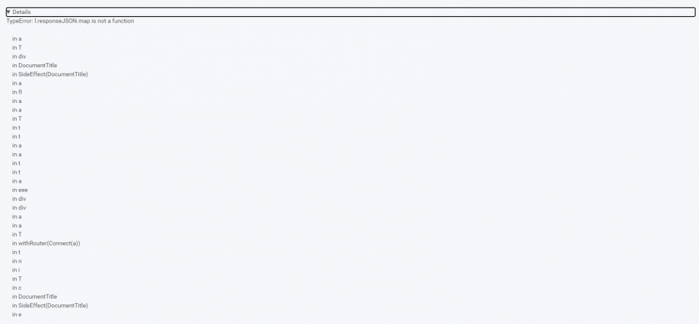

Trying to import my library and it keeps timing out with some sort of error. It is taking me about 6 try's to get anything done.  Any ideas?

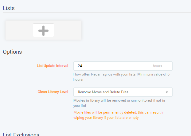

I recently had Radarr delete all my movies. I created a post in general support.
To summarise, I thought I would try monitor a 'collection' and it seemed that Radarr decided to delete everything that wasnt in this list.
I've never used lists before, and have been running radar for years. Turns out, there is this setting that I'm sure I didnt enable.
Is it remotely possible this gets enabled by default if monitoring a collection through the normal search page

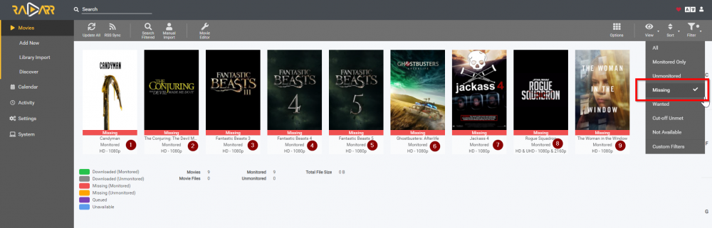

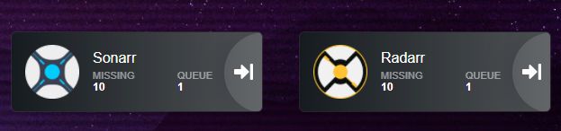

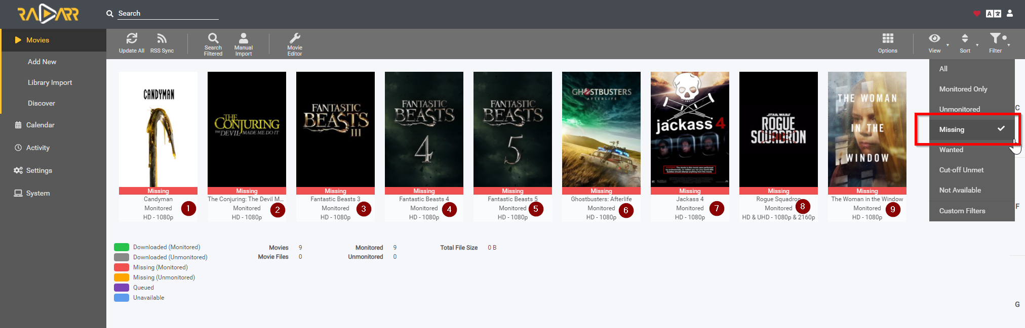

X-posted this to Heimdall since that's where the "1 queue" shows up at but...
Having an odd issue where Radarr is being reported as having 1 item in the queue, however my queue in Radarr is empty and all missing movies are currently unrelased still.
This has been going on for a few days now, can't figure out what is still stuck in the queue anywhere?
Screenshots below.
Thanks in advance!
Screenshots below.
Thanks in advance
Heimdall issue, not radarr. Did you try reloading the page or restarting heimdall?
Edited by dbinott
Yep, I've tried both restarting radarr and heimdall too, and clearing cache and reloading - still shows the same thing after I did that a few days back.
Since it stayed for a few days I figured I'd post here.
What's interesting is only NINE missing movies show up, but the heimdall page shows 10 missing with 1 in queue.
Interestingly enough though without doing any of this restarting/incognito, etc, and just refreshing the page now today, it's showing 10 missing with ZERO in queue now.
So the queue is correct but the missing count is still wrong.
Am I missing something about the correct way to filter to "missing" in this new version of Radarr? Thanks in advance!

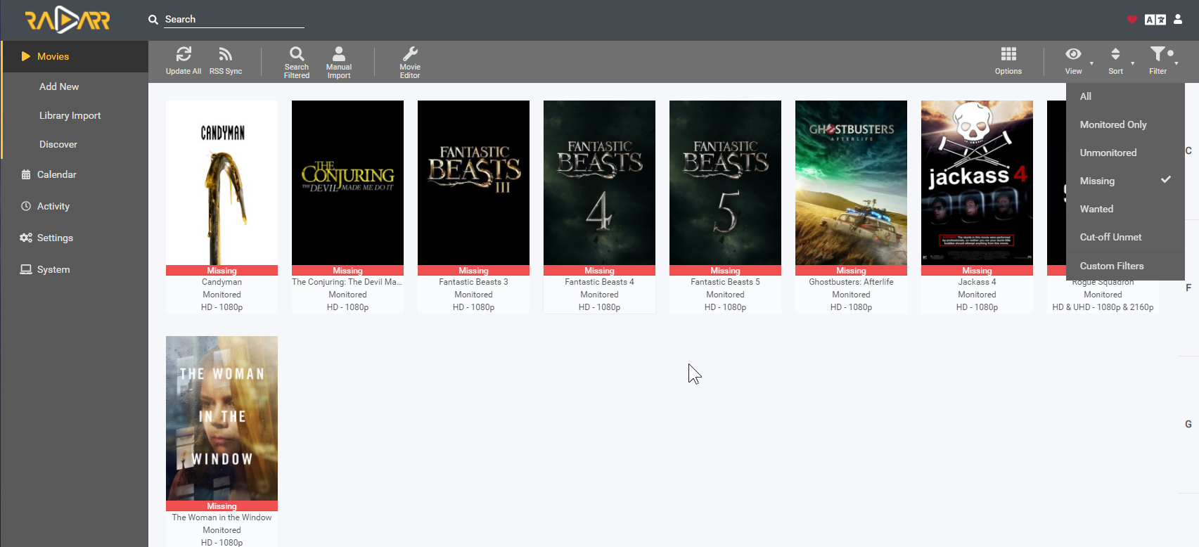

Interstingly enough, the 10/1 is back now with 1 in queue, no idea why again.

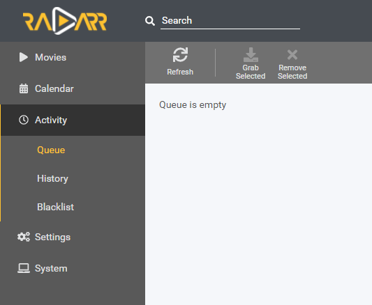

Screenshots below.
Thanks in advance!
Just want to drop in again to see if anyone else had any advice here, I'm still seeing same issue and I cannot for the life of me figure out what is wrong here. I'm nearly tempted to blow away my Radarr entirely and re-import from scratch to see if that fixes it :(

4 minutes ago, dbinott said:
If radarr itself is not reporting anything in the queue, then it is most likely an issue with the other app showing incorrect data. Did you ask them? Go to their github page.
I did ask them and they told me it was an issue w/ my Radarr.
I even deleted all my wanted/missing movies, and it still showed 1 missing 1 in queue with nothing actually in the UI as missing/wanted.
I actually just confirmed it's Radarr as well by adding a 2nd instance of Radarr to Heimdall (I have a 4K isntance)
The 4K one shows correct missing and queue numbers.
I was able to run an API command to find the one stuck in queue (it was an "unknown movie")
But I'm not able to find the right command to show me my "missing" movies so I can cross reference that list with what I show in the UI to find a culprit.
So this did end up being a Radarr issue after all
Adding info here incase it helps someone later.
The API command I ran and dumped to a text file helped me find it.
curl -X GET "https://localhost:7878/api/v3/movie" -H "accept: application/json" (also added API key for auth that I removed here)
I then looked for "hasFile": false to find what movies were missing, and found one that wasn't in the GUI under missing and just removed it from Radarr entirely for now to prevent the issue.
Queue issue was an "unkonwn movie" which you can show in UI via options toggle in top right corner. Somehow missed that. Used a separate API command to find that an unkown movie was in queue but this part was findable/fixable via UI in the long run.
