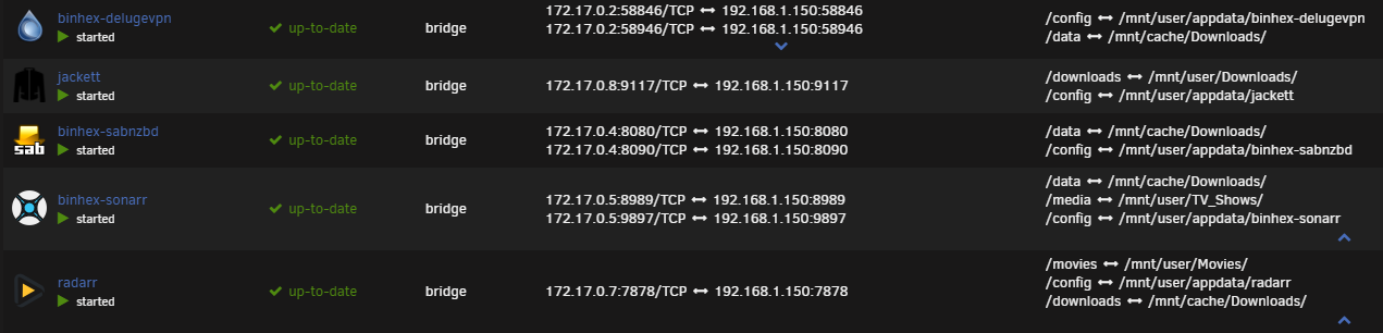

Hey fellas!
I am hoping someone here can help me figure out what is going on with my install of RADARR. I have a fresh new UnRaid server and I am just getting all my dockers up and running. Everything is running great with the exception of my Linuxserver Radarr I keep getting this error in the logs. I wanted to test it out to make sure it was downloading and moving files correctly but its not.
My Sonarr is working just fine though so I am not sure what gives. Here are the configs on my dockers
My deluge setup
and my SabNZB setup
If anyone has any insight as to what is causing this please let me know! Thank you!
4 hours ago, Squid said:
Your path mappings between Radarr and Deluge don't match
See https://forums.unraid.net/topic/57181-docker-faq/?tab=comments#comment-566086

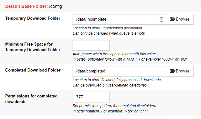

 Hey Squid,
Thanks for the reply. Please forgive my noobness, I read the post you linked and I am still a bit confused. I guess what is throwing me off is that I have Deluge, SabNZB, and Sonarr working correctly. There are no issues with the TV side of things. Everything points to my drive mappings being incorrect but I am not sure where they are incorrect.
I have a dedicated downloads share that I created on the cache drive the looks like this
/mnt/cache/Downloads/
--- completed
--- Incomplete
--- Unzipped Torrents
Deluge, SabNZB, and Sonarr are mapped to that Downloads folder. So I am confused as to how radarr is not working if I have everything mapped to the right location. Unless I am supposed to map the /Downloads in the radarr container to /mnt/cache/Downloads/completed
I can see the files that are being downloaded in the 'incomplete' folder and they are moved to the completed folder once they are done. sorry for being such a noob I am still new to all this :)
Both sides of the mappings must match, not just the host side.
okay, I understand that but where is my mapping wrong? This is what I am trying to get to ... besides the /Download option in the container no where in radarr does it let me tell it where the download folder is.
Am i suppose to configure a remote mapping under the download client section???
I never had to do any of this when I setup my Unraid 6.8.3 server ... I've had so many issues to fix on 6.9
Edited by SiRMarlon
12 hours ago, SiRMarlon said:
/data <-> /mnt/cache/Downloads -> deluge, sab, and sonarr
is not the same as
/downloads <->/mnt/cache/Downloads -> radarr
data != downloads, those are currently different. They must be the same.
Nothing with regards to container path mapping has changed, it's been this way since docker was added to Unraid.
is not the same as
okay so am I supposed to change the container side on Radarr from "/Downloads" to "/Data" so it matches? is the issue because I am using different docker versions? I am using Binhex on the other dockers instead of LinuxServer
*EDIT*
Went into the container and changed the container path from /downloads to /data and now it works.
Edited by SiRMarlon

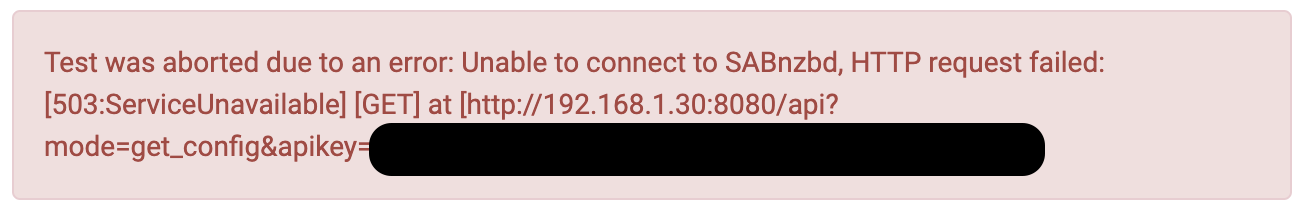

all good to update to stable unraid 6.9.0 with this docker?
I have updated and I have received this error and I can't find a solution for it?
[quote]
Test was aborted due to an error: Unable to connect to SABnzbd, The SSL connection could not be established, see inner exception. The remote certificate is invalid according to the validation procedure.: 'https://###.###.#.#:8080/api?mode=get_config&apikey=##############&output=json'[/quote]
Does anyone have any ideas?

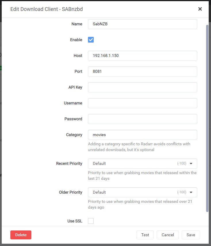

[quote]
Thanks :)
do you have Radarr trying to connect to SAB over SSL? I believe 8080 is not the SSL port ... this is how mine is ... removed my API key for picture purposes. But make sure you have your SAB API in there.
8081 is the regular port I assigned because 8080 was being used by one of my other dockers.
Edited by SiRMarlon

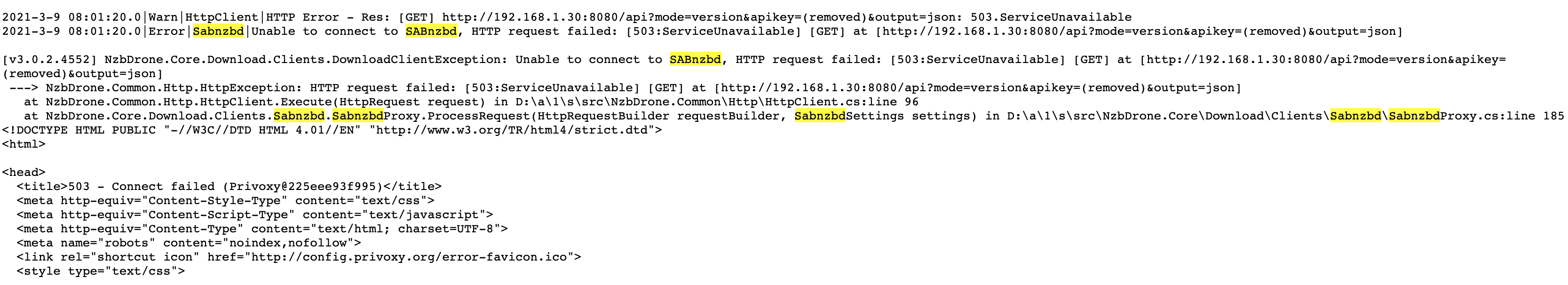

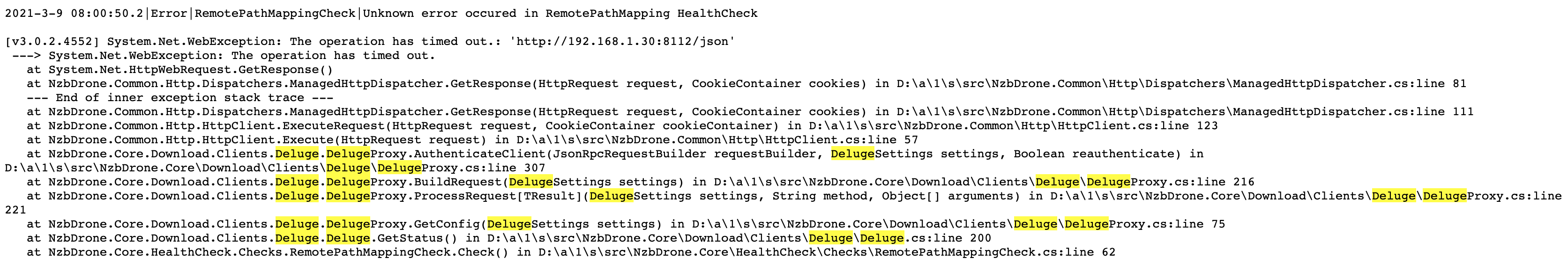

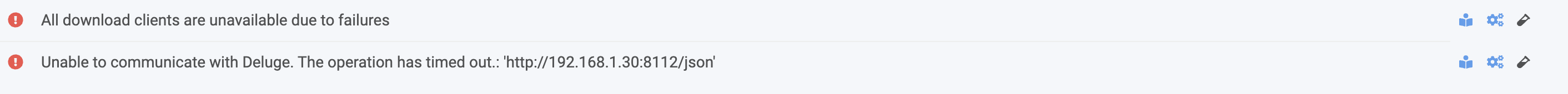

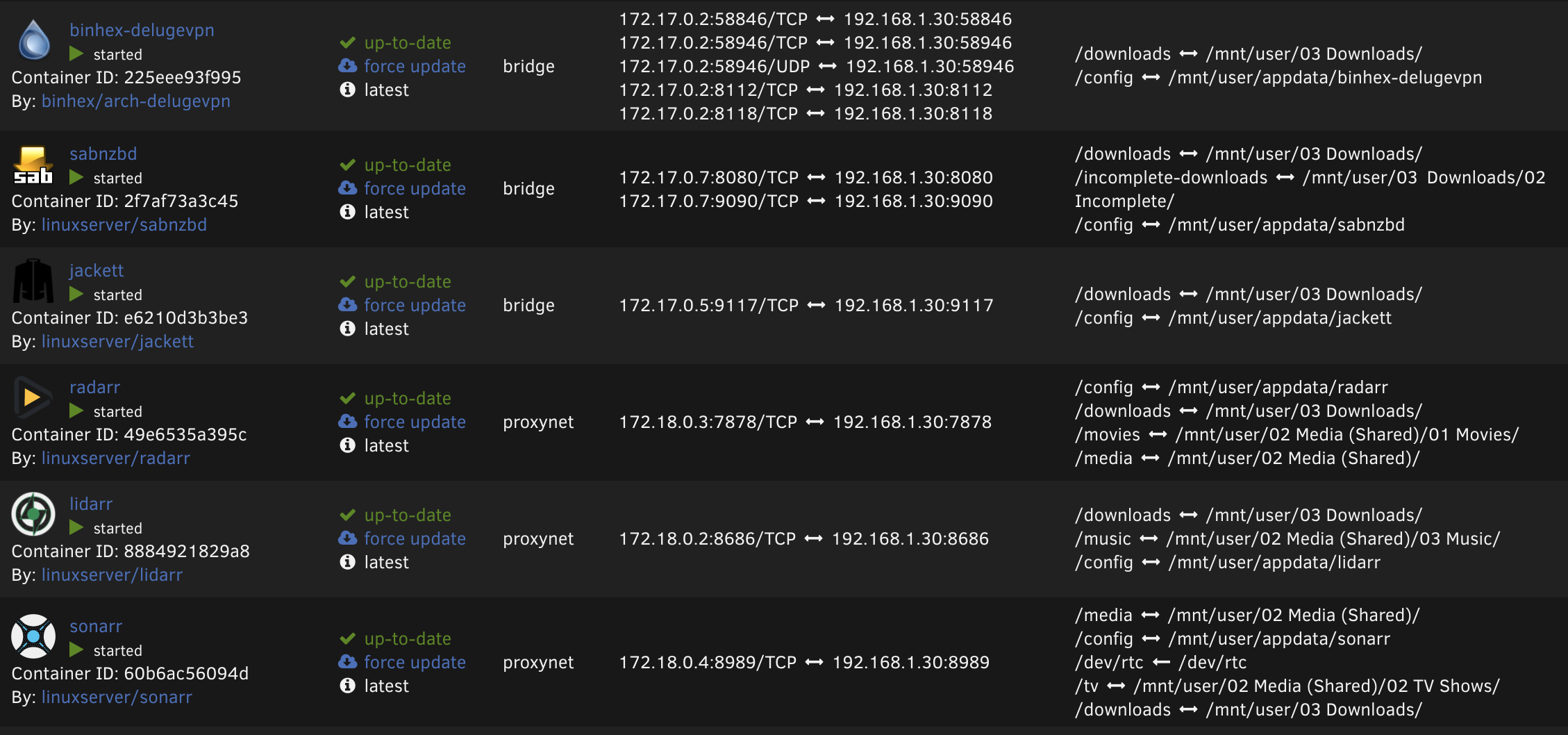

I was recently checking the status of my radarr as there was some issues with the downloading of the movies i was monitoring.
I noticed that "all the download clients are unavailable due to failures' - (I also noticed that i have issues with my sonarr and lidarr too)image.thumb.png.837d4ebcb1ca2edd32844b0e0e362193.png
I went to check the setting and both my delugevpn and sabnzb failed on testing
in the system status i noted
Deluge
I am not sure how i can go about solving this issue, is it the radarr or the deluge and sabnzbd?
I have checked my paths and disabled SSL, I tried disabling certification validation for local addresses too
I have not change any settings for quite a while, but i do have auto update on for all my docker apps.
i did set up a reverse proxy previously in letencrypt but i havent moved over to swag. I have tried to but wasnt able to set it up properly.

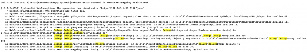

in the log files it mentions
For Sabnzbd
For Deluge
Radarr Version
3.0.2.4552
Package Version
3.0.2.4552-ls96 by linuxserver.io
sry if i didnt provide enough information, not sure what is needed to troubleshoot this. mostly i follow guides from spaceinvader one when i set up so not sure why now got issues.
Thanks in advanced for the help!

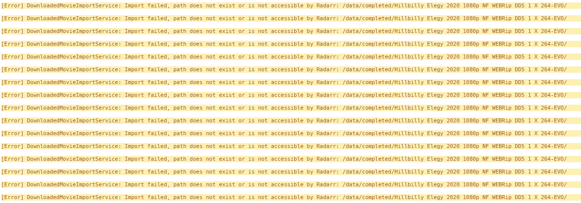

Ok can a fresh pair of eyes have a look at this before i go mad! lol
Getting the classic error below.
DownloadedMovieImportService|Import failed, path does not exist or is not accessible by Radarr: /Downloads/completed/movies/...
Paths as below.
NZBget is doing what it should but Radarr is not renaming and moving Films folder.
Edited by turnipisum
It's working! changed stuff about a million times but seems to be doing it's thing now.

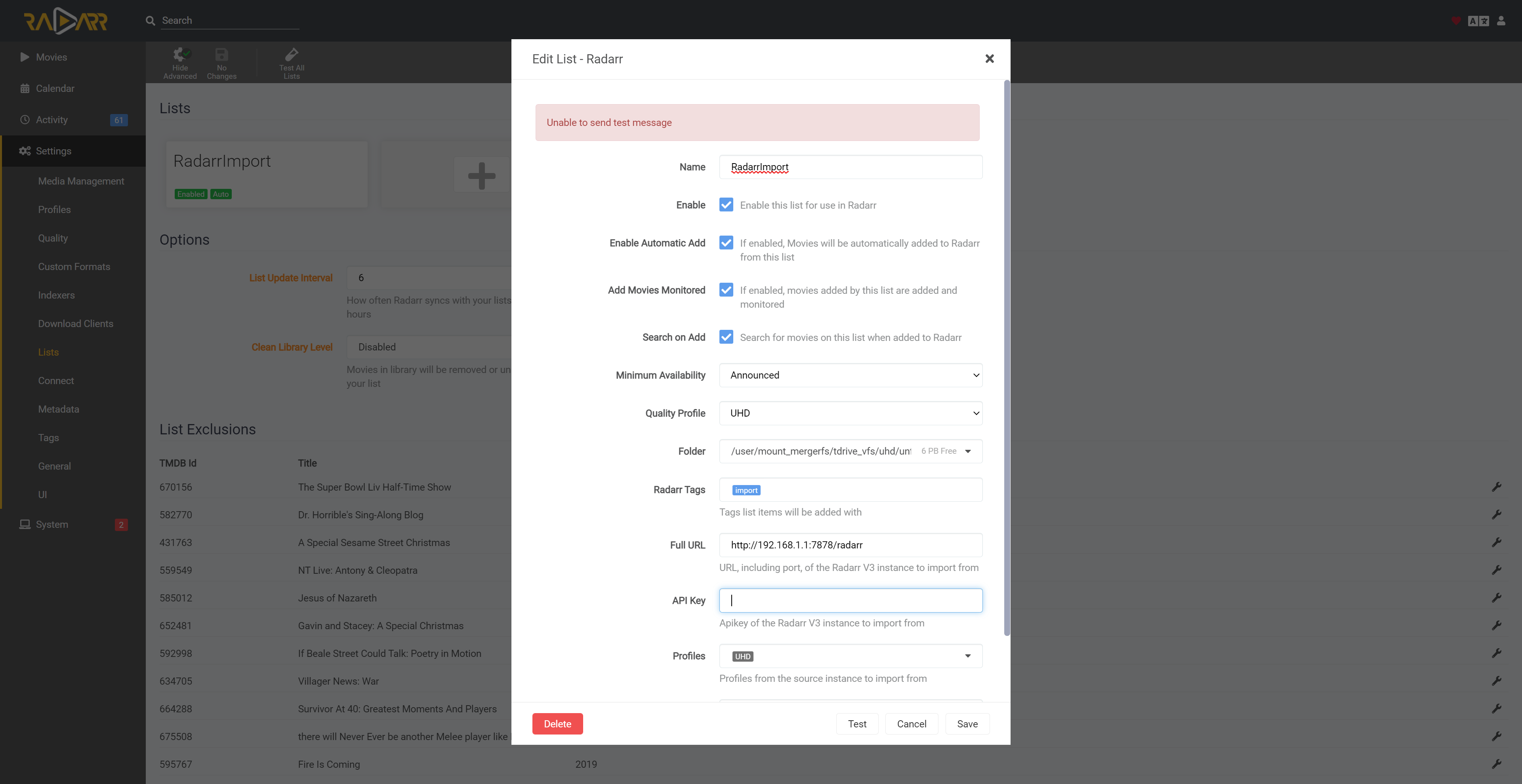

Is anyone else having problems using the Radarr list import from a 2nd Radarr docker?  It works fine for me with Sonarr, but with Radarr I get "unable to send test message".  (API deleted below)
Thanks in advance for any help.
