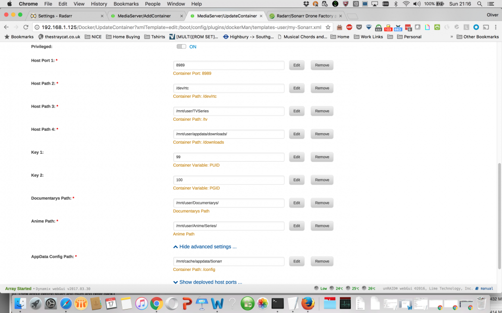

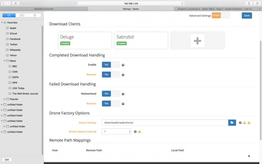

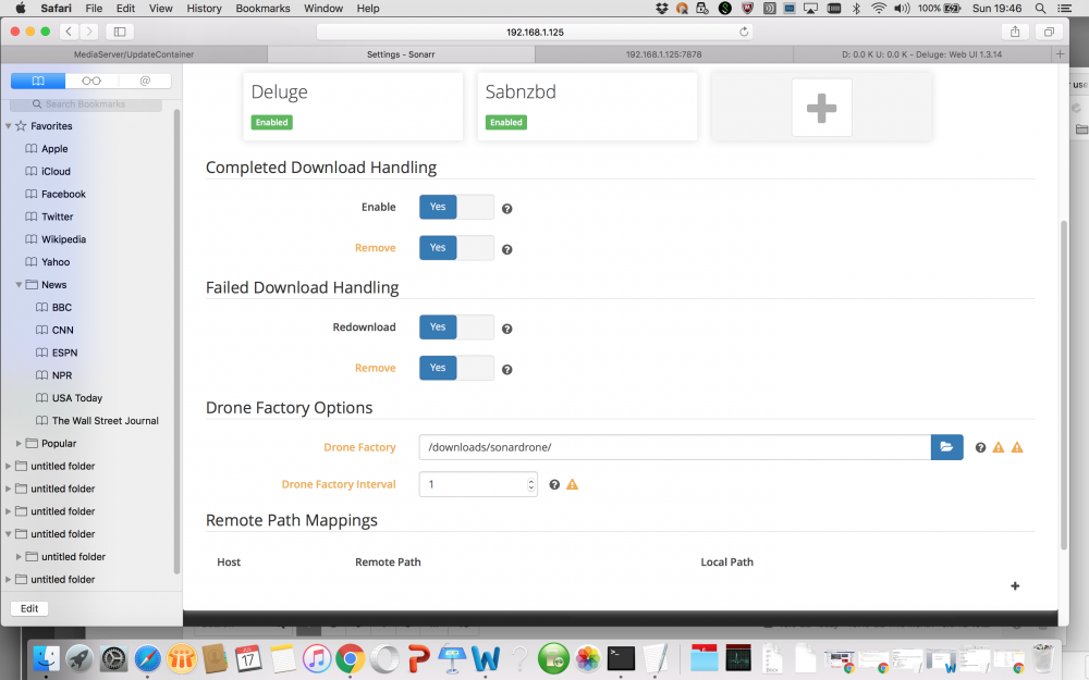

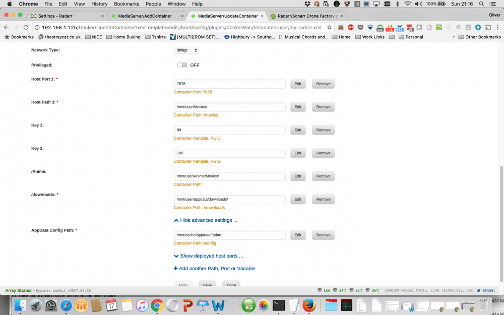

Hi guys, i have a weird issue with Radarr/Sonarr and the drone factory not picking up folder for processing (not sure if it's even still ment to be working as there was talk of depreciating it?) My paths are set as below in unraid:
Sonarr (Unraid config)
/downloads  --> /mnt/user/appdata/downloads/sonardrone/
Radarr (Unraid config)
/downloads --> /mnt/user/appdata/downloads/radardrone/
And within Radarr/Sonarr GUI, under dronefactory, there set as follows:
Sonarr Drone Factory (Sonarr GUI)
Radarr Drone Factory (Radarr GUI)
Everything's on the same server (192.168.1.125) and i'm fresh out of ideas! nothing in the logs corresponding to anything useable! :)

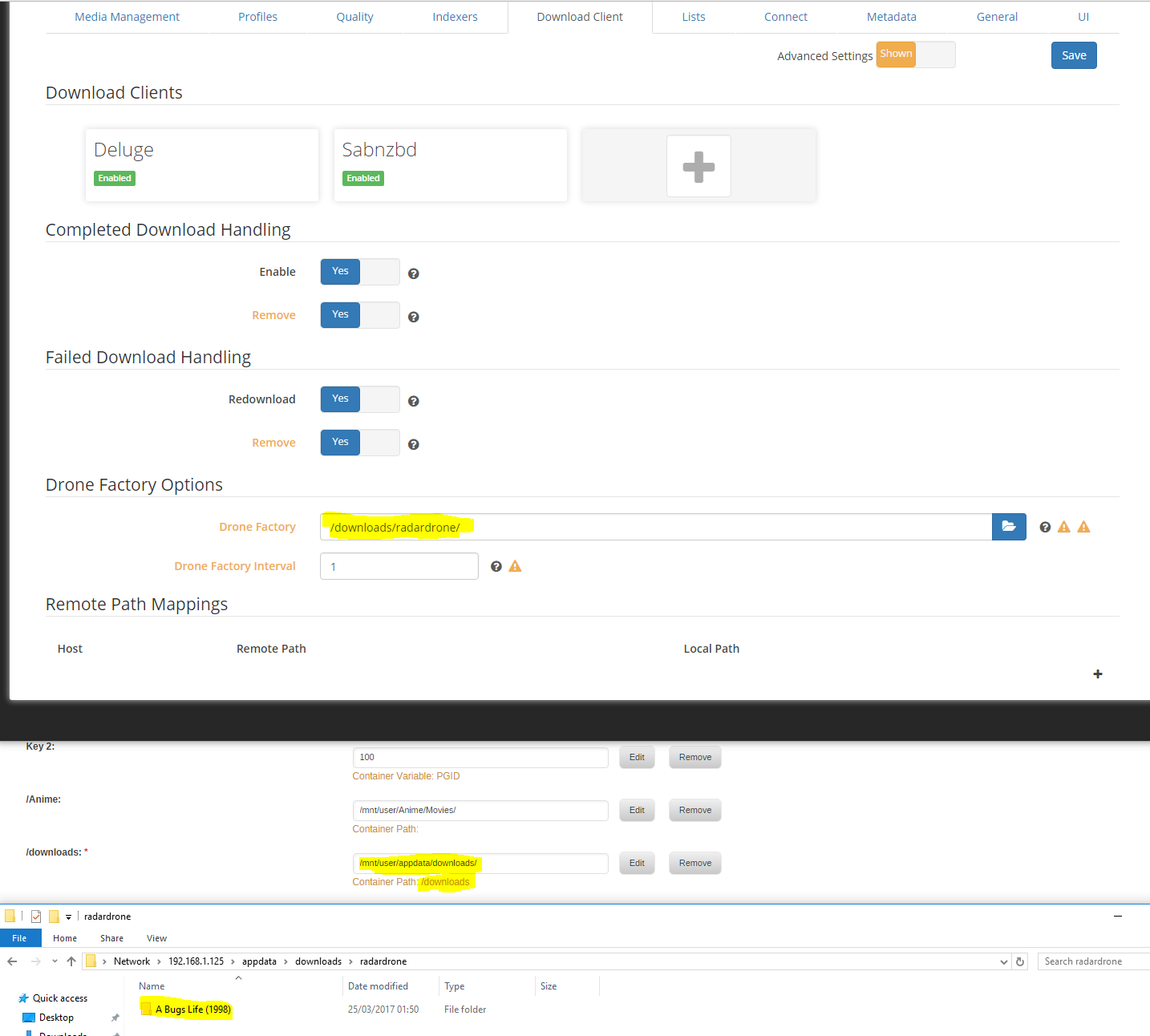

I threw some attachments in to show, i can browse to the folders from within Radar and Sonar and can see the folders of films waiting to be processed but for some reason nothing happens when i manually trigger the dronefactory? Does the config look right to you? I'm starting to think the feature has been quietly depreciated... Can you see anything strange in the screenshots below?
Just to satisfy my curiosity try changing /downloads to point to /mnt/cache/appdata/downloads/
Pretty sure i've tried it but i'll give it a go now! I take it you mean change it on radarr, sonarr and sab?
UPDATE:
Just turned off radarr. Remapped the /downloads -> /mnt/cache/appdata/downloads/
Havn't done sabnzbd or sonarr yet as they shouldn't have anything to do with this test.
and still nothing.
Clicking on the drone factory button under "wanted" did take a minute or so to finish but nothing was processed. I have around 160 folders (each a movie in the drone factory at the moment for what it's worth, ive also tried moving them all out and keeping 1 film in the folder and restarting) Nothing.
Can anyone post there container mappings, radarr/sonarr drone factory path and potentially there remote mappings for me to try emulating?
UPDATE:
Renamed the old radar drone factory -> radardrone2)
created a new folder called radardrone.
Copied 1 movie with a reasonably nice name into this folder for the radardrone to post process.
Nothing. And no mention in the logs about it from forcing the radardrone factory to scan :(

From your first post:
This setup tell sonar to ultimately look in /mnt/user/appdata/downloads/sonardrone/sonardrone (since /downloads is a shortcut to /mnt/user/appdata/downloads/sonardrone)
Same thing with Radarr.
Like @chbmb said, if you set the mapping for /downloads to the exact same mapping on every container applicable, it should all work fine.  As a matter of fact, once its all set up correctly, any new downloads won't have to go through the drone factory, and the intercommunication via the API's will automatically begin the imports once they are completed.  But, I don't ever use deluge.  But it will work no problems with Sab/nzbget
