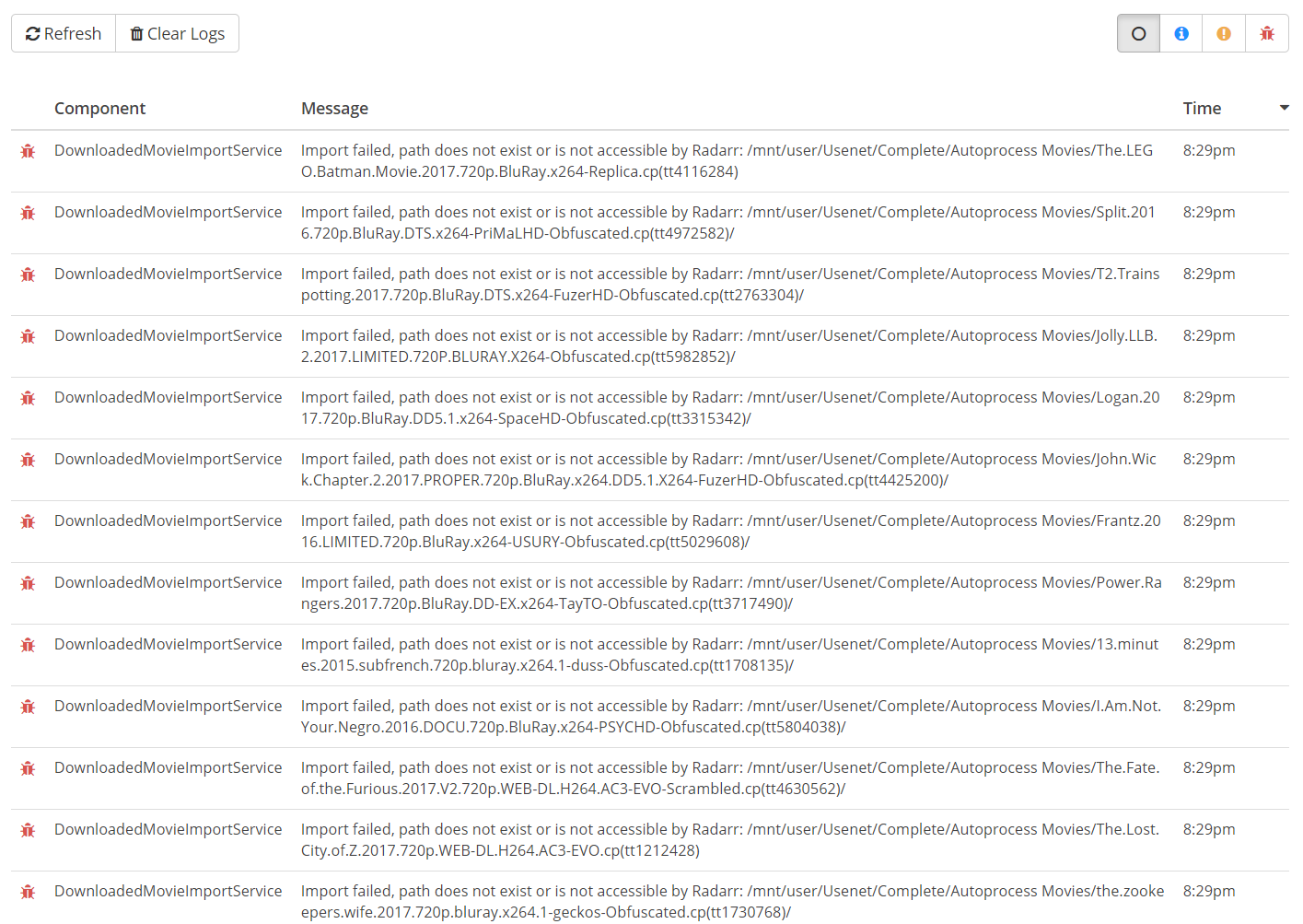

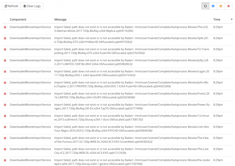

Edit: Also getting the following error
Import failed, path does not exist or is not accessible by Radarr:
My docker paths to my download folder are identical for nzbget and radarr.
Edited by CrashnBrn
I'm getting the same " Import failed, path does not exist or is not accessible by Radarr: " error.
Files are downloaded fine, then they sit in the folder they were downloaded and Radarr can't move them for some reason.  Very weird.
Odds on, you do not have the EXACT same mapping for your downloads (both host and container) mapped to the radarr container.  (Or you're downloading into the appdata share for NZBget instead of a dedicated download share)
The actual error from Radarr will tell the story
Edited by Squid

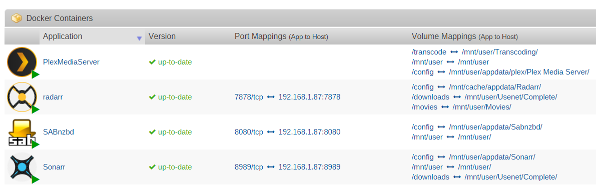

I just switched all my plugins (SABnzbd, Sonarr, Plex) over to dockers and added Radarr as a docker and most things are working correctly, but I'm running into a couple of snags with Radarr and to some degree Sonarr.
I've been using Sonarr for some time use the Drone Factory for my TV download folder that SAB puts TV downloads into. While I was updating things, I saw that Sonarr and Radarr now have "Complete Download Handling". From what I understand, you can turn off the drone folder and just have SAB and Radarr/Sonarr communicating when downloads are finished. Then Radarr will process the movie, move it to the movie folder, and clean up the folders.
PROBLEMS
1. The only way my movies are getting processed is if I setup the drone folder.
2. After they are processed I'm left with folder containing leftover junk files. They don't get cleaned up.
3. If I try to use complete download handling the movies/tv shows get downloaded to the appropriate folders, but then nothing happens.
See configuration in image attached.
I'd really appreciate any help!
