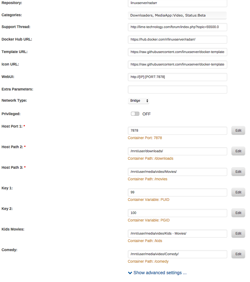

On 8/30/2017 at 1:46 PM, CHBMB said:
@jamesp469 Can you post a screenshot of your docker template setup?
1 hour ago, CHBMB said:
What's in the advanced settings bit?
Just the config path, which is "/mnt/user/appdata/radarr"
Delete the contents of /mnt/user/appdata/radarr/  Remove the docker image and container, then reinstall.
If that doesn't give you a clean slate then do it again, but change /mnt/user/appdata/radarr/ to /mnt/cache/appdata/radarr/
Thank you!  Changing /mnt/user/appdata/radarr/ to /mnt/cache/appdata/radarr/ has appeared to solve the issue.
Edit - I did not delete/remove any data

I have my movies in multiple folders for organization.  Is there a way to specify this within the initial Radarr setup?
Are they in multiple shares (/mnt/user/BluRay and /mnt/user/DVD) or multiple folders (eg: /mnt/user/Movies/BluRay and /mnt/user/Movies/DVD)?
If the former, add another path mapping to Radarr, and import the movies from that path.  If the latter, you may have to specify the subfolder of the share and import the movies from that subfolder, then go on to the next subfolder.
Thanks for the quick reply!  Sorry... yes, they are in multiple shares.  What should the initial container path be set up as for the movies when adding the Docker?  Thank you.
