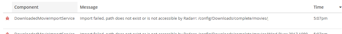

I posted this in Radaar and Sonaar support forums but it looks to me this is a Docker issue...
Something is off and I can't find where the issue lies... Radarr and Sonarr are not looking for the downloads folder in the correct path.
Sonarr log message:
Import failed, path does not exist or is not accessible by Sonarr: /config/Downloads/complete/tv/
Radarr log message:
Import failed, path does not exist or is not accessible by Radarr: /config/Downloads/complete/movies/

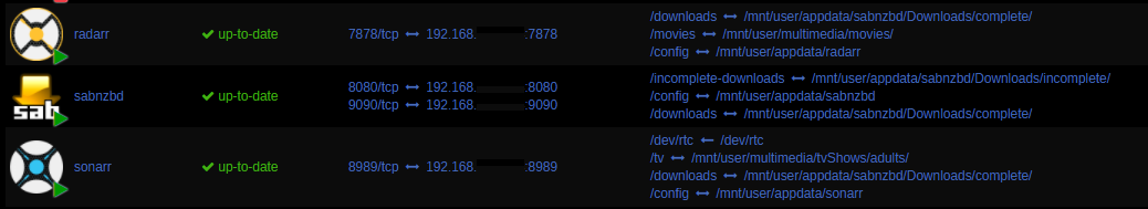

For some reason Raddar and Sonnar are looking under the config folder instead of the path defined for the downloads folder. Here are the details of my setup:
  • Both Sabnzbd and Radarr are installed dockers in an UNRAID box
  • Sabnzbd path to downloads folder as defined in the docker: /downloads -> /mnt/user/appdata/sabnzbd/Downloads/complete/
  • Raddar path to downloads folder as defined in the docker: /downloads -> /mnt/user/appdata/sabnzbd/Downloads/complete/

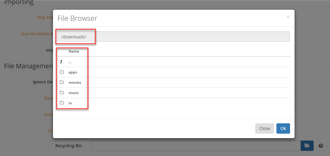

  • Any file browser within Raddar is able to see the correct downloads folder

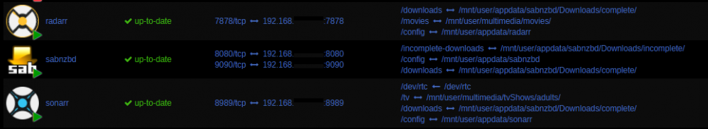

Screenshot of Docker settings:
Screenshot of UNRAID setup
Screenshot of a file browser window within Sonarr showing it can see the /downloads folder and its content:
Is the key to this, somewhere, possibly sabnzbd, you haven't configured something correctly.
It's not a docker container issue, it's a config issue
I'm guessing sabnzbd is telling sonarr/radarr to look in /config/Downloads/complete/movies or /config/Downloads/complete/tv
Whereas it should be telling them to look in /downloads/movies or /downloads/tv

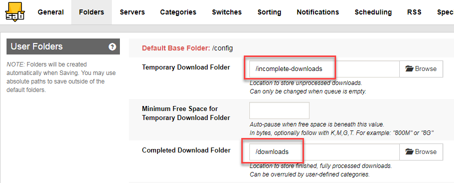

I'm going to try changing the path of Sabnzbd categories to absolute paths. Right now they are using the default, relative folders are based on: /config/Downloads/complete. This should fix it... Thanks for pointing this out!
I changed the path to the Sabnzbd categories and it didn't help. I then changed its download folders to absolute paths but it didn't resolve the issue. Logs continue showing the default path. Note I restarted all three dockers.

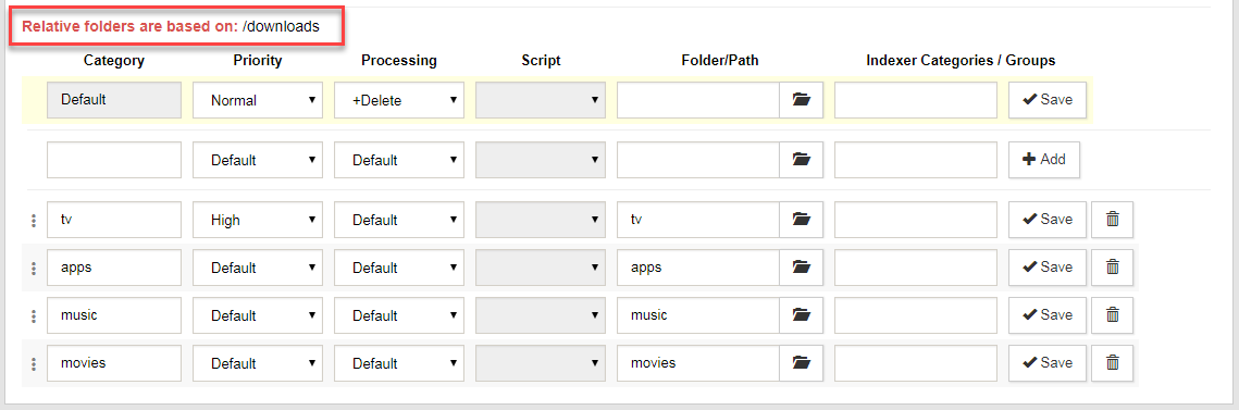

Screenshot to User Folders in Sabnzbd:
Previous step changed the path for the categories folders. They are now relative to /downloads:
After all this, the logs keep showing the default path:
Check out that first screenshot.  Default Base Folder: /config
I don't use sabnzbd, but that would account for your problem.  Somewhere else possibly in Sonarr/Radarr you must have configured something to look in
/config/Downloads/complete/tv  / /config/Downloads/complete/movies
Edited by CHBMB
How you've got it set up now is correct.  BUT, IIRC SabNZBd is a tad strange in that if you change things when stuff is already queued, the queued items still go into the original places, which account for the problems you're having.
Clear out the queue, have Sonarr / Radarr send over a new download and then see what happens
