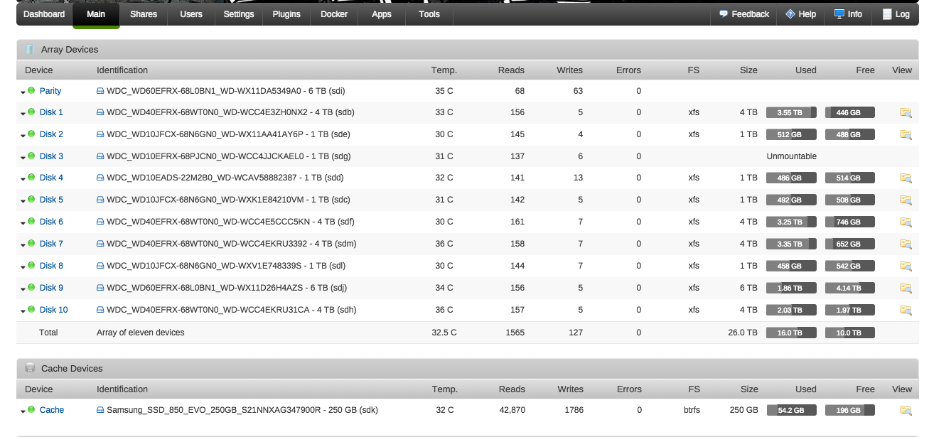

I rebooted my unRAID server v6.2.4 and Disk 3 which is formatted as xfs states 'unmountable'. In some threads, it says to run xfs_repair with the -L option tool and in others, it says to run a new config.
I don't want to lose any data and I haven't formatted the disk. I have tried the Parity-Sync/Data Rebuild but that did not help and the Disk passes the SMART test without any errors.

That screenshot looks like it is rebuilding the disk. And rebuilding an unmountable disk will just result in an unmountable disk. And a parity check wouldn't help either, nor would a New Config. I don't really see how you could have gotten the idea that you needed to do any of those things.
You really should have asked before doing anything. Not clear what you already did before asking.
Go to Tools - Diagnostics and post the complete diagnostics zip.

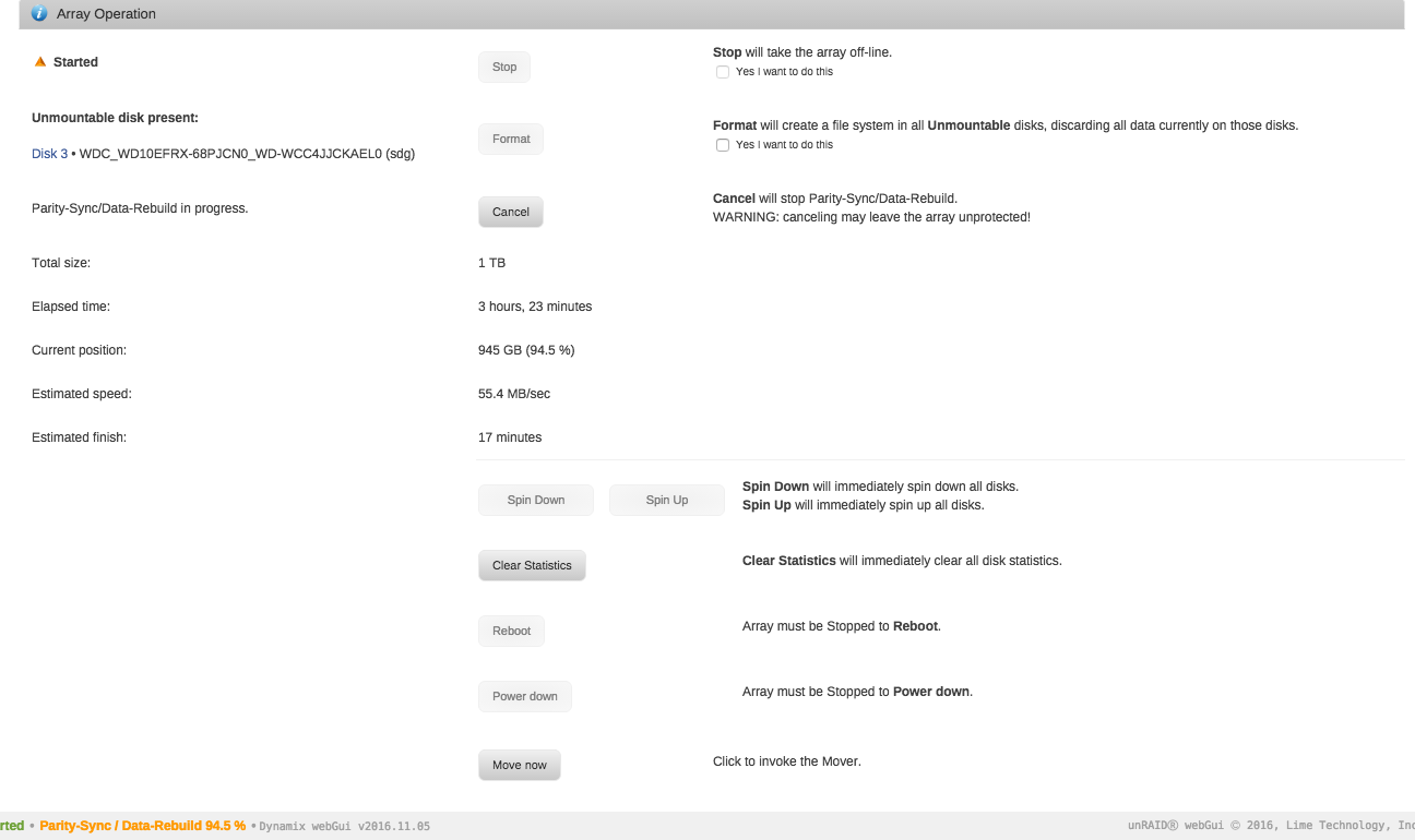

The syslog agrees with the screenshot. It is currently rebuilding the disk. The reason I say this is not only because of the yellow triangle, but also because of the large number of reads on the other disks and the large number of writes on that disk. unRAID rebuilds a disk by calculating its contents from parity plus all the other disks.
There is a bit at the end of your syslog that make me wonder about the connection to disk1 and cache, but the screenshot isn't showing anything in the errors column for disk1 so I guess it is OK. How is the rebuild progressing? Post a screenshot of Main - Array Operations.
The rebuild is almost done. I have attached the requested screenshot.
It would be great if you could help me find a solution or a thread closer to my issue. I would greatly appreciate it :) I tried searching, but I thought those 2 threads I found were somewhat close to my issue because others had the "unmounted" disk showing. That's what I was basing my search on.

According to the screenshot the rebuild was almost done. It will not have fixed your problem, but post another screenshot of Main-Array Devices when it is finished just to make sure everything is as expected before we proceed.

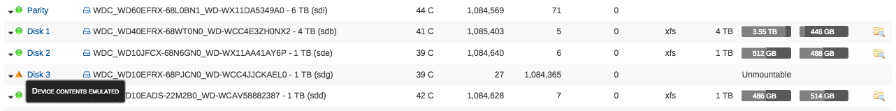

Here is the screenshot.
Looks OK, all drives green. You just need to repair the filesystem as in the wiki I gave you. Stop then Start in Maintenance mode, run the test and post the output.
