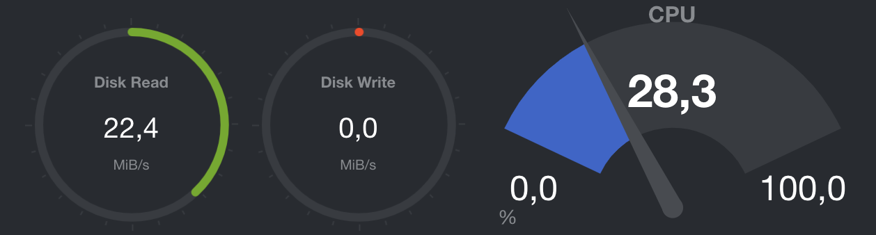

I'm experiencing very slow import speeds. I have Sonarr and Sabnzbd pointed to the same local download folder and Sonarr has to move files to a other local folder on my server.
I'm seeing this kinds of speeds:1794367731_Schermafbeelding2021-03-08om21_20_41.thumb.png.5426bac72171d1f78d2c0b649f593b8c.png
At some points the 'Disk Write' spiks to 500MiB/s.
Does anyone know how to fix this? I'm using a Samsung 970 PRO NVMe SSD for the local files, nothing else, so this should be very fast.
Thanks!

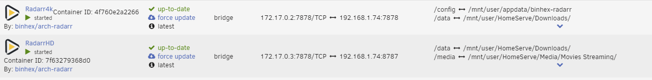

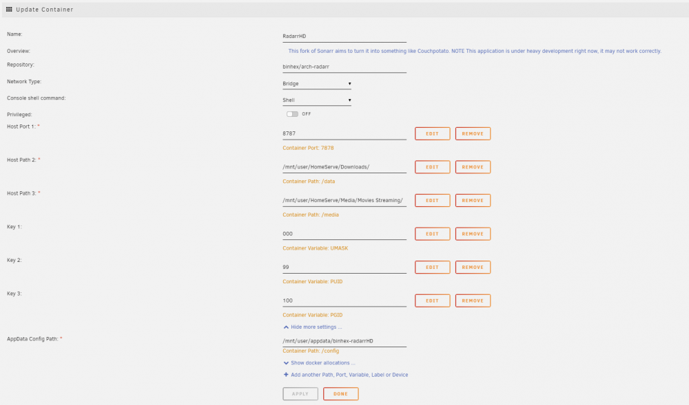

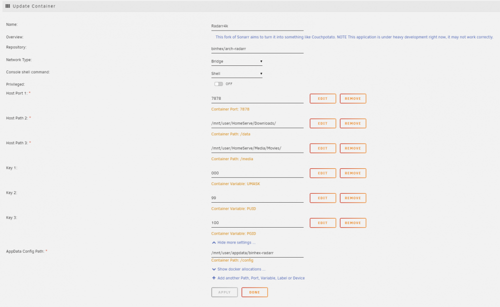

Hey. Im new to unraid. I've down loaded the radarr,NZBget containers withe these setting and i'm getting this error message" You are using docker; download client nzbget places downloads in /usr/local/bin/nzbget/downloads/completed/Movies but this directory does not appear to exist inside the container. Review your remote path mappings and container volume settings." Where to and what changes do i make?Thanks.

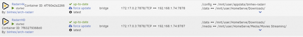

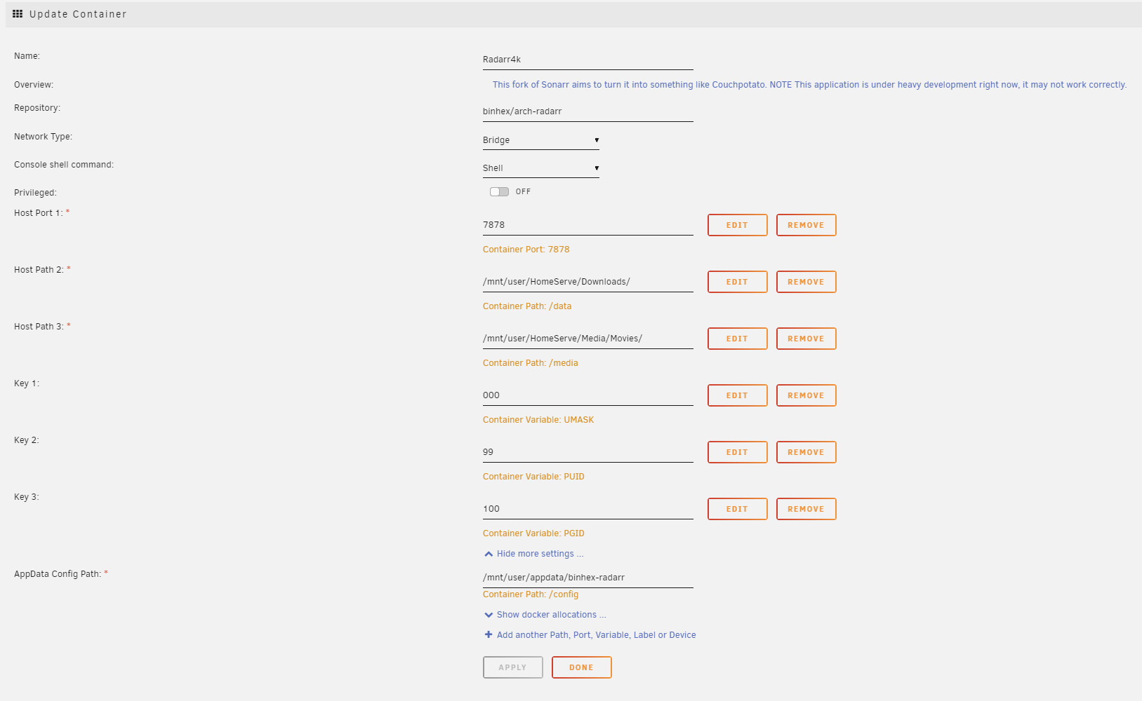

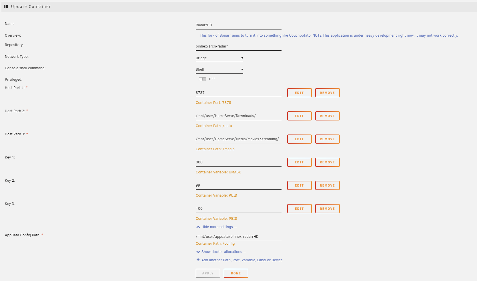

Hi everyone I'm really hoping someone here can offer up a solution because I'm going a little crazy.  Ideally I love radar. I think it works great. My biggest problem is that it won't let me select two different types of downloads. I want 4k for my personal use and 1080p for streaming. I'm trying to run two instances. I'm willing to start from scratch here if someone wants to make an Idiots guide to setting this up. I've finally managed to get two instances running but they mimic each other. So If I make a change in one (the profiles) it changes it in the other. Secondly I can't figure out why my port is 8787 to open the program.  If I select 4k I have to manually change the port to 8787 in the browser bar and it pops right up.  But then it mimics everything.  Please take a gander and look through the photos. I'm really at a loss here so for now will use couch potato to get the 1080p versions but ultimately would love to get this working.
What steps did any of you take to get two instances going? What did you change? What network mode are you running them in? I did create a different directory for the install.
Figured it out and it was no small task! So now I'm trying to do the tags to prefer x265 HDR content and the posts I'm finding from other people dont' seem to matchup with the screens I see in the docker version. Anyone else experience this? If I go to tell it to find x265 where do I put that in the custom profiles?
