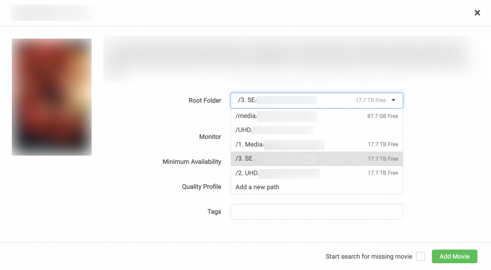

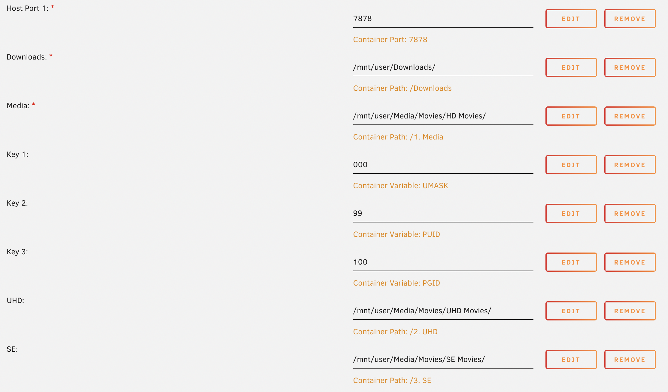

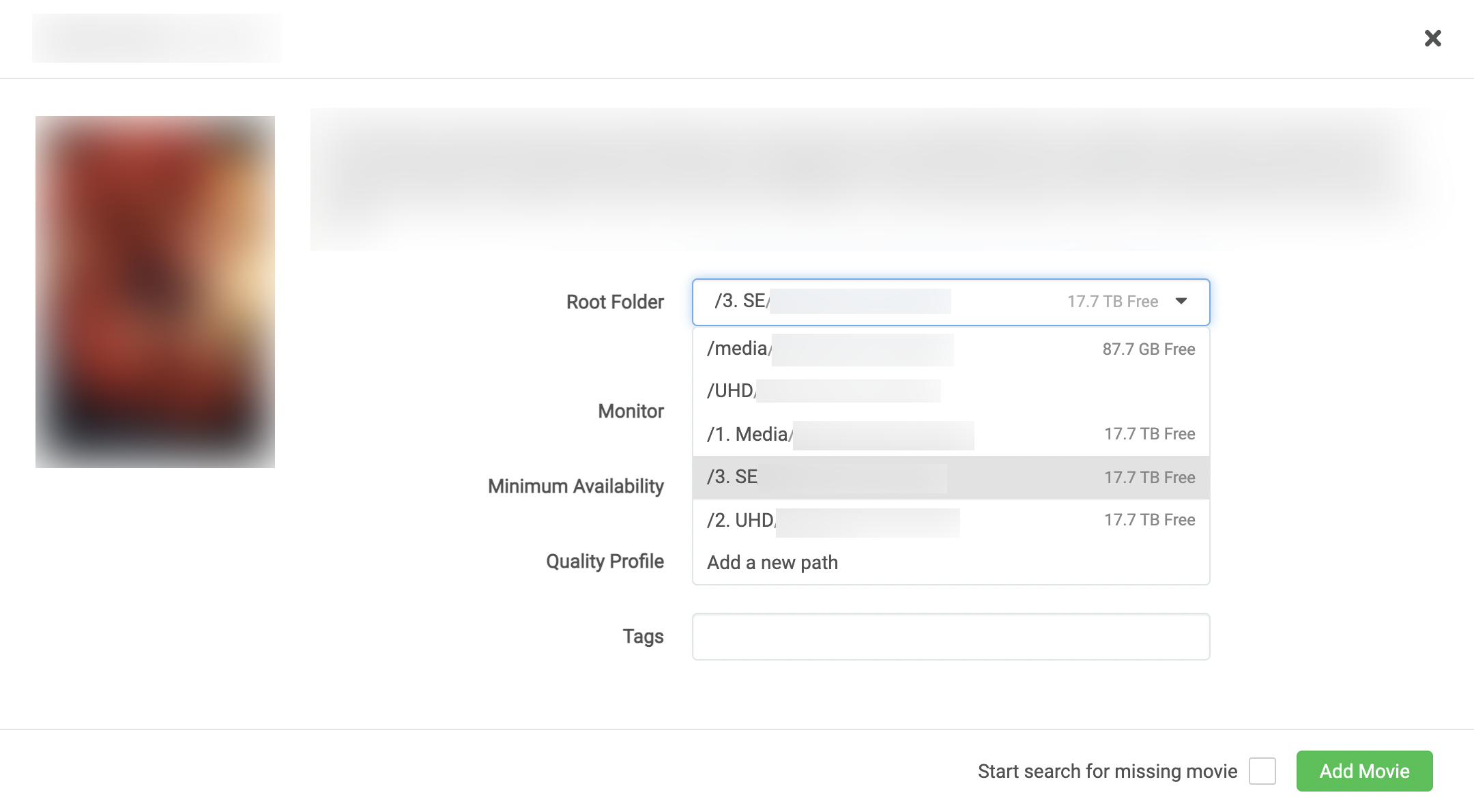

Is this the right spot for feature requests? Now that I figured out how to separate my UHD/HD directories by adding another folder path, only one thing is missing for me. Would love to see a option to check to replace/not replace current movie that's in the directory. Just downloaded some Director cuts of the movie I'd like to sit beside the Theoretical cuts of them. Would that be possible?
Run two instances of the docker with separate directories. One for each cut.
Yeah, I was hoping I wouldn't need separate directories. But I created a "SE Movies" directory along my other ones, added it to Plex and Radarr. Seems to do the job and don't need 2 instances of the docker running! I still think that option would be nice to have.
Curious how you configured Radarr to only download special editions to the SE Movies directory and use your other directories for the other videos?
Basically added more directory Path's in the Radarr setup. Then when I add a movie, change the root folder structure. Added numbers so they'd be at the top when I go back in the directory tree and they're easy to find. Works great! Had a couple old ones since I updated it and they're still showing. Wondering if I can refresh it so they're not there anymore?

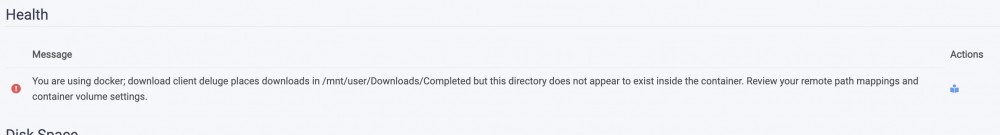

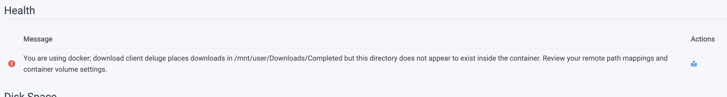

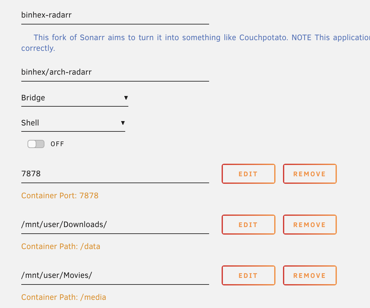

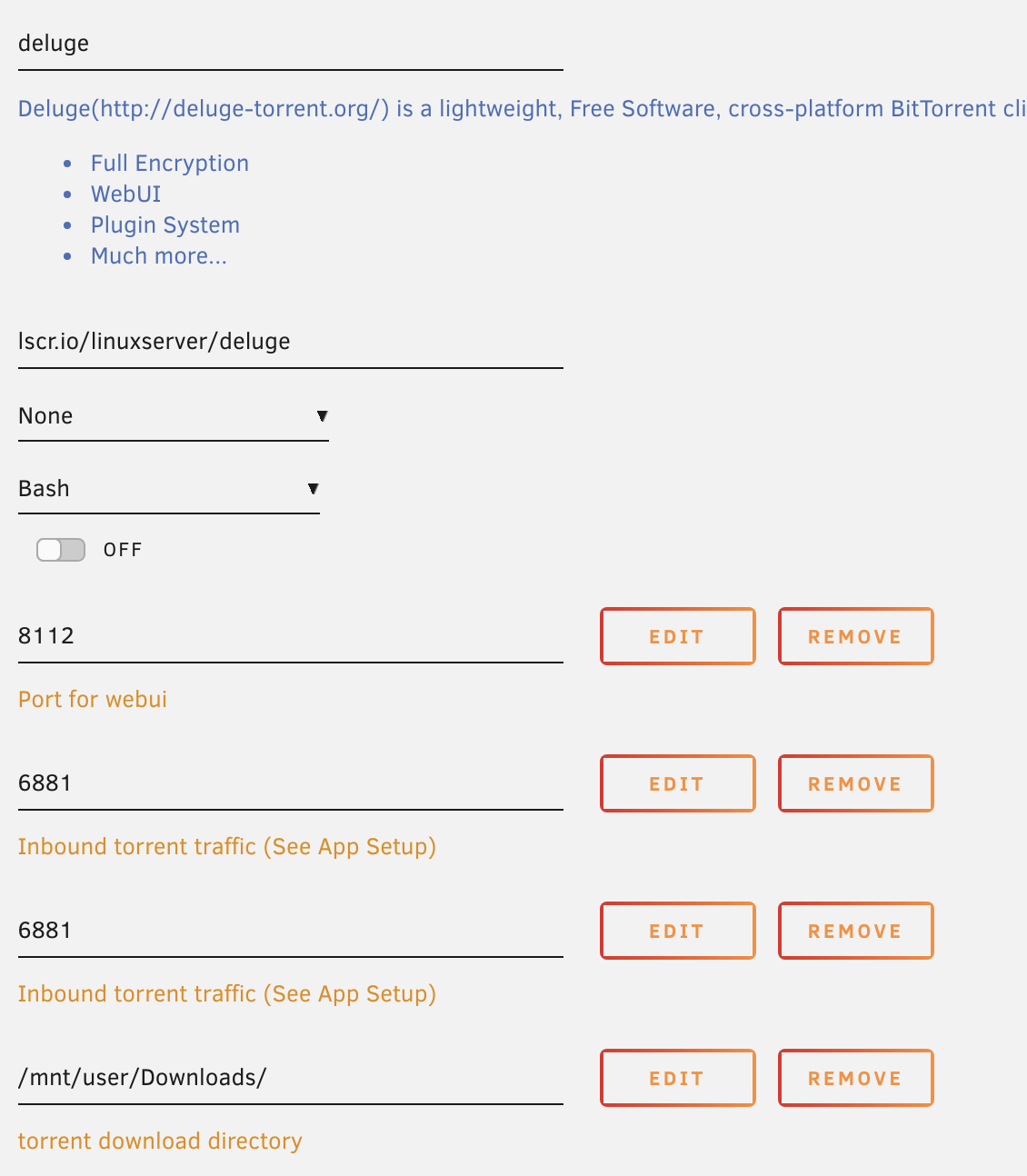

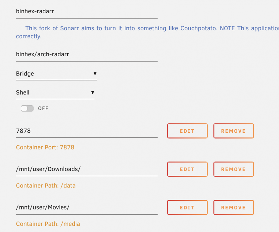

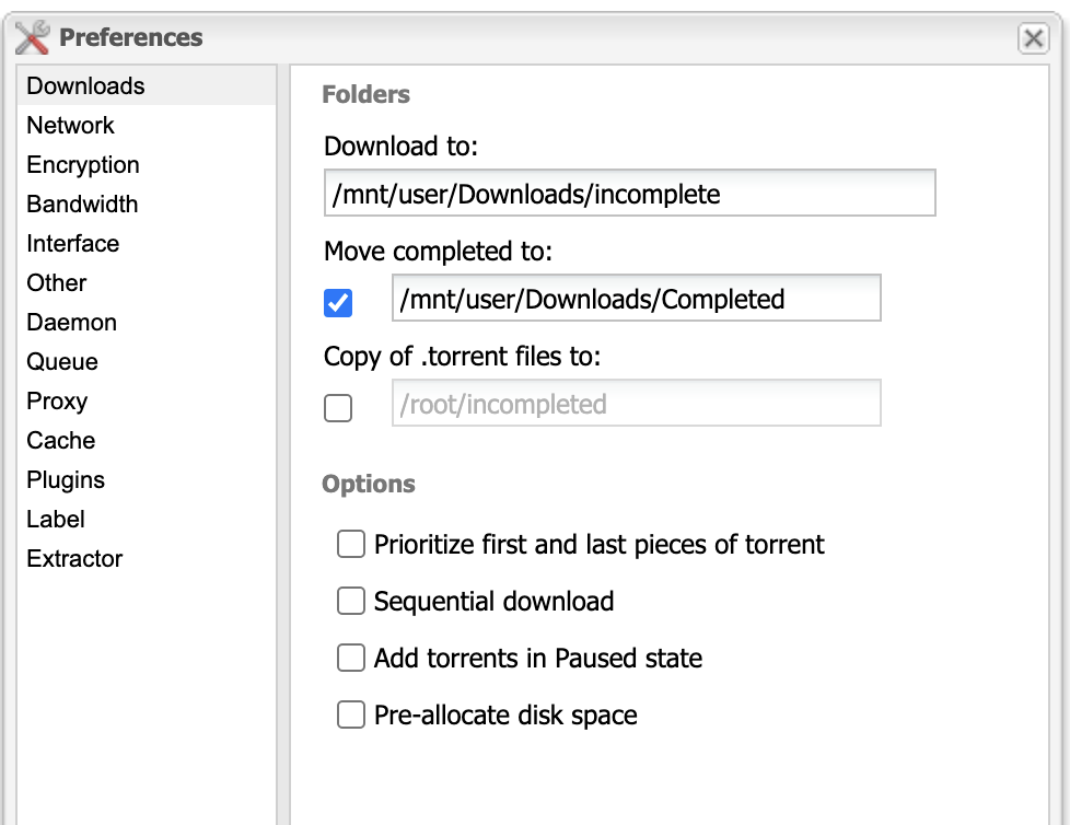

Can anyone help me with this error?
image.thumb.png.92a94417b97578c8d10ac0ac28cb0708.pngimage.thumb.png.44b2ebfb888bcda92ce627049dfb6704.pngimage.thumb.png.9bcceaaebaa28ddcd185ad39e94b0275.png
Change the Download to: field in your first screenshot to /data/incomplete and the move to /data/Completed
