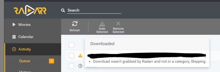

is anyone else seeing sonarr tv grabs in their radarr queue?  Is this a category issue?
Here's a screenshot of what I'm talking about:
Edited by betaman

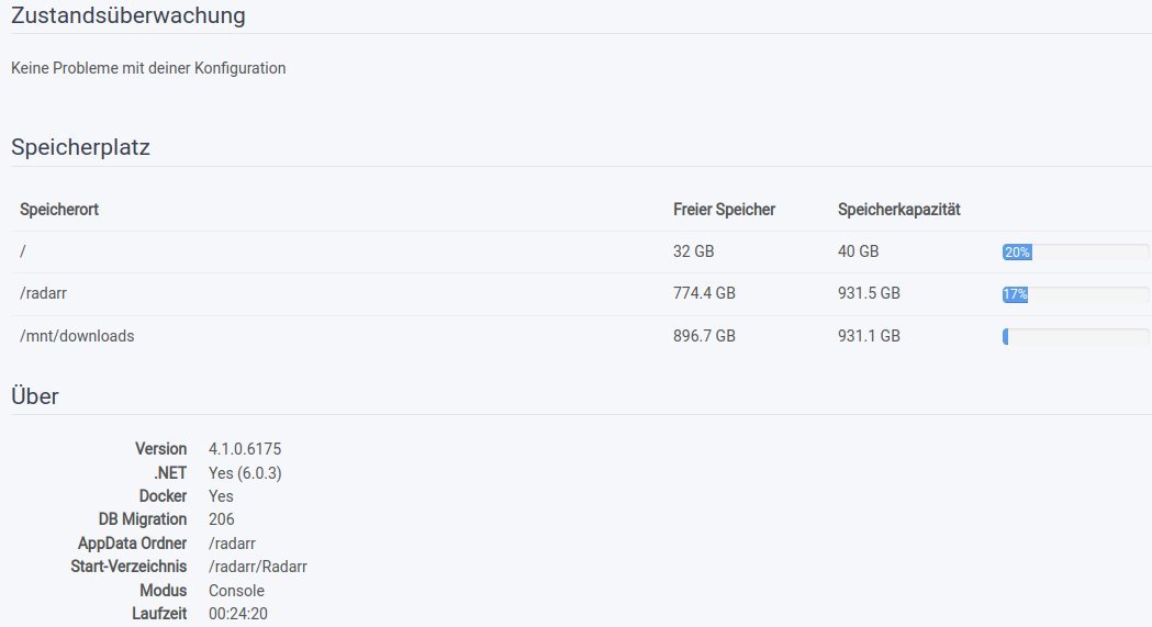

Hello,
I was wondering why Radarr always fills up my rootfs or ram.
I use an encrypted gdrive with rclone. And somehow the cloud is not displayed under location.
But I can retrieve or read the media under Movies.
What am I doing wrong?
13 minutes ago, speedycxd said:
fills up my rootfs
This is caused by mapping a host path that isn't actual mounted storage. Any path that isn't actual mounted storage is a path in rootfs.
Ok I see, how would I have to proceed so that I can specify this as a local path?
Or how can I mount this without loading rootfs?
