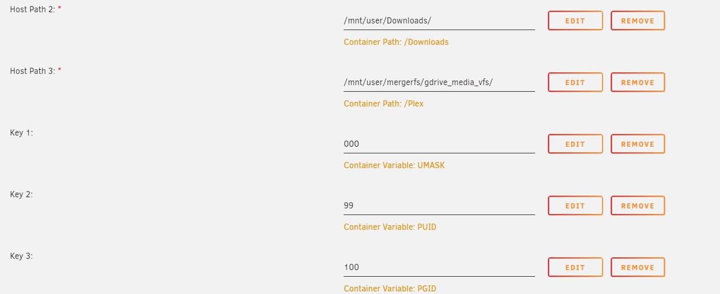

On 5/21/2022 at 1:45 PM, jwiese997 said:
System.UnauthorizedAccessException: Access to the path '/Plex/Scary Movies/Monstrous (2022)' is denied. ---> System.IO.IOException: Permission denied --- End of inner exception stack trace --- at System.IO.FileSystem.CreateDirectory(String fullPath) at System.IO.Directory.CreateDirectory(String path)
I misread the error message before, it's actually complaining about creating a new directory under your Plex share, not reading from your Downloads folder.
Can you post your docker settings for Radarr, especially the path mappings, please? I'm assuming you have created your own path variable that maps the Plex user share in unraid to a mount point called Plex inside the Radarr container?
Could you also try creating a directory manually in the Plex share from the Radarr container console?
Are you having the same issue on 6.10.2 stable branch?
Yes it is still doing it on the stable branch as well as the release candidates. Everything past the 6.10.1 rc1 fails to import. It's the exact same with sonarr
Are you using rclone to mount your gdrive by any chance? If so, then rclone is most likeliy running as root and screwing up your permissions. Add this to your rclone mount script:
--uid 99
--gid 99
Btw, you should have mentioned rclone and gdrive (if I'm right and your'e using that) in your posts as this is vital information and that's why nobody was able to help you. I'm only guessing here because your host path in your screenshot says mergerfs/gdrive...
--uid 99
--gid 99
Thank you! Thank you! Thank you! That finally fixed it! I'm sorry I didn't mention rclone but I didn't know that was important. You were the first one to ever ask questions to help. I literally was just told that it's working for everyone else so it's a problem on my end. No one ever actually helped me find the root cause by asking questions so I could actually give useful info. I'm not in IT, I'm just a hobbyist and am struggling to find my way through. I'm great with Google, but that only takes you so far. Thanks again!
Glad it worked out! :)

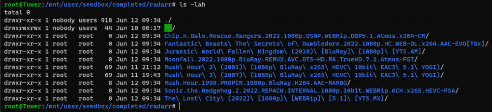

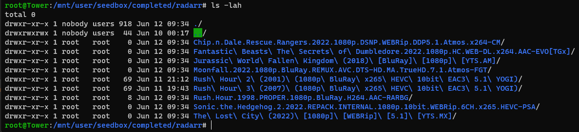

Maybe somebody can help me out here but I keep getting a permission denied issues with Radarr and Sonarr when trying to move files from my
/mnt/user/seedbox
directory to my
 /mnt/user/media/
directory.
[Warn] ImportApprovedMovie: Couldn't import movie /downloads/completed/radarr/Rush.Hour.1998.PROPER.1080p.BluRay.H264.AAC-RARBG/Rush.Hour.1998.PROPER.1080p.BluRay.H264.AAC-RARBG.mp4
[v4.1.0.6175] System.UnauthorizedAccessException: Access to the path '/downloads/completed/radarr/Rush.Hour.1998.PROPER.1080p.BluRay.H264.AAC-RARBG/Rush.Hour.1998.PROPER.1080p.BluRay.H264.AAC-RARBG.mp4' is denied.
   at System.IO.FileSystem.DeleteFile(String fullPath)
   at NzbDrone.Mono.Disk.DiskProvider.TransferFilePatched(String source, String destination, Boolean overwrite, Boolean move) in D:\a\1\s\src\NzbDrone.Mono\Disk\DiskProvider.cs:line 401
   at NzbDrone.Common.Disk.DiskProviderBase.MoveFile(String source, String destination, Boolean overwrite) in D:\a\1\s\src\NzbDrone.Common\Disk\DiskProviderBase.cs:line 245
   at NzbDrone.Common.Disk.DiskTransferService.TryMoveFileVerified(String sourcePath, String targetPath, Int64 originalSize) in D:\a\1\s\src\NzbDrone.Common\Disk\DiskTransferService.cs:line 506
   at NzbDrone.Common.Disk.DiskTransferService.TransferFile(String sourcePath, String targetPath, TransferMode mode, Boolean overwrite) in D:\a\1\s\src\NzbDrone.Common\Disk\DiskTransferService.cs:line 296
   at NzbDrone.Core.MediaFiles.MovieFileMovingService.TransferFile(MovieFile movieFile, Movie movie, String destinationFilePath, TransferMode mode) in D:\a\1\s\src\NzbDrone.Core\MediaFiles\MovieFileMovingService.cs:line 134
   at NzbDrone.Core.MediaFiles.UpgradeMediaFileService.UpgradeMovieFile(MovieFile movieFile, LocalMovie localMovie, Boolean copyOnly) in D:\a\1\s\src\NzbDrone.Core\MediaFiles\UpgradeMediaFileService.cs:line 51
   at NzbDrone.Core.MediaFiles.MovieImport.ImportApprovedMovie.Import(List`1 decisions, Boolean newDownload, DownloadClientItem downloadClientItem, ImportMode importMode) in D:\a\1\s\src\NzbDrone.Core\MediaFiles\MovieImport\ImportApprovedMovie.cs:line 123
This was never an issue in 6.9.2. I'm currently running on 6.10.0. What seems to be happening is that Radarr tries to movie the Rush hour movie, but is unable to. The weird thing is that it shows up on Plex briefly under the "recently added" but then after a couple of seconds it disappears until the next time Radarr tries to move it. I have a seedbox download script that downloads files from my seedbox to my seedbox folder, it then calls the radarr/sonarr api to tell them that the file is there. They seem to move the file just fine and it will sit in my media directory for a couple seconds before its seemingly deleted and gone..
Here is what the permissions look like in my media folder. For some reason old stuff is root:root but new stuff being created is nobody:users?
Here is what my seedbox folder looks like.image.thumb.png.5a8a85f9336008039f06c1b5b8d07692.png
Everything in my seedbox is getting created as root:root which I'm assuming is the problem? Though I'm not quite sure how to fix that. This didn't start happening until I upgrade to 6.10.
I'm running a script via User Scripts that does my seedbox downloading. This is the lftp command I'm using which hasn't changed.
lftp -v -c 'open -u xxxxx,xxxxx sftp://xxxxx.seedbox.io; mirror --skip-noaccess --parallel=2 --Remove-source-files --size-range=150M-100G /files/completed/ /mnt/user/seedbox/completed'
/mnt/user/seedbox
directory to my
 /mnt/user/media/
directory.

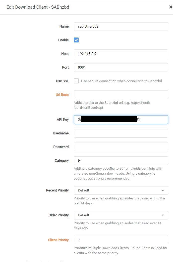

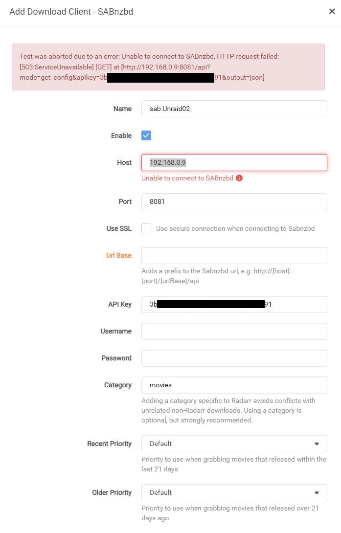

I am moving all my download-stuff from a windows server to unraid containers, but I am having some problems with Radarr. I am using binhex for Radarr, Sonarr and sabnzb. Sonarr works perfectly, and I have configured Radarr in the same way as Sonarr, but I cannot get Radarr to connect to Sab. Any idea what might be wrong?
unraid02-diagnostics-20220722-0346.zipsonarr.thumb.JPG.1c4cf6ea14a6c6dbd9358f3ba555ac57.JPGradarr.thumb.JPG.125d39c240548cd88c84ab0436a9ad49.JPG
unraid02-diagnostics-20220722-0346.zip 178.3 kB · 0 downloads sonarr.thumb.JPG.1c4cf6ea14a6c6dbd9358f3ba555ac57.JPGradarr.thumb.JPG.125d39c240548cd88c84ab0436a9ad49.JPG
Looks like changing the network type from bridge mode to host mode did the trick. Not sure why. All three containers were set to use bridge mode, but changing radarr to host mode solved the problem.
that should not be necessary, bridge should work ok, was radarr set to use a custom bridge?.
Both Radarr and Sonarr was set in bridgemode. Worked with Sonarr but not Radarr. Sat both of them in hostmode, and everything worked

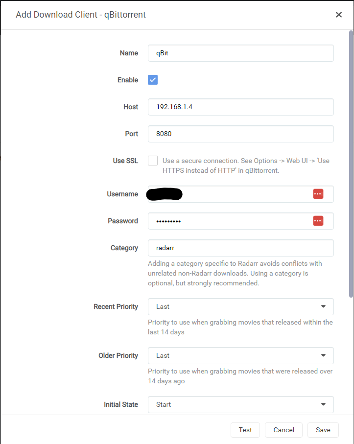

Hello, I am having trouble connecting to qBit as a download client in Radarr (or any other arr, for that matter).
I have radarr running in unraid and it's being routed through binhex-delugevpn (this setup is all working correctly, as far as I can tell).
I have qBit running on a separate windows machine with it's internet traffic running behind NordVPN (the machine is solely used for qBit). Both are connected to my LAN via ethernet.
I can access qBit's WebUI on my browser through the IP:Port (192.168.1.4:8080) just fine and login with my username as password but when I test the connection in Radarr, I get an "Unable to connect to qBittorrent" error. I am not using SSL if that info helps.
I attached what I think are the relevant logs as a .txt.
Unraid_qBit_Error.txt
What settings are you using in Radarr?
For the download client?
