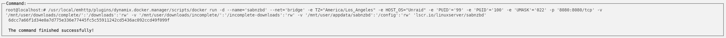

 Post the docker run for your download client. Be sure to redact users and passwords.
Here is the docker run. This started a couple weeks ago after upgrading binhex-sabnzbd and the web gui wouldn't load afterwards. I had to switch to linuxserver's version. Since then the permissions haven't worked.
I had a feeling. The LSIO version of the docker uses /downloads rather than /data in the binhex dockers. That’s not going tho work. You’ll need to change that path so that it’s an exact match for the one configured in Sonarr/Radarr. Host and container paths both.
/data:/mnt/user/downloads/
I’m not very familiar with Sabnzbd but fairly sure you’ll need to reconfigure your download settings in the app to /data also.

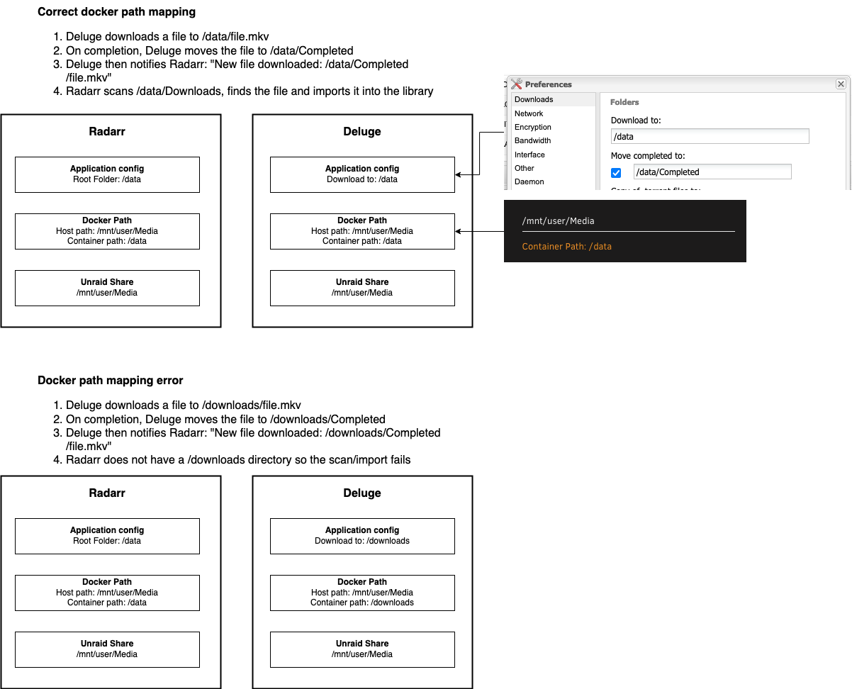

Since the topic of mismatched docker path mappings comes up quite often with Radarr/Sonarr and download clients, maybe this diagram helps to visualize the three levels of folder config and how they interact?
Important to realize is that the application running inside the docker container knows nothing about the Unraid shares. It can ONLY access folders you have specifically added as a container path in the docker config.

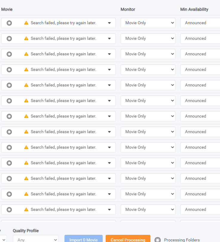

"Search failed, please try again later."
I can't seem to get passed this problem when I try to import my library into Radarr.
Anyone know how to fix this?
radarr.txt
