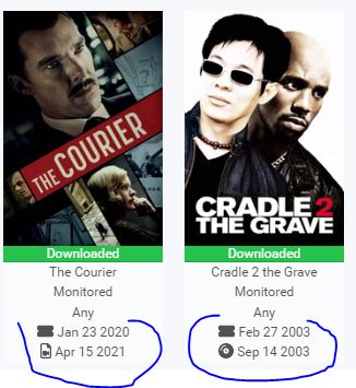

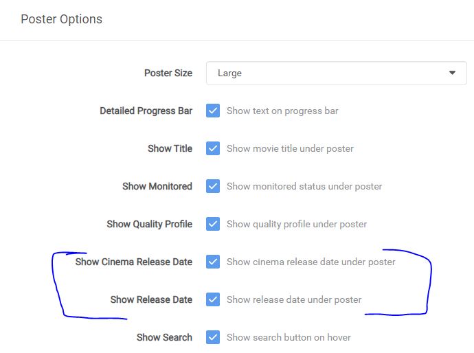

With the lastest update to Radarr "Show Cinema Release Date" and "Show Release Date" does not populate info under the movie thumbnail .
Radarr > Movies > Options > check "Show Cinema Release Date" and "Show Release Date"
The info will not display under images. If I rollback to 4.4.4.7068-1-01 if functions as expected.

Can anyone confirm that this actually functions on the latest binhex/arch-radarr:4.5.2.7388-1-01  ???
"Fixed: (UI) Show studio and release/added dates in movie index" is marked under changes from https://github.com/Radarr/Radarr/releases/tag/v4.5.2.7388
I can confirm that there is NO issue running binhex/arch-radarr:4.4.4.7068-1-01 displaying "Show Cinema Release Date" and "Show Release Date"

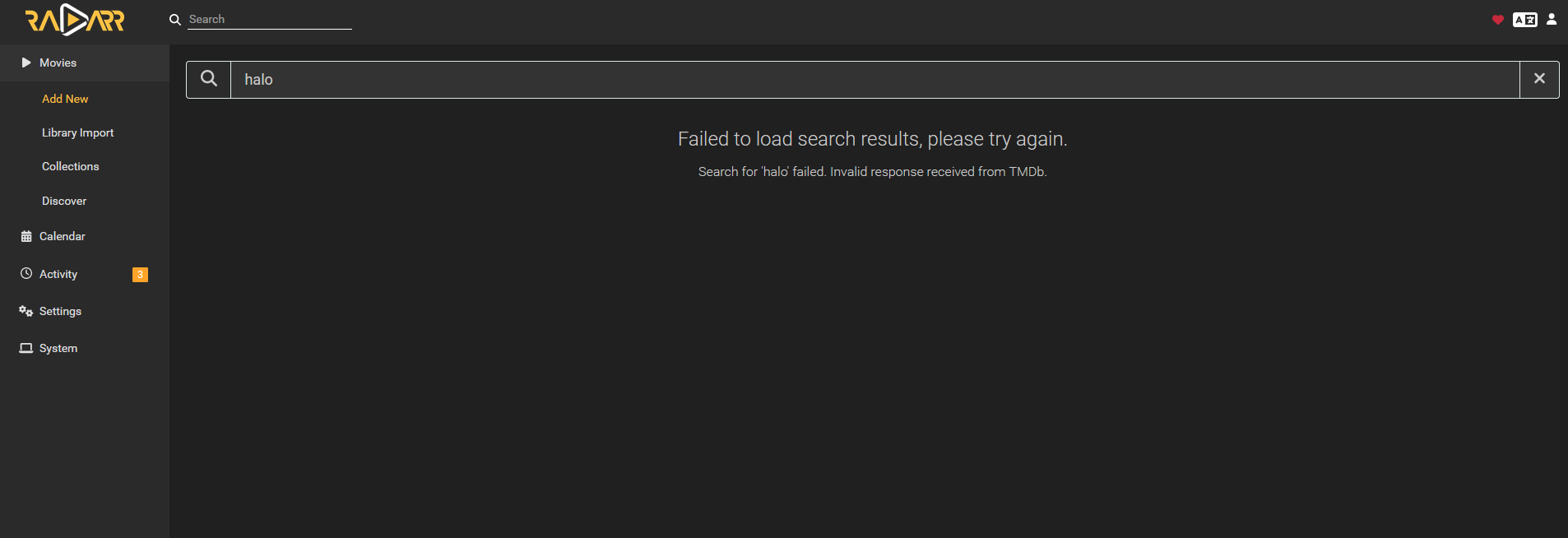

I'm not quite sure this has happened but when Radarr tries to search for something it's getting an error, any ideas?
LOGS:
LOGS:

   at NzbDrone.Common.Http.HttpClient.Get[T](HttpRequest request) in ./Radarr.Common/Http/HttpClient.cs:line 288
   at NzbDrone.Core.MetadataSource.SkyHook.SkyHookProxy.SearchForNewMovie(String title) in ./Radarr.Core/MetadataSource/SkyHook/SkyHookProxy.cs:line 483
   --- End of inner exception stack trace ---
   at NzbDrone.Core.MetadataSource.SkyHook.SkyHookProxy.SearchForNewMovie(String title) in ./Radarr.Core/MetadataSource/SkyHook/SkyHookProxy.cs:line 500
   at lambda_method68(Closure , Object , Object[] )
   at Microsoft.AspNetCore.Mvc.Infrastructure.ActionMethodExecutor.SyncObjectResultExecutor.Execute(IActionResultTypeMapper mapper, ObjectMethodExecutor executor, Object controller, Object[] arguments)
   at Microsoft.AspNetCore.Mvc.Infrastructure.ControllerActionInvoker.InvokeActionMethodAsync()
   at Microsoft.AspNetCore.Mvc.Infrastructure.ControllerActionInvoker.Next(State& next, Scope& scope, Object& state, Boolean& isCompleted)
   at Microsoft.AspNetCore.Mvc.Infrastructure.ControllerActionInvoker.InvokeNextActionFilterAsync()
--- End of stack trace from previous location ---
   at Microsoft.AspNetCore.Mvc.Infrastructure.ControllerActionInvoker.Rethrow(ActionExecutedContextSealed context)
   at Microsoft.AspNetCore.Mvc.Infrastructure.ControllerActionInvoker.InvokeInnerFilterAsync()
   at Microsoft.AspNetCore.Mvc.Infrastructure.ResourceInvoker.<InvokeFilterPipelineAsync>g__Awaited|20_0(ResourceInvoker invoker, Task lastTask, State next, Scope scope, Object state, Boolean isCompleted)
   at Microsoft.AspNetCore.Mvc.Infrastructure.ResourceInvoker.<InvokeAsync>g__Awaited|17_0(ResourceInvoker invoker, Task task, IDisposable scope)
   at Microsoft.AspNetCore.Routing.EndpointMiddleware.<Invoke>g__AwaitRequestTask|6_0(Endpoint endpoint, Task requestTask, ILogger logger)
   at Radarr.Http.Middleware.BufferingMiddleware.InvokeAsync(HttpContext context) in ./Radarr.Http/Middleware/BufferingMiddleware.cs:line 27
   at Radarr.Http.Middleware.IfModifiedMiddleware.InvokeAsync(HttpContext context) in ./Radarr.Http/Middleware/IfModifiedMiddleware.cs:line 40
   at Radarr.Http.Middleware.CacheHeaderMiddleware.InvokeAsync(HttpContext context) in ./Radarr.Http/Middleware/CacheHeaderMiddleware.cs:line 32
   at Radarr.Http.Middleware.StartingUpMiddleware.InvokeAsync(HttpContext context) in ./Radarr.Http/Middleware/StartingUpMiddleware.cs:line 37
   at Radarr.Http.Middleware.UrlBaseMiddleware.InvokeAsync(HttpContext context) in ./Radarr.Http/Middleware/UrlBaseMiddleware.cs:line 26
   at Radarr.Http.Middleware.VersionMiddleware.InvokeAsync(HttpContext context) in ./Radarr.Http/Middleware/VersionMiddleware.cs:line 28
   at Microsoft.AspNetCore.ResponseCompression.ResponseCompressionMiddleware.InvokeCore(HttpContext context)
   at Microsoft.AspNetCore.Authorization.Policy.AuthorizationMiddlewareResultHandler.HandleAsync(RequestDelegate next, HttpContext context, AuthorizationPolicy policy, PolicyAuthorizationResult authorizeResult)
   at Microsoft.AspNetCore.Authorization.AuthorizationMiddleware.Invoke(HttpContext context)
   at Microsoft.AspNetCore.Authentication.AuthenticationMiddleware.Invoke(HttpContext context)
   at Microsoft.AspNetCore.Diagnostics.ExceptionHandlerMiddleware.<Invoke>g__Awaited|6_0(ExceptionHandlerMiddleware middleware, HttpContext context, Task task)
END OF LOGS.
Update: Fix this issue by turning off "Ad Blocking" on Unifi Firewall.

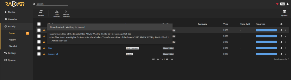

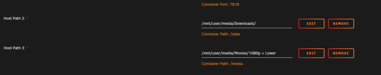

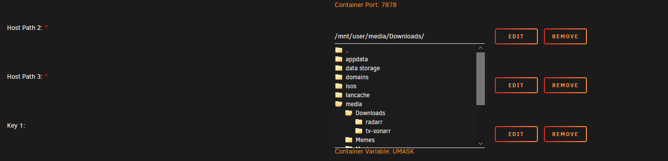

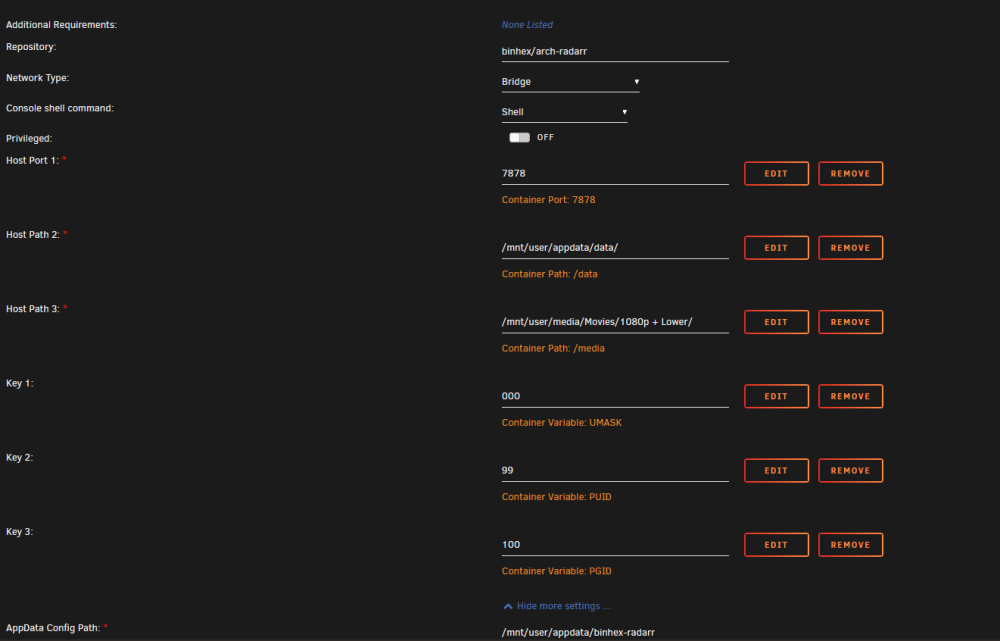

Hi, my Radarr docker can't seem to see any files inside of the downloads folder to import them as it should has anyone experianced this before?
image.png.15b276e54b9d0993186efd3257161f94.pngimage.png.36b96e1ab63e8e1c327199e871a76589.png
Any suggestions/ help would be much appticiated.
In Radarr docker /data should be the download location not the appdata location. This also must exactly match the path in your download client (host and container).
Example:
Radarr-
/data:/mnt/user/downloads/
qbittorrentvpn-
If you want to use /data:/mnt/user/appdata/data/ for your downloads then you’ll need to create this same host and container path in your download client.
Example:
Radarr-
qbittorrentvpn-

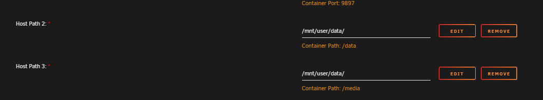

So like this?
1 hour ago, ArxKnight said:
So like this?
Looks ok. The container path will be /data. Same container and host path in both dockers that way when the download client tells Radarr that the download is in /data/etc/etc Radarr will also have access to the same path and know where the download is.

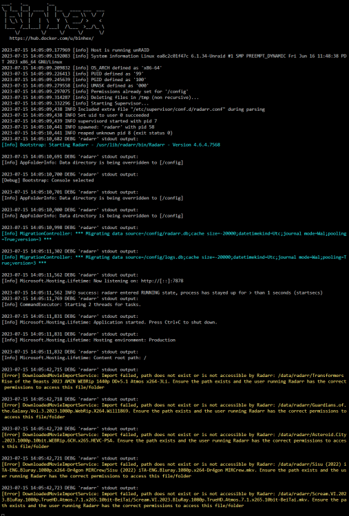

Not sure if this was due to the latest update.. but my Radarr won't connect to SabNZBD.  It says its connecting in the settings but every search for NZB shows 0KB file sizes.  I've verified that SAB itself can connect.  The only errors i see in the log are:
2023-07-18 11:47:55,793 DEBG 'radarr' stdout output:
[Error] DownloadedMovieImportService: Import failed, path does not exist or is not accessible by Radarr:
Its possible i'm just not finding anything but its a strange one, dont remember it ever finding things on Sab but all are 0KB
