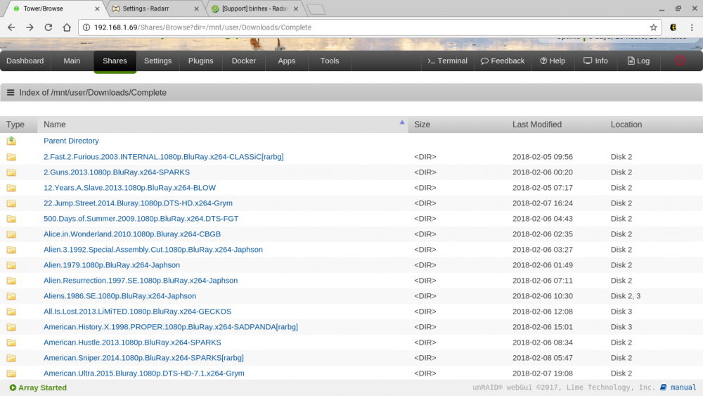

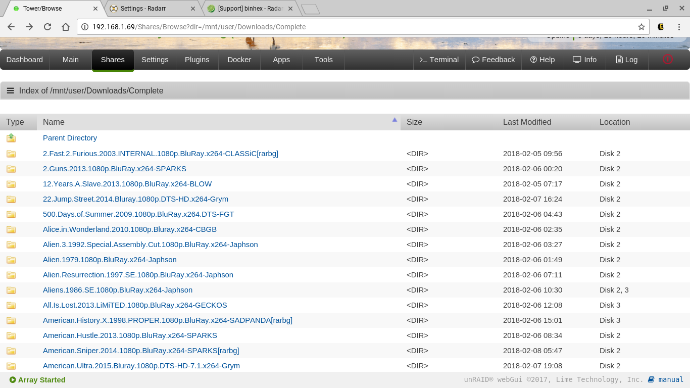

I'm sure this is just something dumb that I am missing, a button not clicked somewhere or something. But I have looked through it for a bit and can't seem to figure it out.
Radarr is downloading to "incomplete" folder via deluge
When DL is finished, it moves it to "complete" folder via deluge setting
Radarr is then renaming to the correct format, and placing in my media->movies folder (or, I guess mover is actually moving them?)
The problem lies in the fact that it doesn't seem to just be renaming and moving the file, it seems to be copying and renaming, leaving the original file in the "complete" folder.
Like I said, I am sure I just missed a setting somewhere to delete this, or possibly I am messing it up by removing the torrent from deluge when the completed ones start to pile up. Or, maybe it is copying the file and renaming due to the fact that the original is seeding at that point? Just a couple ideas, none of which I am certain how to solve. Can anyone point me in the right direction? Don't want to mess with the settings and mess something else up. :)
Edited by jebusfreek666

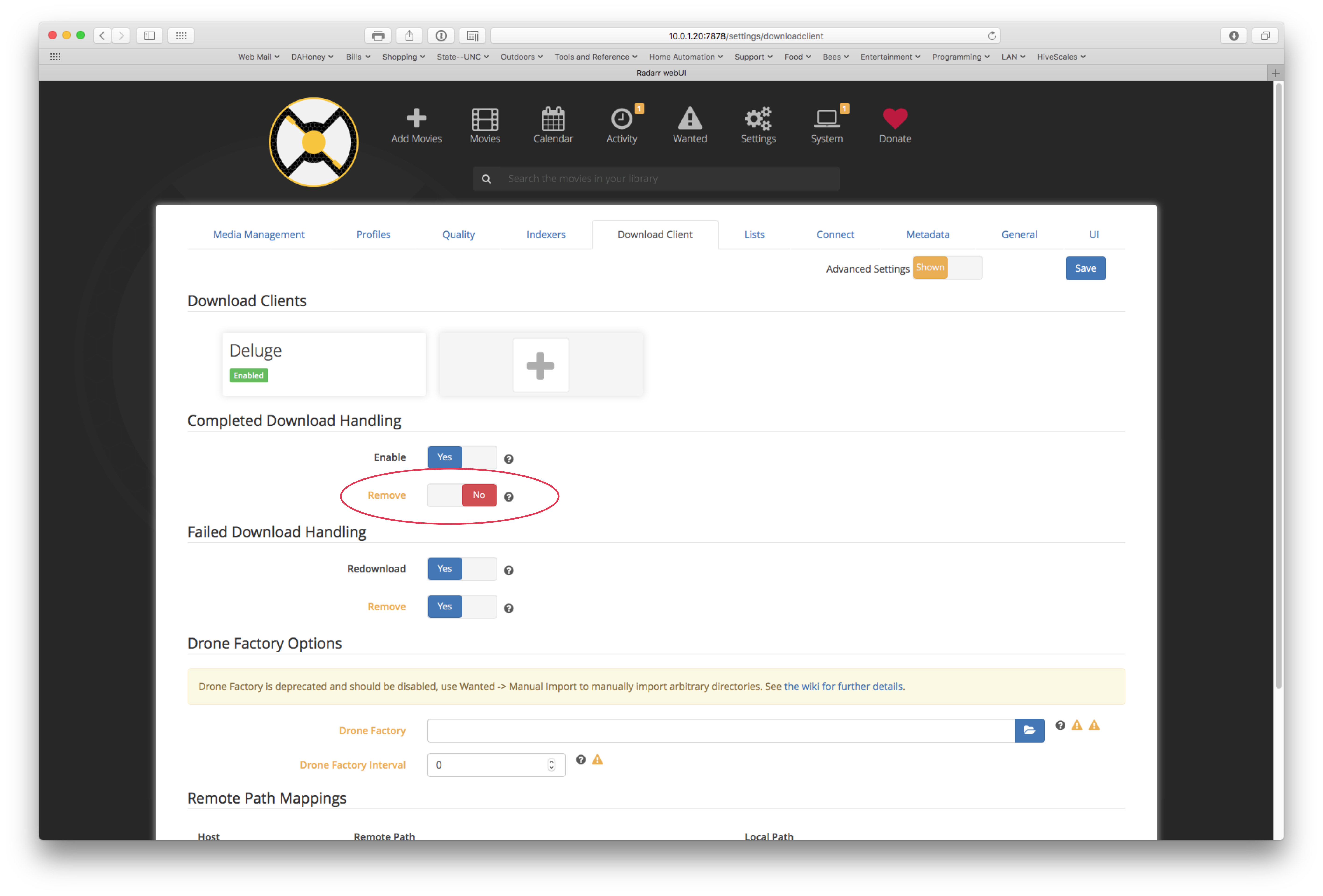

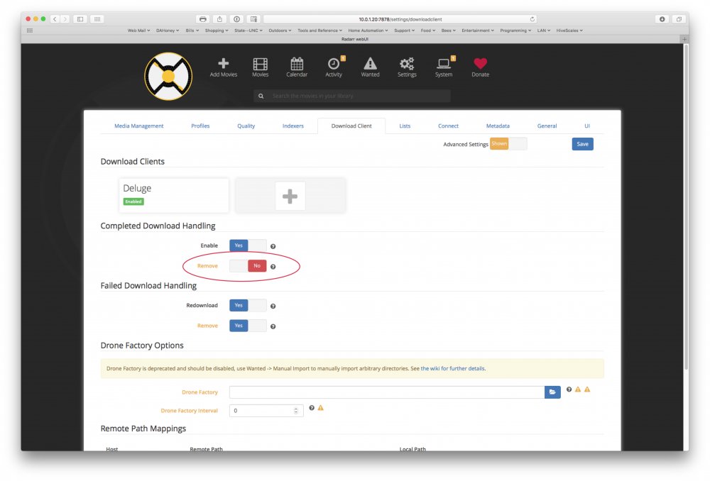

You have the option in settings to select either copy or move in your download handling.
Edit: Sorry, that’s wrong. It’s in the download client section-
Edited by wgstarks
Wonderful. I will check it when I get home. Thanks again!

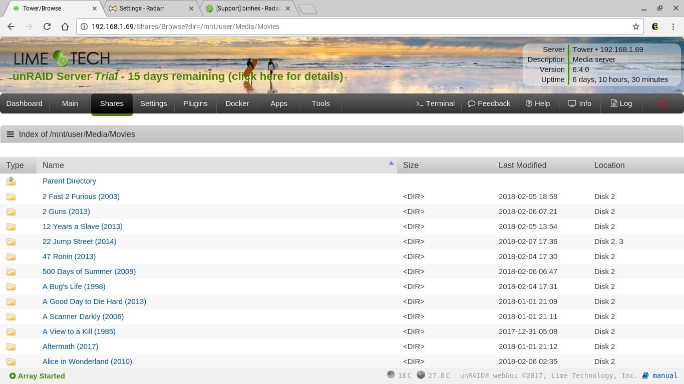

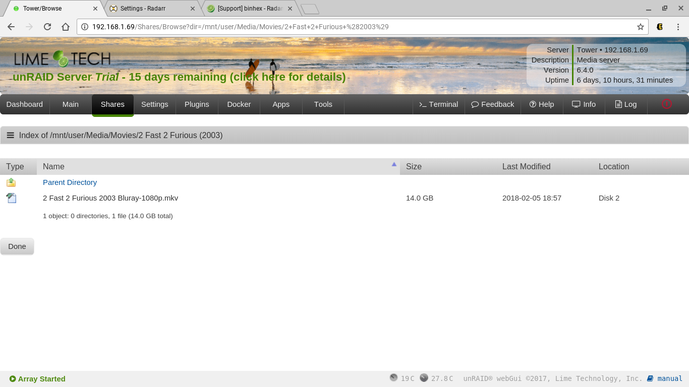

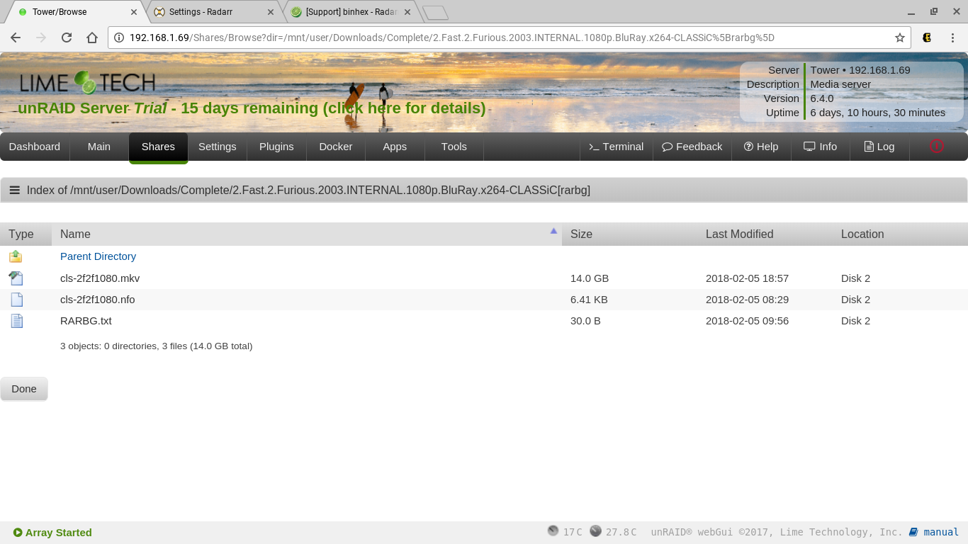

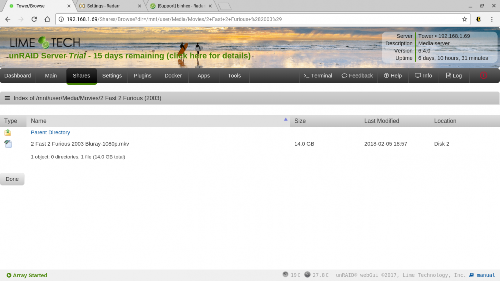

Ok, So now I think what is really happening is that it is creating hardlinks with the files original name. Here is what I am seeing:
As you can see, in my media share everything is renamed correctly and placed in the correct place. But in my downloads share, it still remains with the downloaded torrent name. Both say they are on disk 2. Both are the "same size". my understanding is that they both point to the same file, but only use up the stated 14Gb once. The issue comes in that I want to clean up the download folder. How do I get rid of these? Can I just delete them? If so, how to I do this? Is it as simple as navigating to mnt/download/completed and deleting everything in there or will this mess something else up? Also, do I change the option from hardlink to copy, and then just manually delete the second copy periodically? I originally left this option on because it said it may not be able to move/rename if it wasn't on. Which would create a different problem....
more info

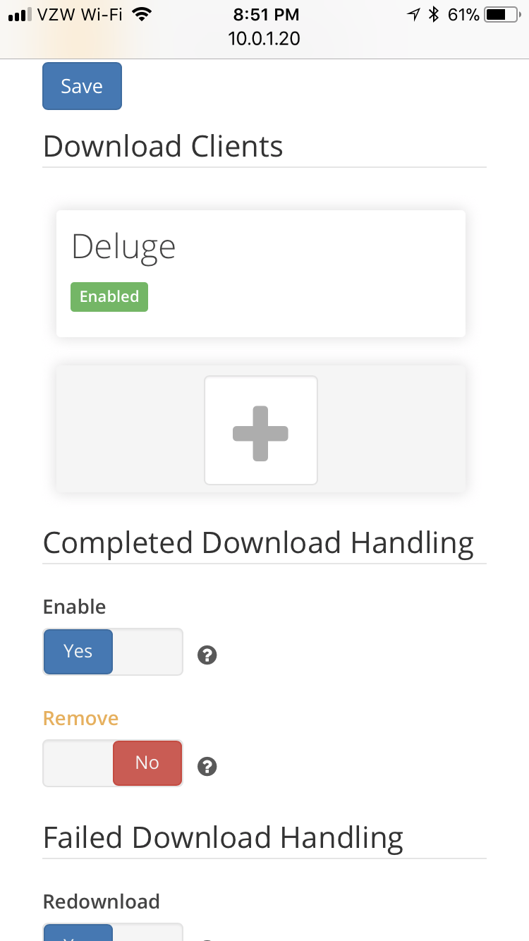

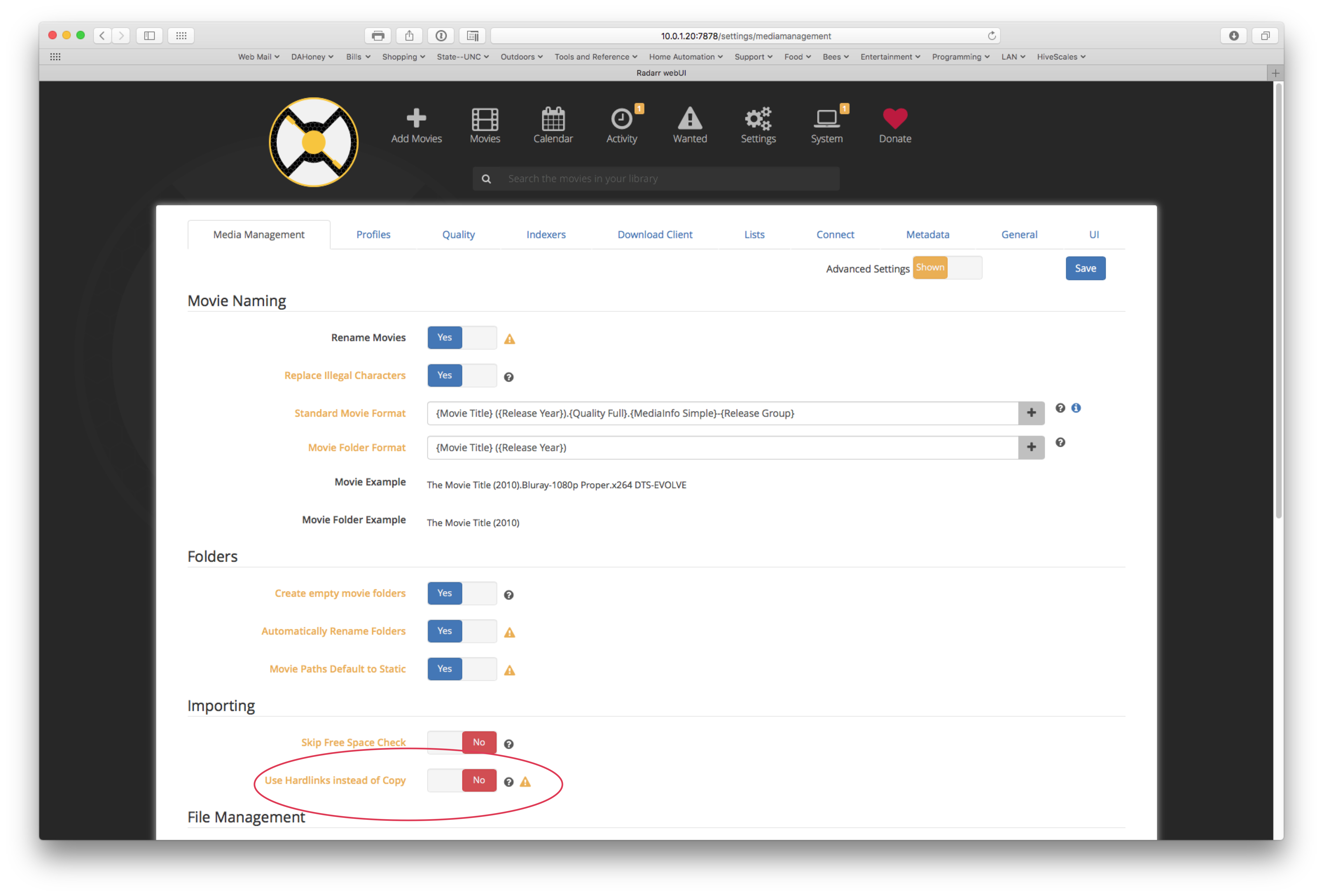

You don't mention you're settings, but I think what you need is this-
Be sure that "Use Hard Links Instead Of Copy" is set to NO.
Also, "Remove Completed Downloads" must be set to YES (don't copy my setting).
Will that remove the hard links that are already there from previous downloads, or will I have to go manually to the share mnt/downloads/completed and just delete everything there?
My settings currently in download client are the same as the pic above, except I have completed download handling "remove" set to yes. And for media management I have rename folders, and hard links set to yes. All others set to no from the picture above.
Ok, so you'll want to set hard links to "NO". My GUESS is that this will only effect future downloads. You'll need to test this probably and possibly fix the problem manually.
Since this is really an app issue (not the docker itself) I'd also recommend posting your question on the Radarr forum. You might find much more informed info there.
