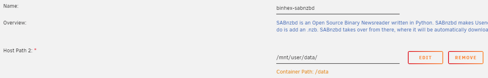

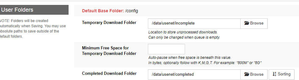

Hi Folks
Would one of you legends be able to tell me how I fix this error in Radarr?
I can't get my head around these paths and I have been going around in circles for a while now and I can't figure out which one that I am supposed to change and to what.
I though it was as per the Trash guide but clearly I am doing something wrong. Here is what i have in SABnzdb:
Thanks in advance...
32 minutes ago, Exsol said:
Hi Folks
Have a read of Q2 here first to get a basic understanding of bind mounts:- https://github.com/binhex/documentation/blob/master/docker/faq/general.md
Once you have read that then move onto Q4 to get the paths correct:- https://github.com/binhex/documentation/blob/master/docker/faq/unraid.md

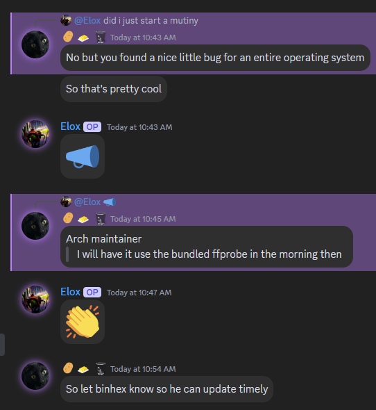

Appears there was an issue with the all the arch arr's not getting the custom ffprob. I reported an issue and was told there should be an update being pushed by the morning.
super dooper!, no need to 'let me know' though as everything is automated on my side ;-)
