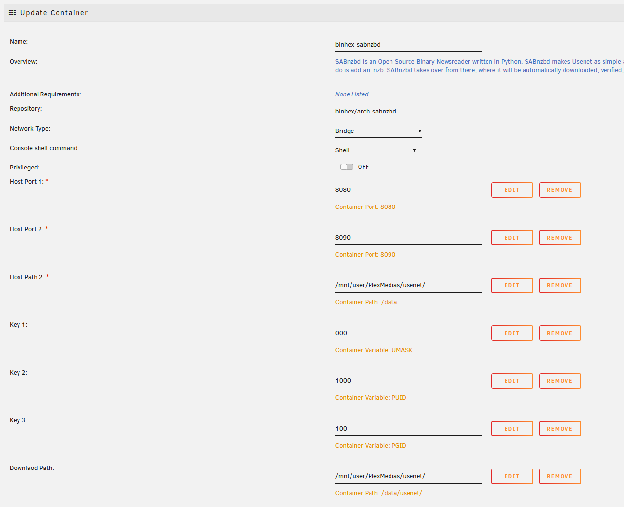

The thing is: in SABnzbd, I have the following mapping:
/data <--> /mnt/user/appdata/data
/data/usenet/ <--> /mnt/user/PlexMedias/usenet/
/config <--> /mnt/user/appdata/binhex-sabnzbd
and in the Folder configuration WebUI page of SABnzbd, I have the following setting:
Temporary Downloads: /data/usenet/incomplete
Completed Download: /data/usenet/complete

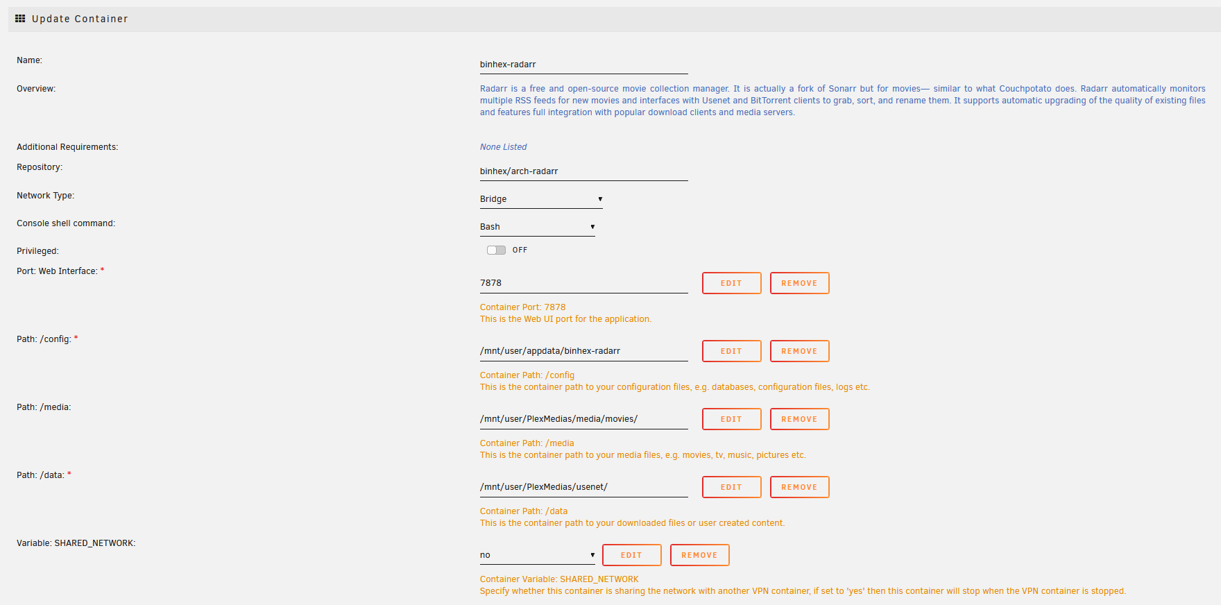

For radarr, I have the following mapping:
/config <--> /mnt/user/appdata/binhex-radarr
/media <--> /mnt/user/PlexMedias/
/data <--> /mnt/user/PlexMedias/usenet/
So I don't understand why radarr is referring to the /mnt/user/appdata/data/Films folder. Where is he taking this information from?

@wgstarks thank you for your help!
I have made some changes in the dockers configs:
radarr:
Path Media : Container Path : /media <--> /mnt/user/PlexMedias/media/ (supposed to be the folder where media are stored ultimately and where the Plex Server librairies will be looking into)
Path Data : Container Path : /data <--> /mnt/user/PlexMedias/usenet/ (supposed to be the download folder or SABnzbd, right?)
SABnzbd:
Host Path 2 - Container path : /data <--> /mnt/user/PlexMedias/usenet/ (I am a bit confused here: is it supposed to be the folder where SABnzbd is copying the files once the download is complete? In this folder I have the subfolders /complete and /incomplete)
Download Path: Container Path : /data/usenet/ <--> /mnt/user/PlexMedias/usenet/

So, here are the container settings page for SABnzbd:
and then the container settings page for radarr:

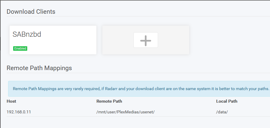

and the remote path settings in the radarr Download client page:
I don't understand why in the Health page, Radarr keeps referring to the "data/usenet/complete/movies" folder when nowhere in my settings I have this path configured.
Everything happens in the the share /PlexMedias/ that I have created to store all my files for Plex.

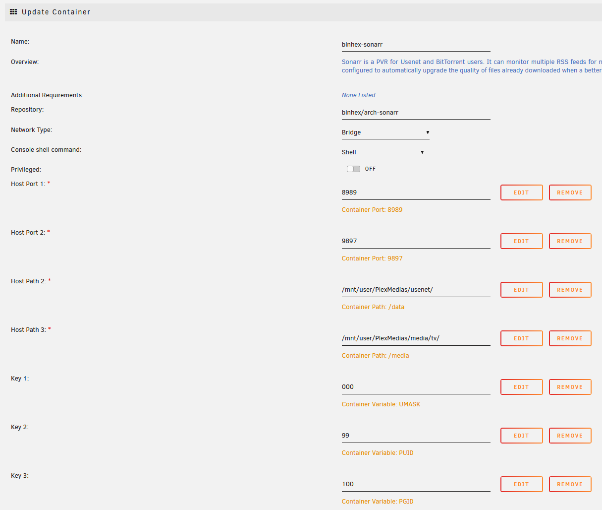

Now, I have to solve an issue with Sonarr:
Health page says:
The container settings:

36 minutes ago, Valyno said:
@wgstarks thanks again for your help.
In SAB settings for completed downloads, I have /data/usenet/complete
Is that the wrong setting ?
I am confused with the parameters that we are setting in the container setting page...
With your settings Sab will notify Radarr that a file has completed downloading and is located in /data/usenet/complete. Radarr will look in /data/usenet/complete and hopefully see the file. Depending on your settings for Radarr>Settings>Media Management the file will get moved, hardlinked, renamed, etc. It sounds like you may have Radarr settings misconfigured. Post the errors you are seeing in Radarr.
3 minutes ago, Valyno said:
Any idea how to solve this one?
Is there a /mnt/user/PlexMedias/usenet/tv directory?
@wgstarks our message crossed each other: Radarr problem is solved and it is now working properly, thank you !
I have the following folder: /mnt/user/PlexMedias/usenet/ complete/tv where SAB is storing the completed downloads
and I have the folder /mnt/user/PlexMedias/media/tv where I store the TV shows for plex to read from.
What do you have set for root folders in Sonarr? Sonarr>Settings>Media Management. Bottom of the page. Be sure to set “show advanced”.
I have this:
Is it for downlaod or for media library to monitor?
I have this:
It should be /media I believe.
Delete it and run the health check again.
Done, error still present.
Then replaced by media, error still present, but another error (yellow one) disappeared instantly
I would post in the Sonarr forum. You really shouldn’t need root paths.
