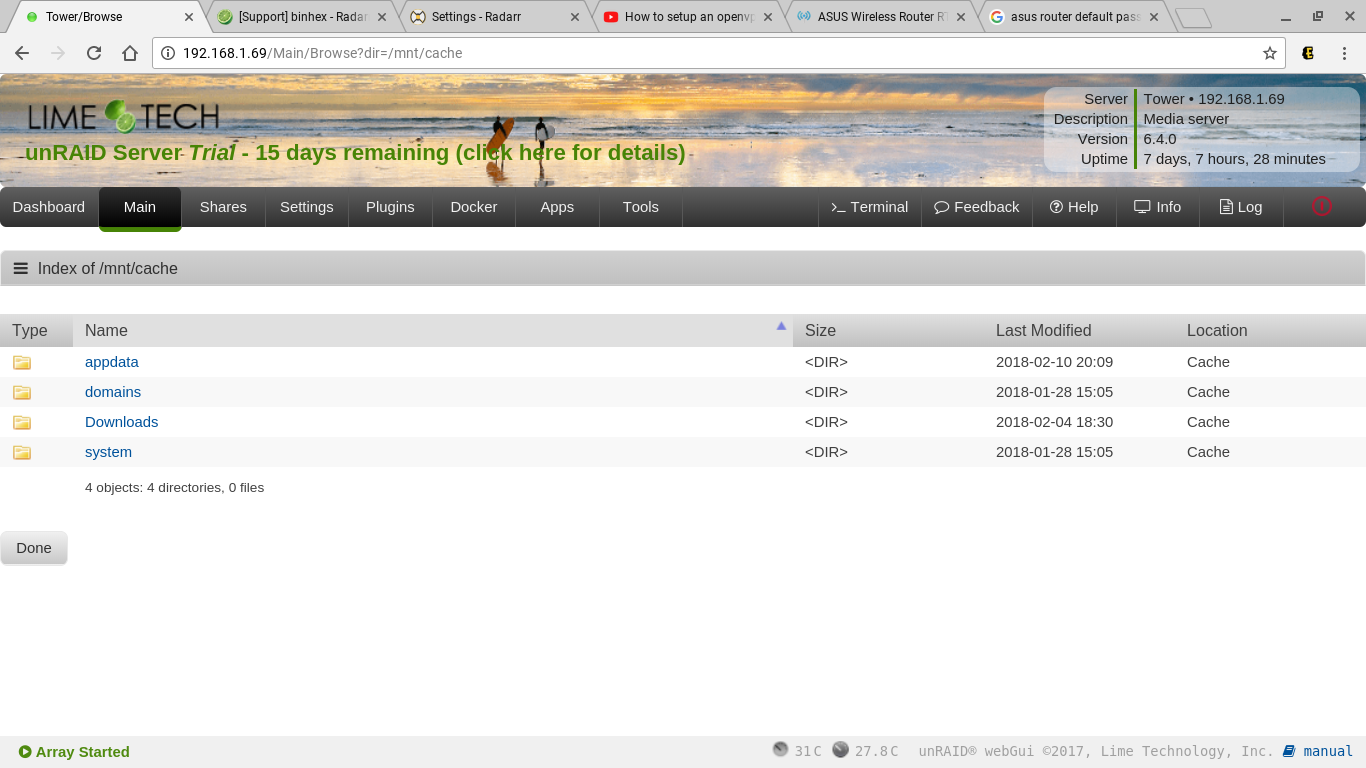

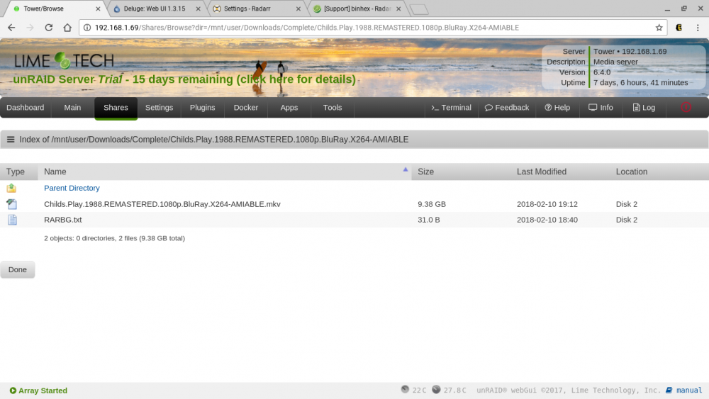

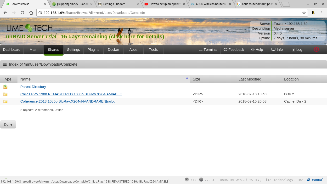

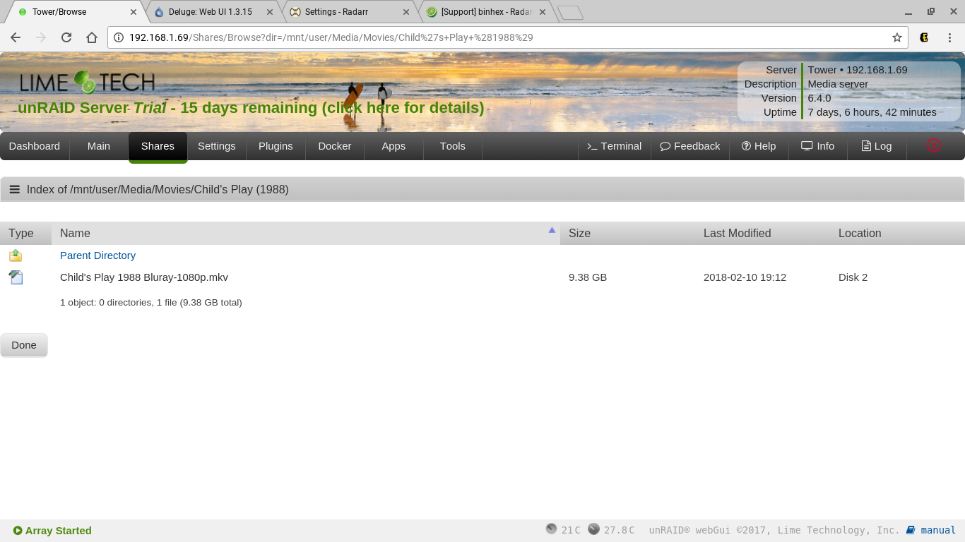

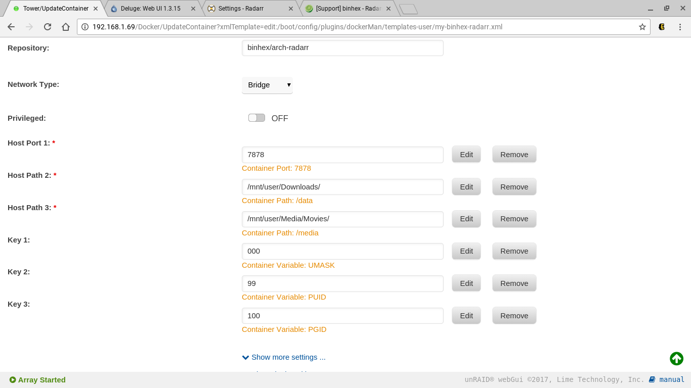

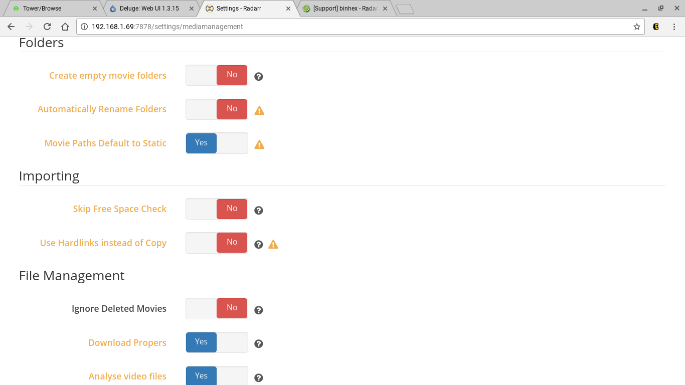

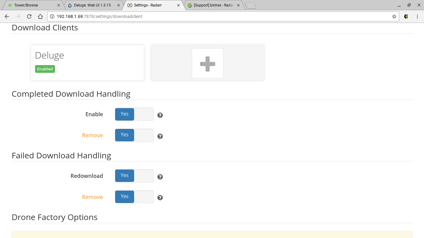

Ok, so I am definitely still doing something wrong here. I turned hard links off, but everything still looks the same. It still is making a copy, renaming it, but leaving the original until I delete it. It is also leaving it on the deluge list after finishing downloading. On top of that, I am not sure what the point of a cache drive is. I thought it was supposed to DL to my cache, then have mover put it where it is supposed to go in the middle of the night. Instead, it seem as though it is renaming and moving it immediately, and also moving the original to the same disk? Am I just reading this wrong?

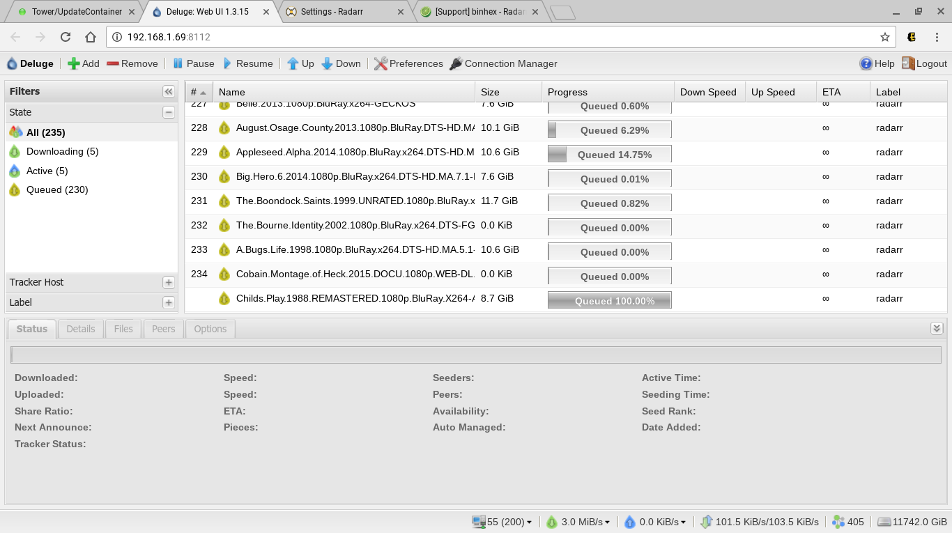

Is this a torrent? Searching the Radarr forum shows other posts regarding this issue. It looks like the minimum seed ratio must be met for torrents before they are deleted.
You haven’t posted any screenshots of the contents of your cache drive so I can’t say if it is being used or not. /mnt/user/Downloads and /mnt/user/Media are both user shares. If they are both configured to use the same disks and also cache then both copies will get moved to the same disk but different shares(assuming neither share is “cache only”). What are you seeing that makes you think cache isn’t working?
The reason for using cache for your downloads is that it is not parity protected so writes will be much faster. Any disk mounted with Unassigned Devices would work just as well.
Yes, it is a torrent. so the seed ratio makes sense (although, i don't really understand seed ratios yet). In screenshot 3 and 4 above, it states that both files (original and renamed) are both on disk 2. That is what is making me think that it is not on the cache. Sometimes it says it is on the cache, and an array disk. Why would it be on both? Shouldn't it sit on cache until 3:30 am, and then mover take it from cache to the array?
The Download share is set to use cache, but the Media share is not.

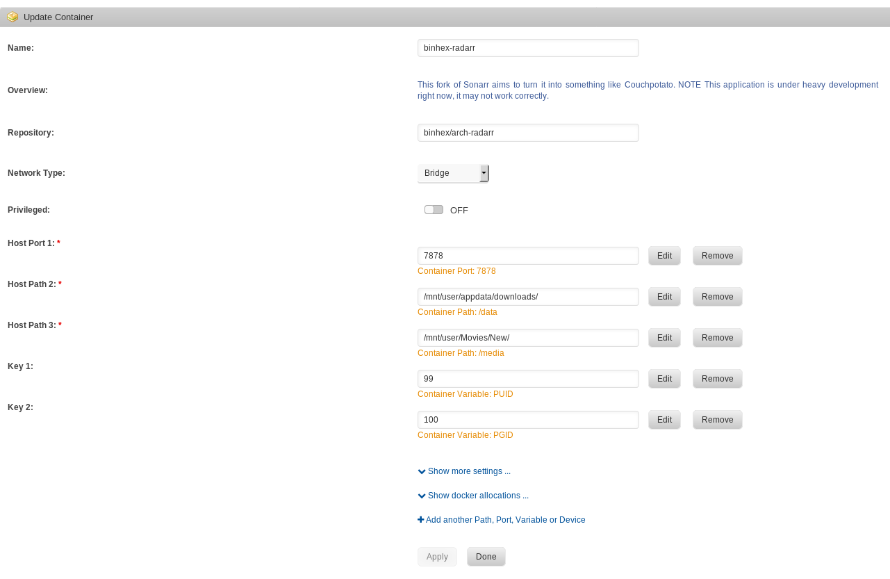

The default path as downloaded is prepopulated at /data, that's fine, but why is it reverting to that and not using the previously updated and currently used value on edit?
It doesn't do that on other binhex dockers.
5ae26c7e08dec_radarrdockerscreen.thumb.png.42ee90c4afff239e39304d729bdc57a6.png5ae26c8a9bfb4_radarrdockerupdate.thumb.png.724dd831e9c460a210a26441861cc412.png
I just added my own custom path as /downloads rather than editing the profile path name. No reason at all that won’t work I should think!?
Sure, that works, I want to know why it's behaving like this when none of the other dockers I have installed change arbitrarily when you click edit.
If it happens to someone who doesn't have a firm grasp on docker mappings and such, it would become a support issue.
