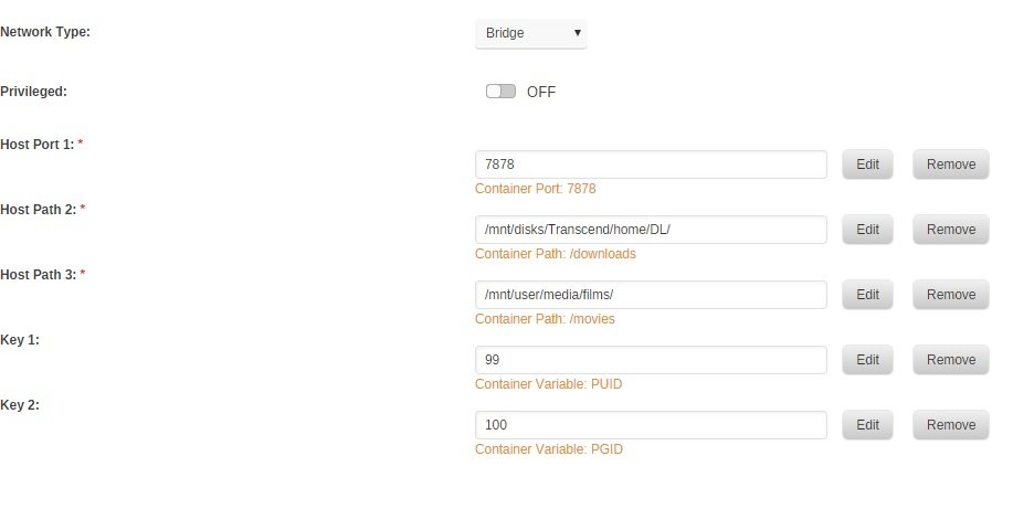

the settings are attached
regards
what is your volume mapping for /config? you may need to click on show more settings and/or enable "advanced view" to see it.
edit - just to confirm i pulled down the latest docker image, created container and started it, and i can access the web ui, so there are no issues with the current docker image.
Edited by binhex

one thing to note, i noticed you have a very non standard option on one of your volume mappings, namely the 'slave' option, snippet:-
/mnt/disks/Transcend/home/DL/':'/data':'rw,slave'
im guessing you are using unassigned devices plugin and somewhere along the line you were told to use this option?, just try removing ',slave' and try to create the container again.

4 hours ago, binhex said:
i can only assume from this that you either:-
1. have a corrupt docker image - remove the docker image (leave the container, then re-pull the docker image down again)
or
2. you have a corrupt docker loopback image - stop docker (unraid web ui/plugins/docker) and then remove the docker img file and re-create it - this will of course mean you will loose all containers and images, but you can easily restore these using either CA or clicking and select the 'my' templates from the list when clicking on 'Add container'.
if i run the above command with paths modified only on my local machine i get a successful start:-
docker run -d --name='binhex-radarr' --net='bridge' -e TZ="Europe/Paris" -e HOST_OS="unRAID" -e 'UMASK'='000' -e 'PUID'='0' -e 'PGID'='0' -p '7878:7878/tcp' -v '/tmp/':'/data':'rw' -v '/tmp/':'/media':'rw' -v '/tmp':'/config':'rw' 'binhex/arch-radarr'
3d5ef2e639ea7ed77f0cddd84dde7f0f14c23292cf3cb5bbe055183bbb7c062a
docker ps
CONTAINER ID        IMAGE                COMMAND                  CREATED             STATUS              PORTS                    NAMES
3d5ef2e639ea        binhex/arch-radarr   "/usr/bin/tini -- /b…"   20 seconds ago      Up 18 seconds       0.0.0.0:7878->7878/tcp   binhex-radarr
Hi binhex, I already tried removing the docker image, it did'nt do the trick :(
So I tried option 2 remove everything and it's working :)
So back to normal thanks a lot for your support
best regards

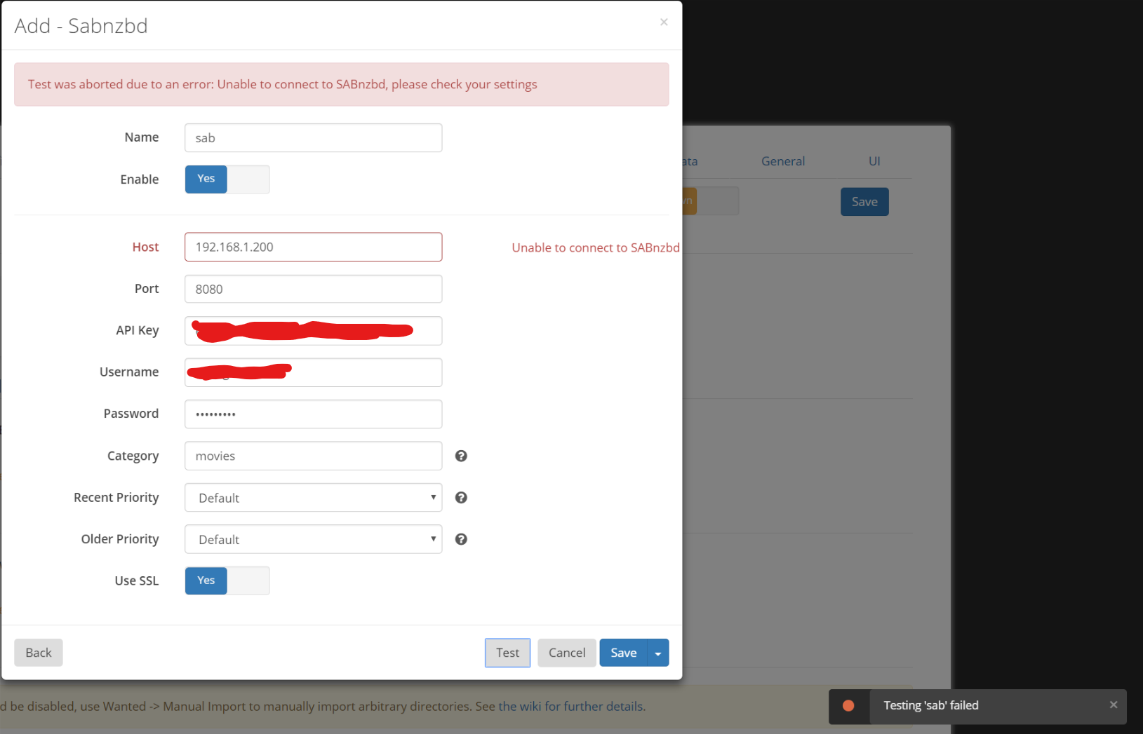

For some reason, I cannot add sabnzbd to radarr as a download client. The test fails and it won't let me save the config.  The weird thing is I went through and set this up just fine with sonarr. When I setup sabnzbd in sonarr it was all working perfectly: testing was successful, and downloads were being sent from sonarr to sab. The problems occurred when I went to add sab to radarr. The test has never succeeded and I am using the same settings. Also since I have gone back to check if I did something wrong sonarr now fails the test as well. I generated a new API key but that made no difference. Does anybody have any ideas about what this could be? Screenshot attached.

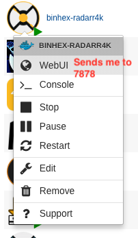

I run two instances of Radarr to keep 4k movies in their own instance. I run the 4k instance on port 7979. It works well except that the WebUI link on the main docker page sends me to the 7878 server. I've updated the WebUI setting in the docker advanced settings to http://[IP]:[PORT:7979]/ but this docker ignores it. I tested changing this setting on some of my other dockers and it works. Running 6.5.3.
