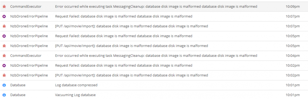

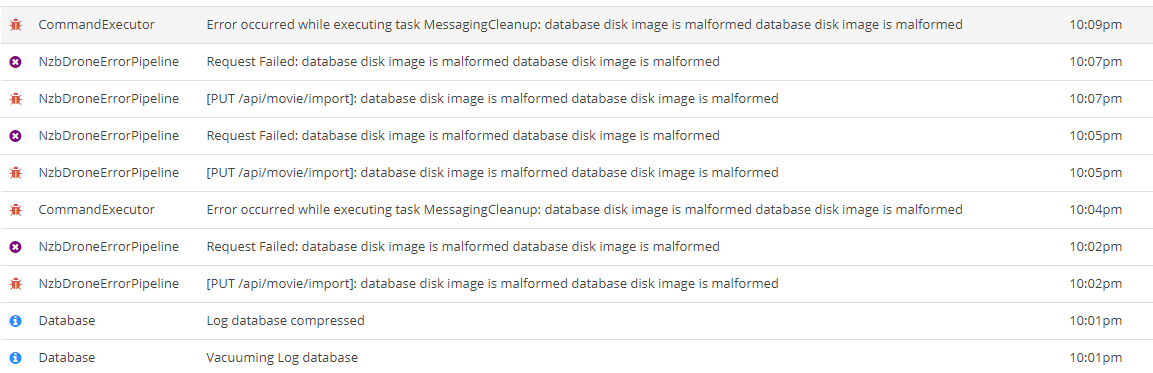

I keep getting 'Error occurred while executing task MessagingCleanup: database disk image is malformed database disk image is malformed'
I even do a fresh install and still the same issue about 15 mins later it's on a SSD
Edited by Ladrek
i bet you are suffering the infamous FUSE bug, see Q16. in the following link:-
https://forums.unraid.net/topic/44108-support-binhex-general/?tab=comments#comment-433612

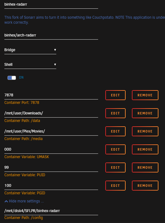

On 4/25/2019 at 8:08 PM, Ladrek said:
i've done that already
anyone?
