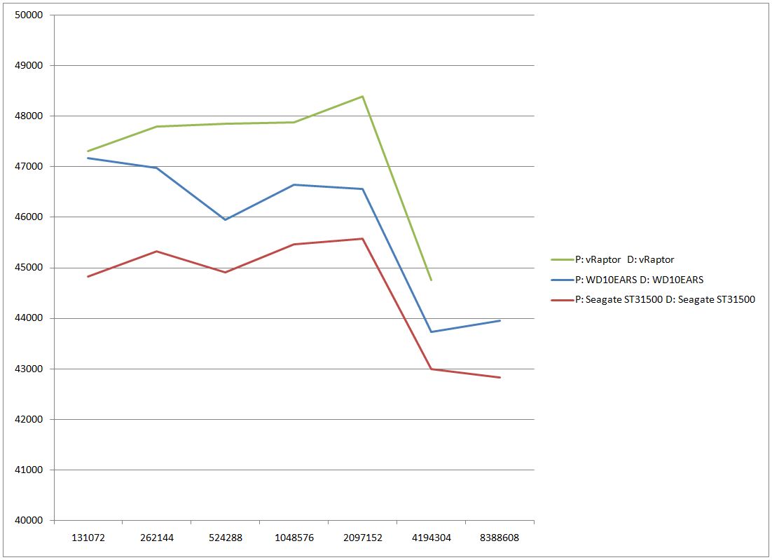

Although this is not a huge performance difference, I thought a RAID 0 stripe set of the cheaper 30GB SSDs would give me maximum cache drive performance with minimum power consumption (0.2W Idle) and enough capacity to move my largest files around.
Here is a graph that shows the read performance among several hard drives that range from 80MB/s to 110MB/s on the exact same system (the i3-530 platform).  This is over the wire performance.  Since the cache drive is not impacted by the "parity penalty", I would expect cache performance to scale similarly.
Note that the Seagate ST31500 already had the fastest part of the drive filled, so it was operating at a performance penalty to the other two which were empty.
Vertical Axis is kB/s, Horizontal Axis is File Size in MB (131MB - 8GB).

I don't believe we are measuring things in the same way.  With large file sizes (for example, 8GB files), I have never seen 23MB/s writes exceeded even with VelociRaptor drives acting as Parity and Data (it was only a test rig).  The same system with vRaptors produce around 44MB/s continuous read.  This is without a cache drive.
I measure with the free IOzone test program using this command line from my Windows 7 desktop:
iozone -Rab RESULTSFILENAME.xls -i 0 -i 1 -+u -f \\tower\disk1\filetest -y 64k -q 64k -n 64k -g 8G -z
This is a non-destructive test that accurately measures your true read and write transfer rate without OS buffers, etc.
