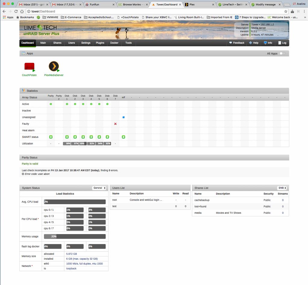

I woke up to plex client not seeing the server.  Everything looked ok.  I thought the docker was corrupt and so I deleted it and recreated it and reinstalled the apps.  Still no good.  I then rebooted the server and disk 7 was unmountable.  I took it out of the array and brought it back up because my thought was to replace the unmountable drive but the apps still aren't able to access the data and couchpotato won't start at all.  I know the data is there because I can play it directly from the share.  Also, it still stays parity is valid too.

I am also adding images of the dashboard and Main screen.

as an update, it looks like i lost some data.  I got plex to load soem content but couchpotato still won't start.  Some of the movies are showing up as unavailable because they aren't there.  They might all be on drive 7.  I haven't formatted the drive and there aren't any smart errors on it so I guess I could use it if I could somehow clear the errors but I am not sure how to proceed.
First, most of your disks show an abnormal number of CRC errors, you have a lot of bad sata cables or some other issue causing them, start by replacing those cables and monitoring those attributes, any increase of 2 or more means there's still a problem.
This is the attribute to monitor:
199 UDMA_CRC_Error_Count    0x003e   200   197   000    Old_age   Always       -       119
Emulated disk7 (md7) needs a file system check:
https://lime-technology.com/wiki/index.php/Check_Disk_Filesystems#Drives_formatted_with_XFS
If after the check everything looks good you can then rebuild it to the old or new disk.
