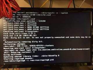

When I boot in safe mode, it appears to hang at rcsyslogd initialization.  See attached screenshot.  Configuration files are in the attached zip files.
Archive.zip
shares.zip
