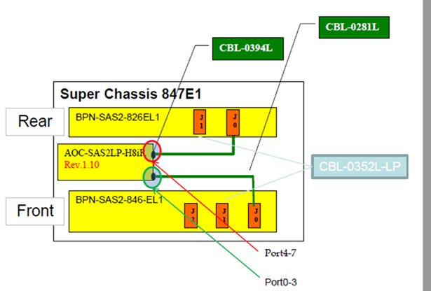

The thing is if I get another HBA I am not sure how to connect it, the rear backplane has two connectors and the front backplane has three. I may email Supermicro tech support and ask them.
Do you know the exact model of the front backplane to see if supports dual link?
No I've emailed Supermicro tech support. The did send me this image with part numbers, I googled it but couldn't come up with anything.
Supermicro manual is not very clear but from what I could find it does support dual link.
https://forums.servethehome.com/index.php?threads/playing-with-my-sas-expander.7420/
The HBA needs to support it as well, I know the SASLP and the LSI9211-8i (H310/M1015) support it because I tested those, but never tested the SAS2LP and can't find anything about it on the net, you can try it or I may test mine when I get the chance.
