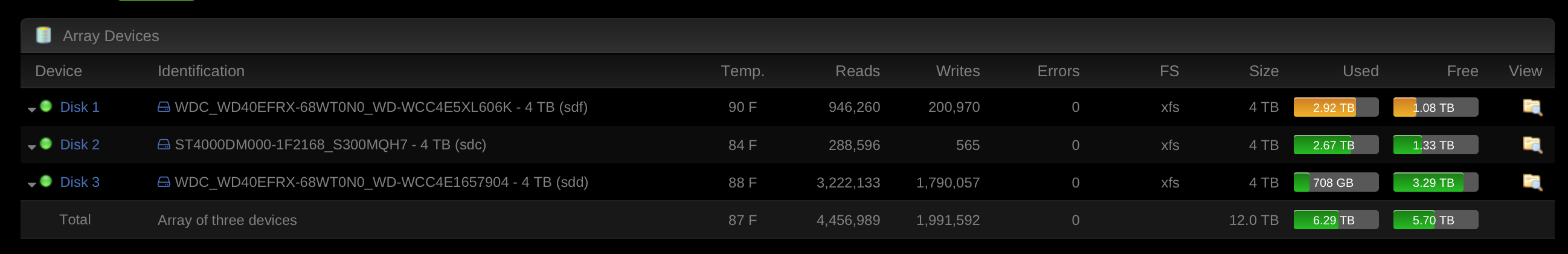

Ok, I am a bit worried to do this. I do not want to lose the data on my disks 1 & 3. here is my array devices. and here is the options I have in new config. How do I proceed so that I do not lose my data. Thank you.
Retain none is fine. The other options are there just to make it remember some or all of your assignments so you won't have so much reassigning to do if you have a large number of disks. You can still change them before starting.
You probably want to keep 606K as disk1, assign MQH7 to parity, assign 7904 as disk2. Don't check the box saying parity is already valid, since building parity is the whole point of your changes. Then it should say Start will build parity or something like that. Post another screenshot if you are unsure.
