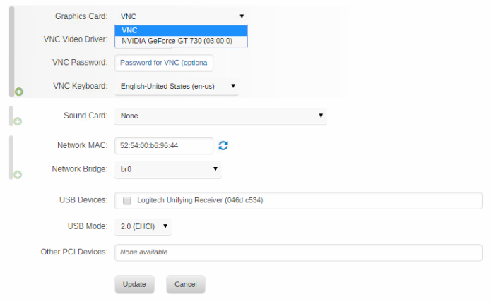

Got my VM up and running via vnc.  Went to select graphics card and hit apply and my screen just flashes and says it has no signal.  Have to stop the VM and restore back to vnc.  Trying to get it to work.  Any help?
Had to force stop to change back to VNC.  Put all my settings back and now I am stuck trying to boot from cd.  If i press nothing it just goes to the shell.  How can I get it back without loosing all my info?

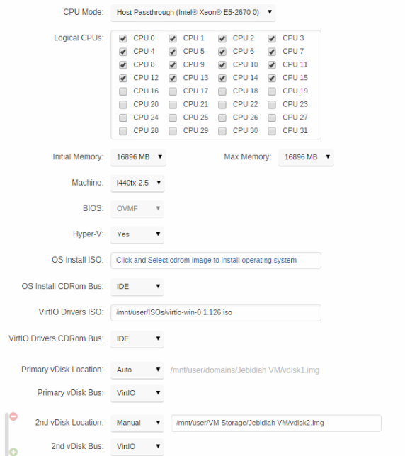

VM_XML_Script.txt

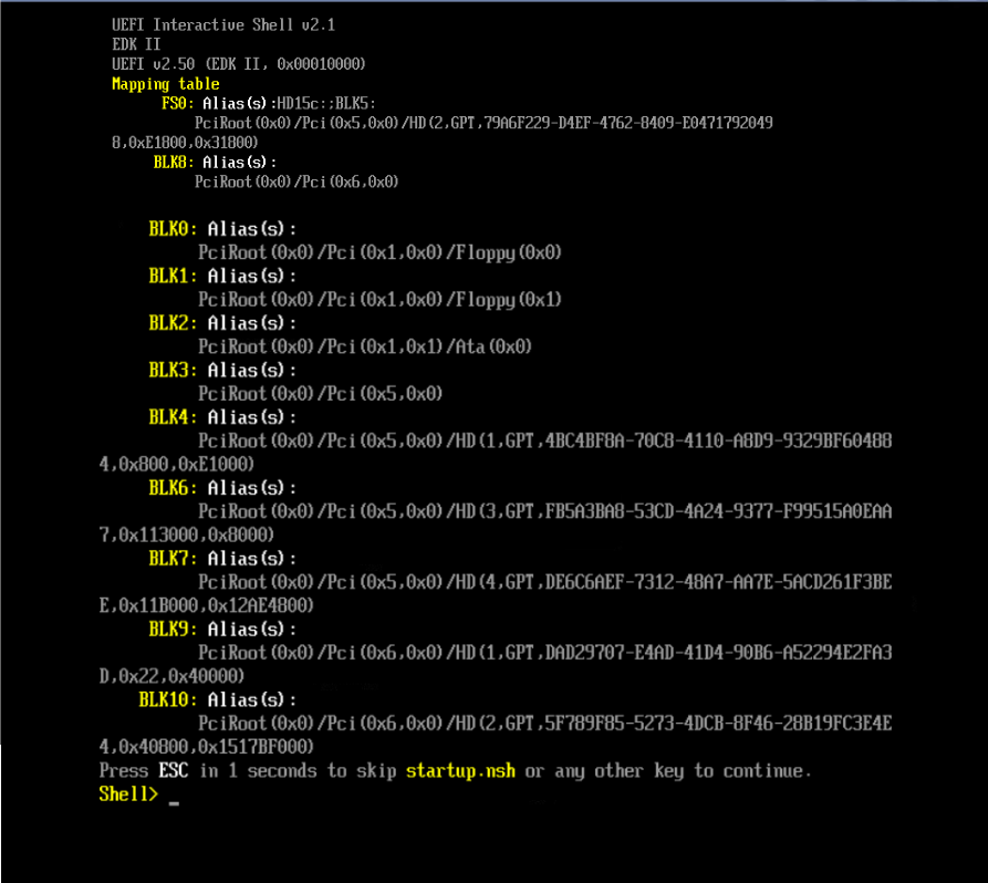

I'll find out tonight....  I still cant boot into my VM as it just keeps going to shell....  I may just have to reinstall the VM and see if that helps.  No idea how to get it to boot after that force stop
Did you try this:
fs0:
cd boot
cd efi
bootx64.efi
You could also type exit and it should take you to the bios and you could choose your boot device.
Just updated to unraid server pro 6.2.4
Just tried
FS0:
get FS0:\>
cd Boot
get cd: Directory not found - 'FS0:\boot'
cd efi
get FS0:\efi\>
dir
get
BOOT
cd Boot
get FS0:\efi\boot\>
dir
BOOTx64.EFI
Bootx64.efi
Press any key to boot from Cd or DVD......
get FS0:\efi\boot\>
exit
Bios boot option menu
EFI DVD/CDROM
EFI Internal Shell
Nothing else.

Your 730 may not support EFI boot so you may have to install a machine with seabios  (if i remember correctly older evga cards seemed to lack the EFI rom necessary, however, some vendors released updates for their cards)
What I am confused at with you problem is.
1. Are you getting any display from the 730 when used as a second card?
2. the picture you posted of it stuck at the EFI boot screen what output is that from (vnc or your 730)
3. is your problem now the card or the fact you cant boot the VM past the EFI boot screen?

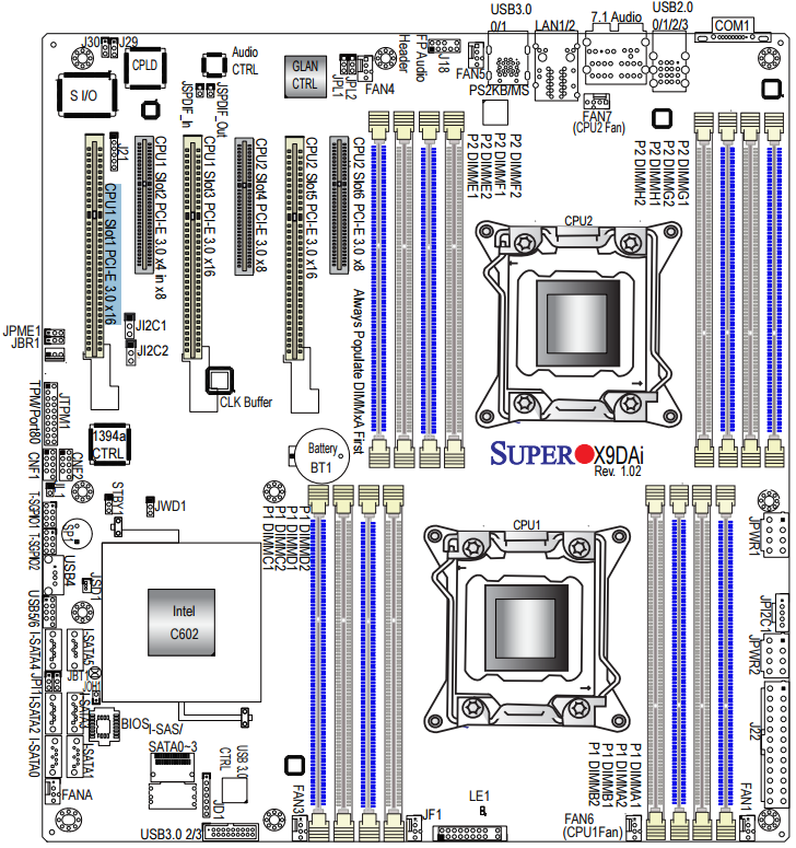

So when I originally built this I had apparently plugged the 730 in slot
CPU1 slot3 PCI-E 3.0 x 16
I purchased a cheap EVGA GeForce 210 Passive 1024MB DDR3 (01G-P3-1313-KR) last night and installed it in slot
CPU2 SLOT5 PCI-E 3.0 x 16
