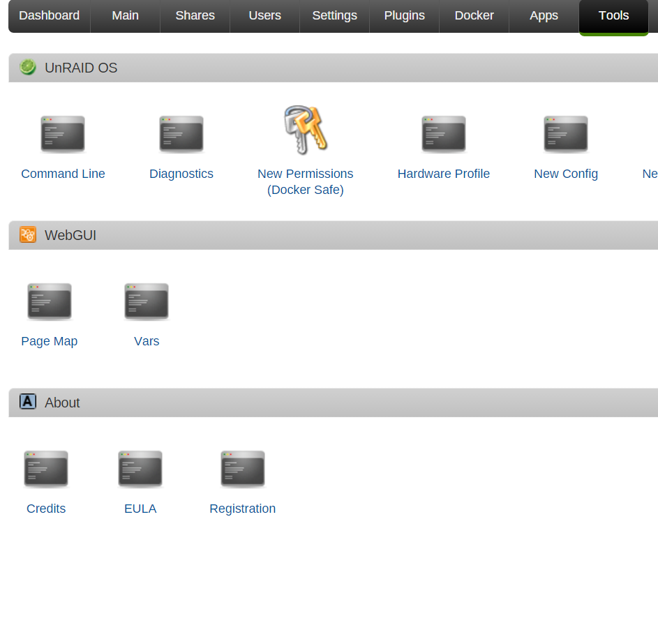

It seems as though my system information has gone blank. Any tips to get it reset?

Just to add, i noticed some errors in the GUI when I installed and configured the System Stats plugin. Even though the gui errors went away eventually, ever since the errors the system information has been missing. Not sure if its the cause just coincidence.

yes i tried from multiple browsers. Something else that's interesting that leads me to believe that system stats did something to the default unraid installation.. when I remove system stats, the "System Information" section of the Tools tab is removed! Maybe i should be posting on the system information support thread?

Yes sir. My guess is that System stats replaced the source code of the tools page by way of a patch, which broke the system information section. When it's installed, system information is there but blank. When i remove the system stats plugin, system information is missing.
My bad, it was a missing plugin. Nothing to see here :)
