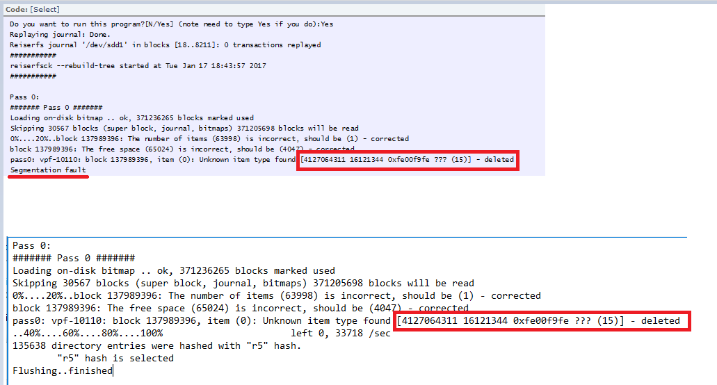

Will rebuild the filesystem (/dev/sdd1) tree
Will put log info to 'stdout'
Do you want to run this program?[N/Yes] (note need to type Yes if you do):Yes
Replaying journal: Done.
Reiserfs journal '/dev/sdd1' in blocks [18..8211]: 0 transactions replayed
reiserfsck --rebuild-tree started at Tue Jan 17 18:43:57 2017
Pass 0:
####### Pass 0 #######
Loading on-disk bitmap .. ok, 371236265 blocks marked used
Skipping 30567 blocks (super block, journal, bitmaps) 371205698 blocks will be read
0%....20%..block 137989396: The number of items (63998) is incorrect, should be (1) - corrected
block 137989396: The free space (65024) is incorrect, should be (4047) - corrected
pass0: vpf-10110: block 137989396, item (0): Unknown item type found [4127064311 16121344 0xfe00f9fe  (15)] - deleted
Segmentation fault

johnny-black..... that did it, at least I hope!  80% done and still going.  Lucky for me, i hadn't upgraded my 2nd rig to 6.3.x quite yet.  I wanted to test for awhile on my 1st one and glad I did since you referenced something called reiserfsprogs.  What is that?  I have an idea, but i want to know for sure.  Ran --rebuild-tree on 2nd rig and its going strong.
