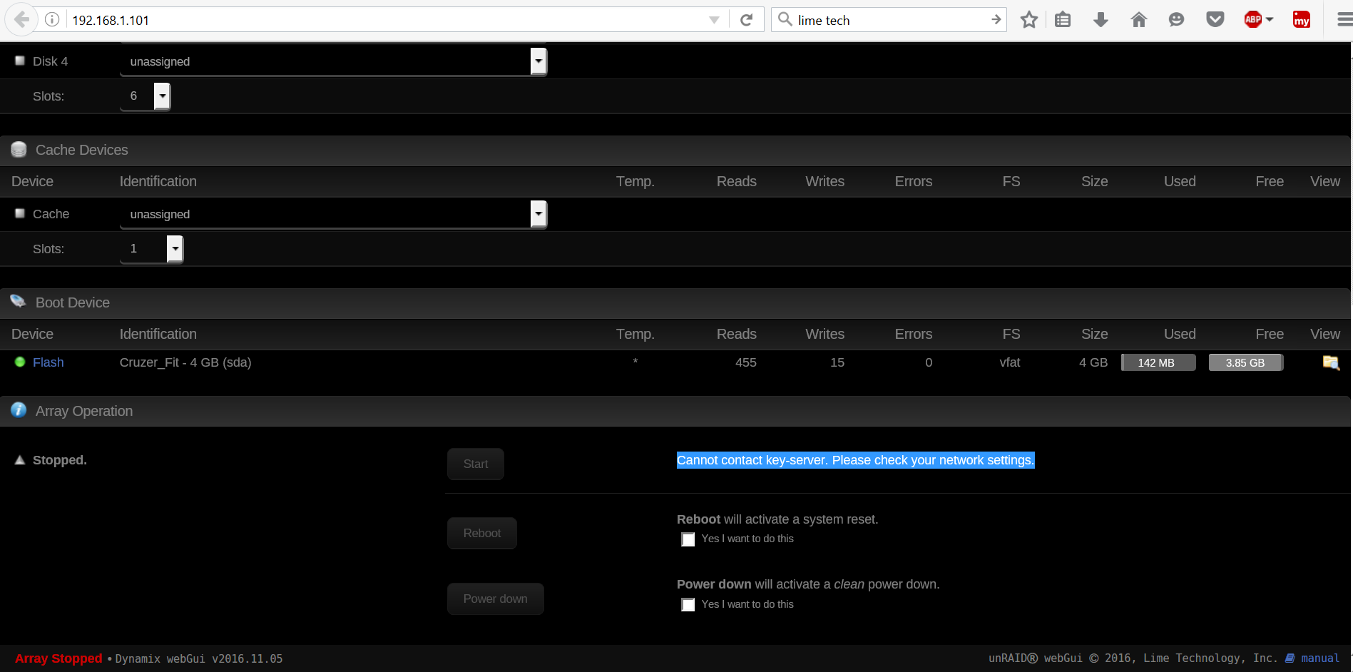

I just tried to recreate the issue , This time web Gui worked fine but I was still unable to use it error below. This time issue was I was not able to start the disk array. Is that may be because I am in trial period. Could you confirm if buy a license it will work without internet as well.
Also attached the screenshot of the same.
error : Cannot contact key-server. Please check your network settings.
Screenshot attached
Trial requires Internet connection, at least to start the server.
Thank you for your response. That makes sense.
