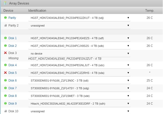

It's even worse than I thought...  On Palmwood, I have one errored drive and one missing (see attachments).
I can't see anything bad in the SMART reports on all nine drives, so I'm really confused.
Russell

But on Palmwood, I was able to get a little difference:  Now Disk 3 (ZUT) is green, but Used/Free space shows "Unmountable" and Disk 5 (RHS) as "Not Installed."  Palmwood is making some shares available.
Hoping for some advice.  Do I dare try to do some emergency backup?  (These systems were supposed to be backup to each other - I have offsite backup too, but it isn't complete.)
Shutting down both systems as I wait for advice.  :)
Russell
Disks dropped offline on both servers, upload new diagnostics for zurlo also after the reboot so we can see all the SMART reports.
For Palmwood:
Disk5 needs a new SATA cable, almost certainly the reason it dropped offline and got disable:
199 UDMA_CRC_Error_Count    0x000a   053   053   000    Old_age   Always       -       7914732
Disk4 also has abnormal number of CRC errors:
199 UDMA_CRC_Error_Count    0x000a   200   200   000    Old_age   Always       -       116
Other disks also show some errors from 4 or 5 to 50, these are not normal and cable need to be replaced if the attribute increases by 2 or more.
Disk3 is missing, powerdown, check/replace both cables and power back on.
After checking/replacing at least the cables for disk 3 and replacing the SATA cable for disk5 power back on and post new diags.
