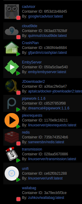

Are you running any VPN servers or similar? Most likely there are something you installed creating those new interfaces. Does the same thing happen if you boot into safe mode and disable docker?
No VPN server on unRAID (I have VPN server on pfSense router, which is completely different machine).
There are 11 dockers on unRAID, from which 6 are always running (see attached picture).
Funny thing is, that additional interfaces are not present after reboot. At this moment unRAID's uptime is 1 day 3 hours and no additional interface is present. Last time uptime was ~6 days.
I tried turning on all dockers and no additional interface appeared.
What about the pipework container? Doesn't it do some network modifications?
Yes, Pipework does some network changes but if I understand correctly, changes are for selected dockers only. In my case dockers Transmission and cloud9ide.
I was using Pipework before and never noticed that behavior.
Fun fact: Using NFS, devices no longer find shares on IP 10.1.0.12, but when 10.1.0.254 appears, they find NFS shares on .254
I don't know how pipework works, but it doesn't hurt to disable it for testing.
