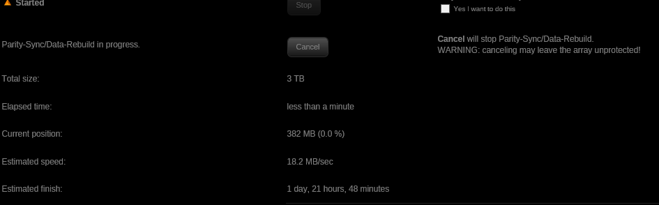

Thank you for the assistance, I took those exact steps and now have the 3TB drive in slot 7 and a Drive rebuild is taking place.
