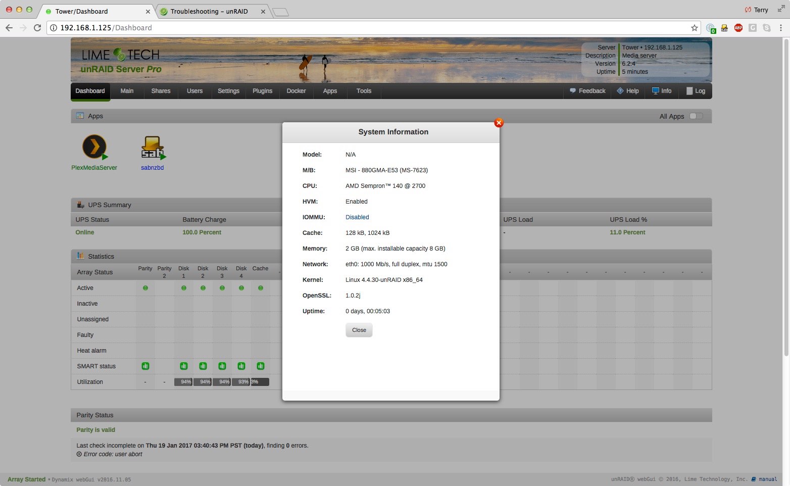

Motherboard: MSI 880-GMA-E53 (MS-7623) - upgraded to latest BIOS when the USB drive was not being recognized
CPU: AMD Sempron 140 (with only 1 core right now, did not bother unlocking the second until things start working correctly)
RAM - 2GB
Gigabit ethernet

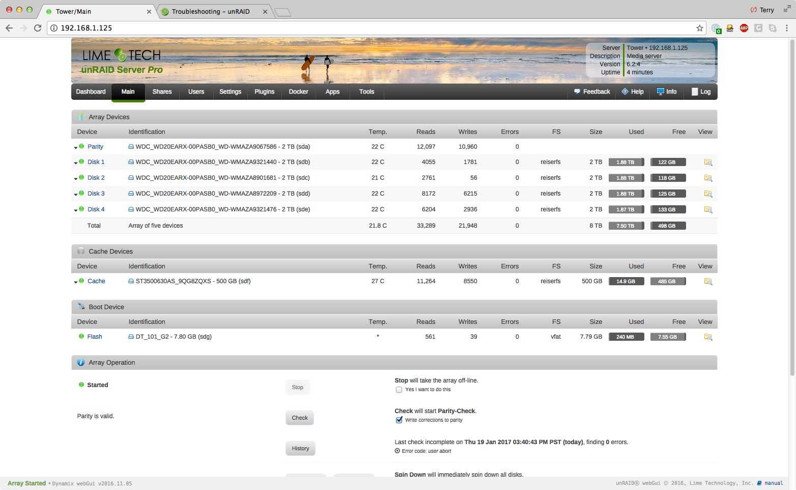

HDDs 5x 2.0TB WD EARX (1 parity, 4 data)
Cache 500GB

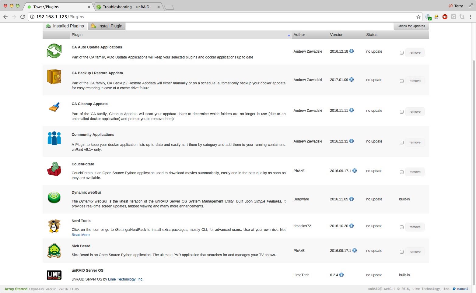

Plugins:
Sickbeard and couchpotato (PHAZE)
Nerd tools (cannot install PERL for some reason...)
See image for additional mostly stock plugins

Attached are some screenshots of the setup, plugins, docker, system info etc as well as a syslog (sorry, cannot capture a syslog once it stops working, this is just after it has booted up, wondering if there is something in there that someone can pick out). Have started a tail
