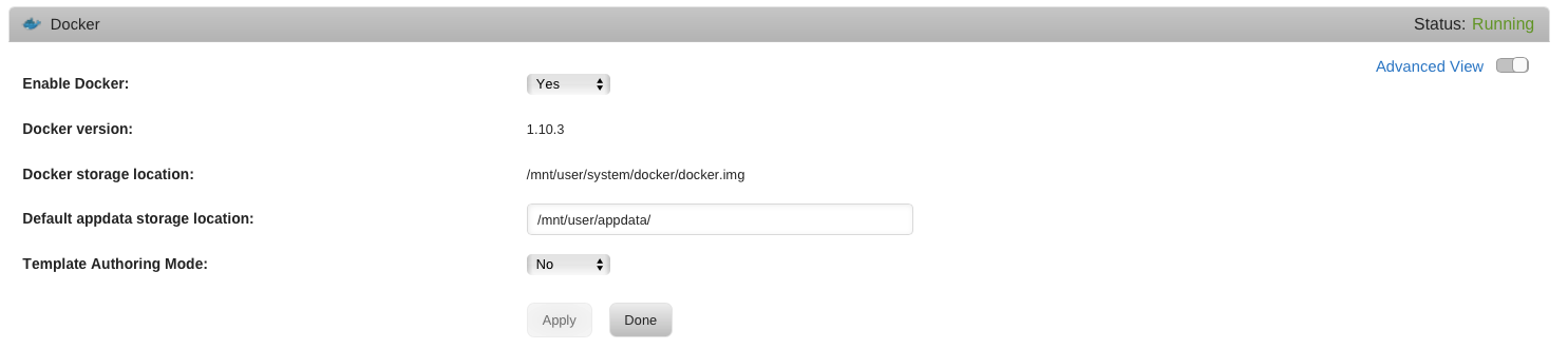

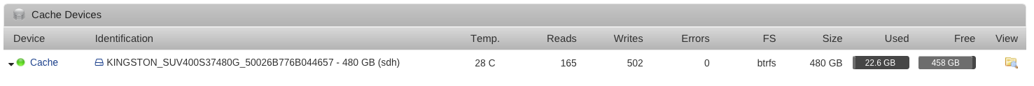

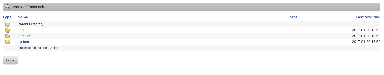

  • So I actually just added an SSD as my cache and completely reinstalled unRAID from square one.  (Right down to re-formatting the boot device and re-downloading the key file.)
  • I have caching turned on in Global Share settings.
  • I see appdata, domains, and system folders on the cache drive.
However, the Docker setup shows appdata at /mnt/user/appdata and the Docker storage location as /mnt/user/system/docker/docker.img
Is there a guide somewhere to switching over to using the cache locations for appdata, Docker images, and VM images?  I can't seem to find the resource I was looking at before.
Thanks!
If you re-installed unRAID it was going to do exactly what you wanted by default - there shouldn't have been a need to change anything.  Since you did... based on your prior posts you didn't want to change the global cache setting for shares.  That will cause every share you create to use the cache drive for write-caching.  Unless you want that, turn it back off.
Take a look at the settings for each individual share by clicking on it in the main window.  That's were you can set a specific share to Use Cache "yes" or "prefer".  You should see that "prefer" was selected for appdata and system by default.  If not, then change it.
You don't need to change any references from /mnt/user/appdata to /mnt/cache/appdata.  They are for all intents and purposes the same thing, with the exception that the /mnt/user reference is going through FUSE and therefore has the intelligence to make use of the cache drive when appropriate.
Alright, so I reset "Use cache disk" to "no" in Global shares settings.
I just checked the system shares and you're right...they're either set to Prefer or Yes for use cache disk (only isos is set to Yes).
I then exported each of these shares and did a test.  Once exported, I wrote to each one using my primary non-root user account from my Mac.  I created a separate folder under each one.
When I ssh'd over using my root account, and look at /mnt/user/appdata for example, I can see the folder I just built there.
When I look at /mnt/cache/appdata, it's not there.  They don't seem to be connected.  Writing to /mnt/user/appdata doesn't seem to affect /mnt/cache/appata.  And, there is no /mnt/cache/isos directory, either.
Am I missing something?
Thanks again.

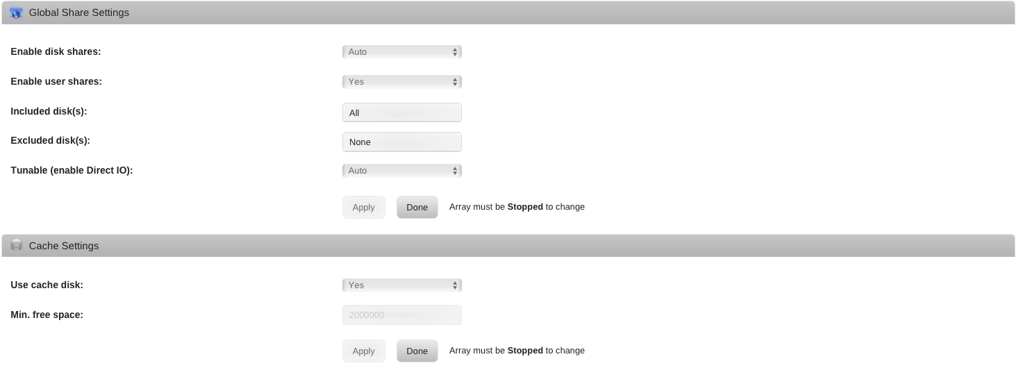

My install is older, so rather than give you steps I'll give you settings since the steps have changed.
My Global Share Settings Use Cache is set to Yes (and maybe I was wrong, and you should change that).
My setting for each user share is Use Cache Disk "No", except for the ones I want to use cache.
My setting for each user share that should use the cache disk is "yes" or "prefer".
A restart of the array is needed if you change the Global Share Settings.
Yup.  Looks like it needs to have "Yes" set in Global share settings.  Now changes I make to the shares themselves show up in the dirs on the cache.  And isos is there now.
Thanks!
If you turn on Help, you will see this for Global Share Settings - Cache Settings - Use cache disk:
If set to 'Yes' then User Shares can possibly make use of the Cache Disk. You still need to enable use of the Cache Disk on individual user shares.
So that would imply that setting it to No means no user shares can use cache. As far as I know it has always worked this way.

To answer the original question: Under Settings -> Docker -> Advanced View you can change the folder where it stores appdata and the docker img.  don't forget to move the files before restarting docker. FYI: You can also move the libvirt folder too. (Settings - VM Manager - Advanced View)
