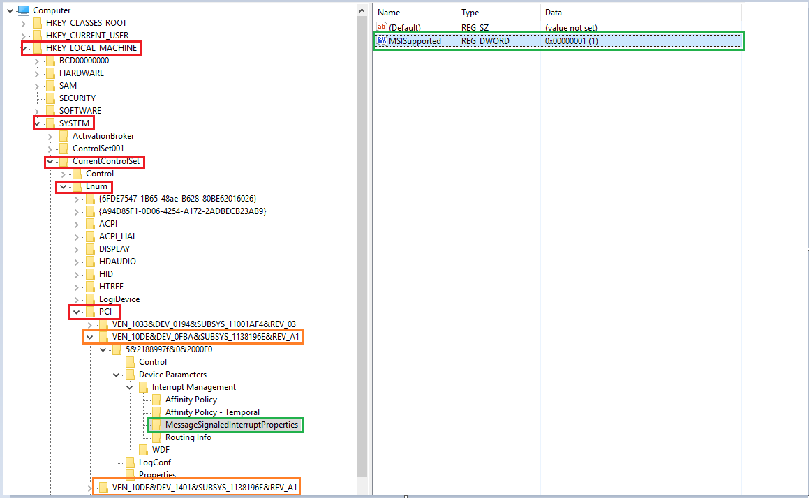

If you are using HDMI sound from your video card like I am, you may need to locate your video card within your registry and turn on MSI from 0 to 1. In my screenshot red box will be the path to my video card, orange is my video card, and green is the MSI I am setting from 0 to 1. That fixed my distorted sound\video when playing games or watching videos.

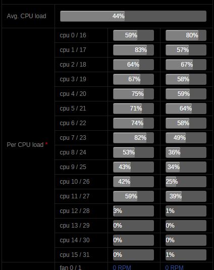

Will you get a screenshot of how UNRAID sees all your cores, something does not look right in your VM template. Here is my screenshot of what I am looking for when you have time.
Thanks Darkun,
Sure see below my CPU summary while my VM is off...
try putting your vm on cores 8-15, and make sure your topology in the xml don't try to make them hyper threaded pairs, but rather 8 cores. For some reason on my dual processor system, it doesn't like ht pairs, but rather prefers cores in straight numbers. It's counter to the advice in the cpu pinning thread, but experimentation is often better across disparate hardware.

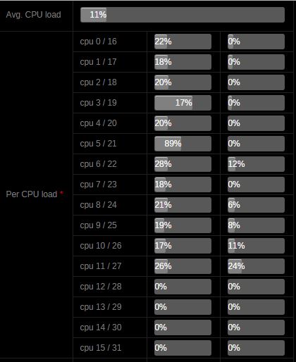

And also see below CPU usage with PC on and three transcodes running in tandem. I feel like it should be using way less processing power considering these are 2x Xeon e5-2670's...
Thanks in advance!
Thanks 1812, I'll try it without the HT pairs and see if that makes any difference.

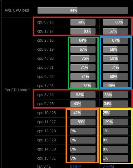

Looking at your screenshot and going off how I do my pinning but I don't have as many core's or dual CPU but I would try something like this and look at the screenshot I attached
isolcpus=2,3,4,5,6,7,10,11,12,13,14,15,18,19,20,21,22,23,26,27,28,29,30,31
Red = CPU for UNRAID
VM1 = Green  and add this to the VM template  <emulatorpin cpuset='0,1,16,17'/>
VM2 = Blue  and add this to the VM template  <emulatorpin cpuset='0,1,16,17'/>
VM3 = Orange and add this to the VM template  <emulatorpin cpuset='8,9,24,25'/>
VM4 = Yellow and add this to the VM template  <emulatorpin cpuset='8,9,24,25'/>
Also remember to enable the MSI for the audio in Windows if using GPU audio if you are still experiencing sounds and video play back issue. I have to enable mine to get it to work well and should be a registry edit.

MSI/HDMI issue probably isn't relevant as I'm passing through a seperate sound card and using DVI output on the GPU

Ok so an update on where I am currently:
Suggestion from Squid -
Installed cAdvisor but have no idea how to use it. Checked support thread but nothing was there  I could see. Any link to instructions?
http://lime-technology.com/forum/index.php?topic=50528.0
Load up the web ui then click on plex and watch what the cores do during a transcode
Sent from my LG-D852 using Tapatalk
